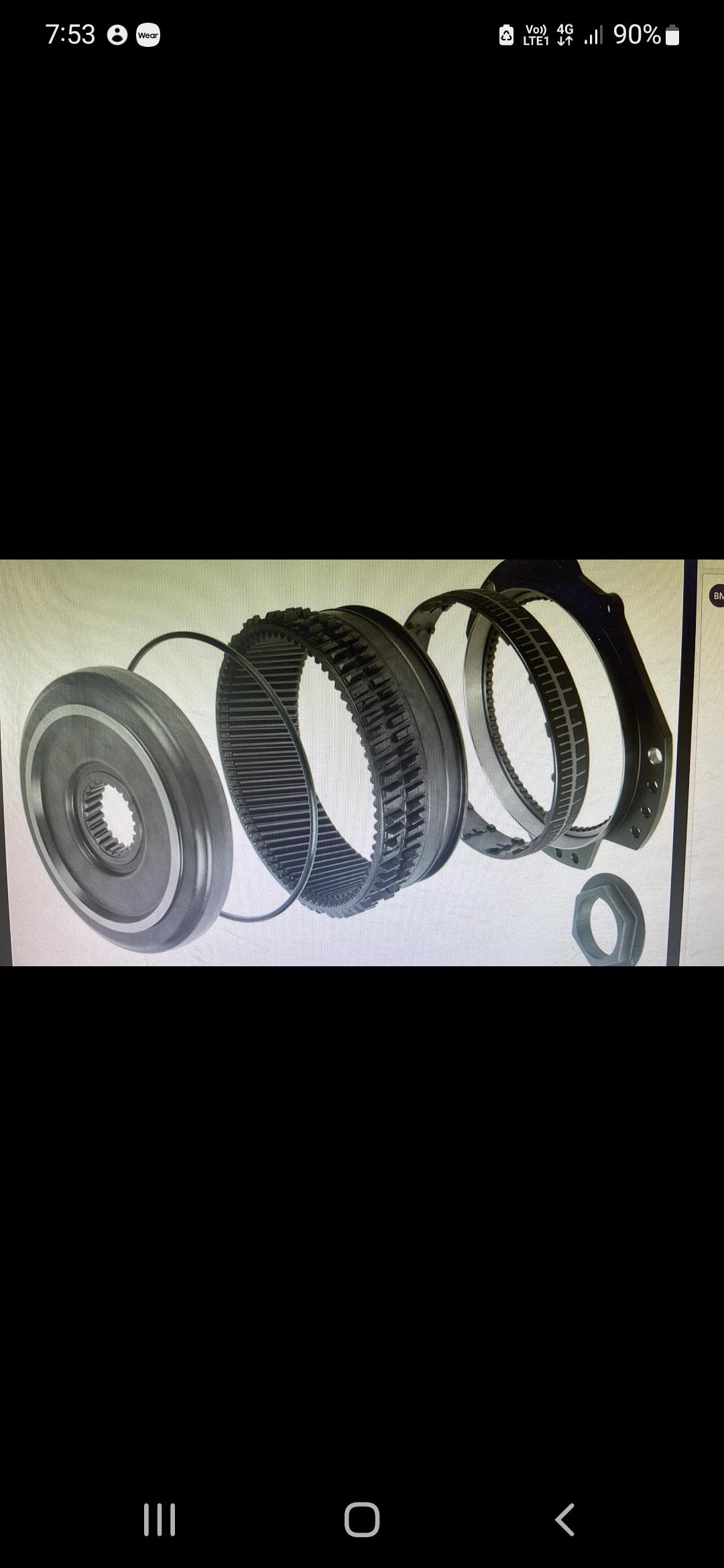

Here’s the rear synchro housing kit with hub .
Seems like in Australia u cant get this kit. I can get the range synchro kit which includes whats in the photo would i need change anything else while im in there
