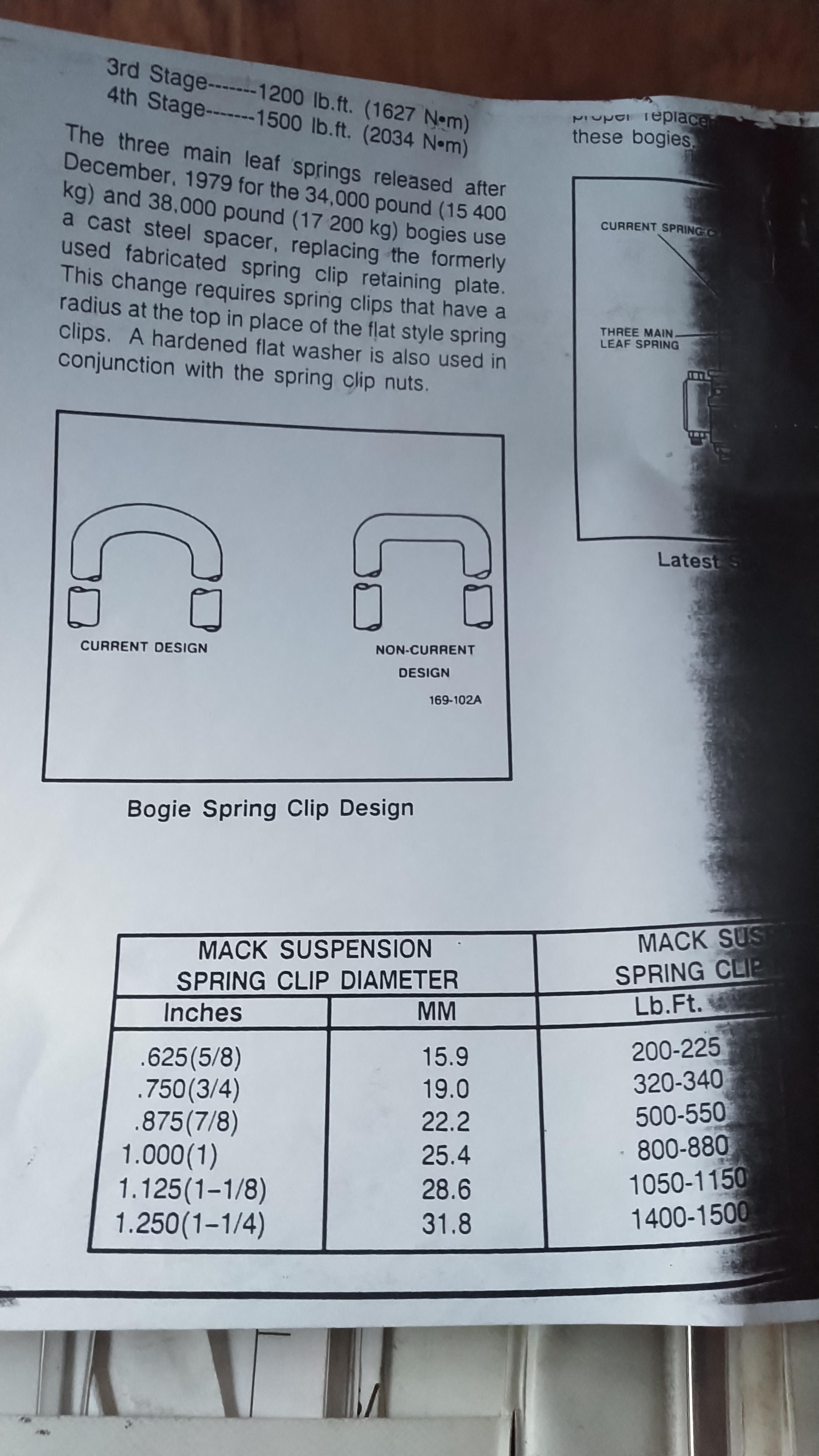

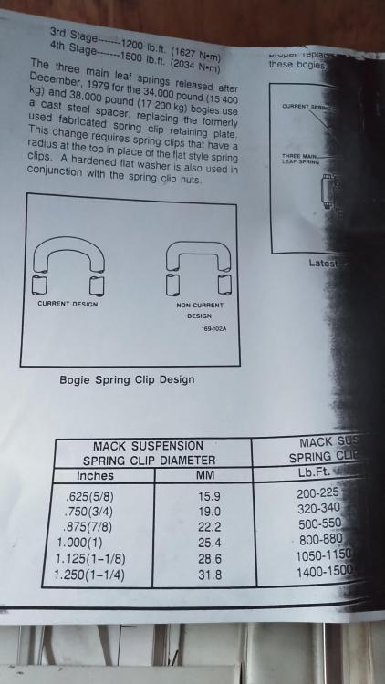

Get to know the torque value for the size of the u-bolts you have....  then figure out how to get that torque..  1300+ lbft is not out of the realm of possibility..  jojo
