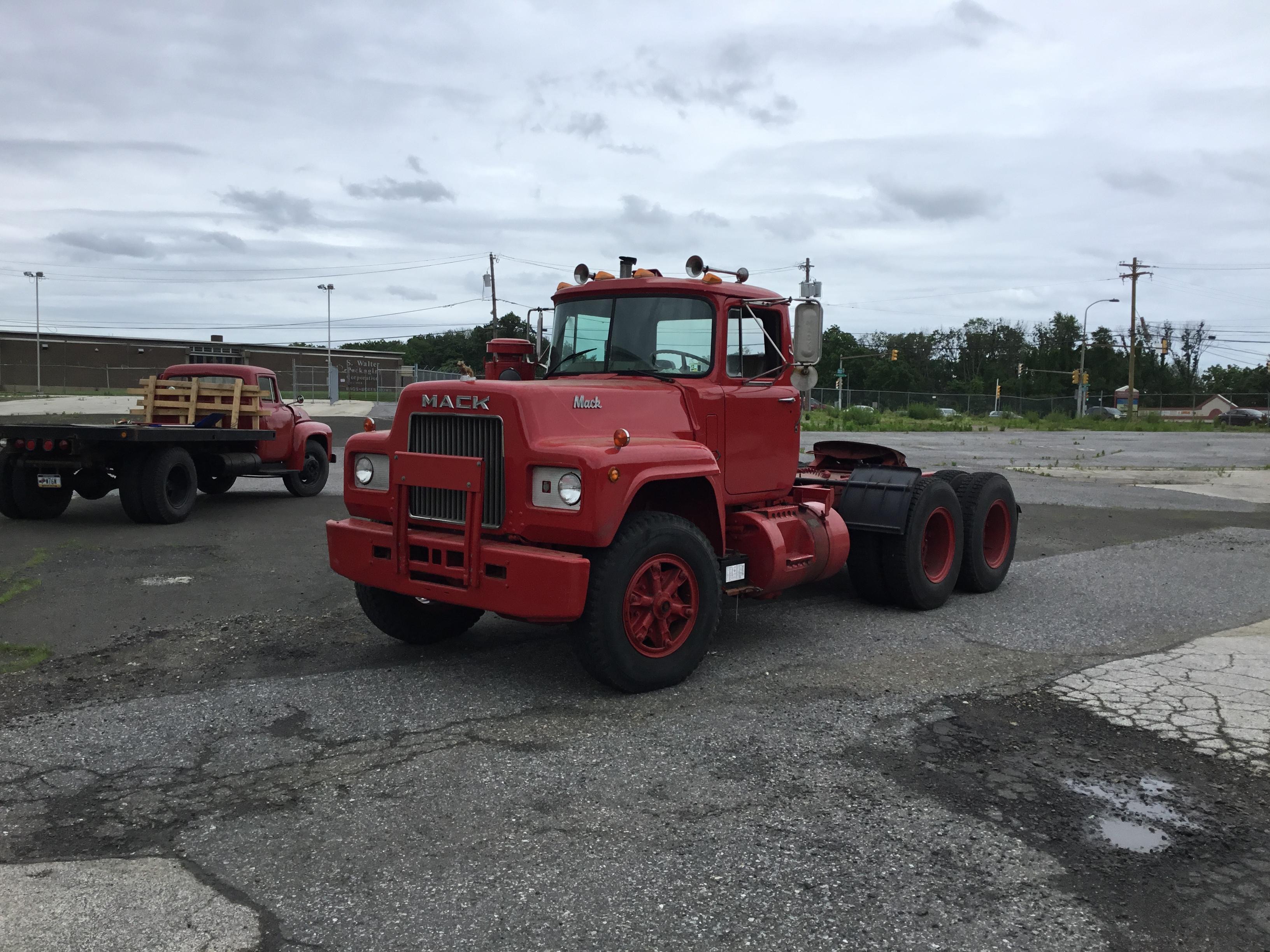

I’m looking to replace my tires on my 79 r model it has 1100-22’s on it now. Can’t find this size anywhere so what are my options.I guess I should be asking what,is the new size I should be looking for?The truck has spokes on it.

What a nice looking R model

You’ll have to get new rims,tubeless 24.5 and u can go with 11 or 12R24.5 tires
Just to reiterate what has already been said...
Tube Type 20" and Tubeless 22.5" fit the same (small) spider.
Tube Type 22" and Tubeless 24.5" fit the same (large) spider.
