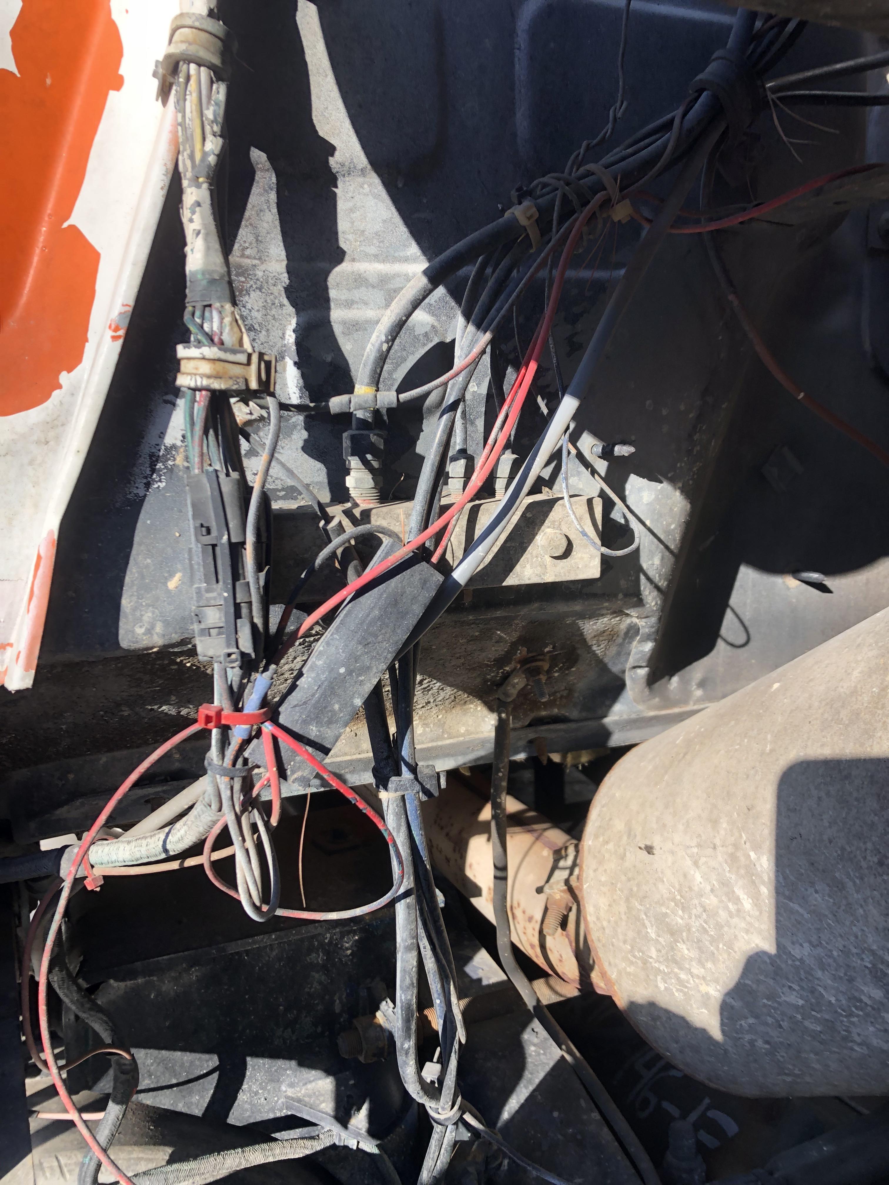

correct me if I'm wrong ;; isn't the alum fire wall  block just an air manifold .individual ports. flip dash switch  see/ hear what happens.  possibly some thing was disconnected or by passed.  manifold must help in chassis building  when new, full groom cab = chassis functions plumb in to lower ports?
Traced it. Two smaller lines on manifold go to the dash air switch. 3/8" air line from top of manifold goes to side port on tractor protection valve. There is also an electrical switch where this line attaches, but the wires have been disconnected.Bottom 3/8" air line from manifold goes to maxis. Switch does nothing, so you are right GNDN. They pulled air from that manifold to the switch at one time to operate whatever when it had a fifth wheel way back.

that makes sense. the toggle switch went to air slave cyl on 5th wheel .  cut off wires went to dash WITH INDICATOR light or buzzer letting operator know 5th wheel not locked. wheel change over to manual or just put in one spot and left. disconnected air /electric . THANK YOU  for follow up info
