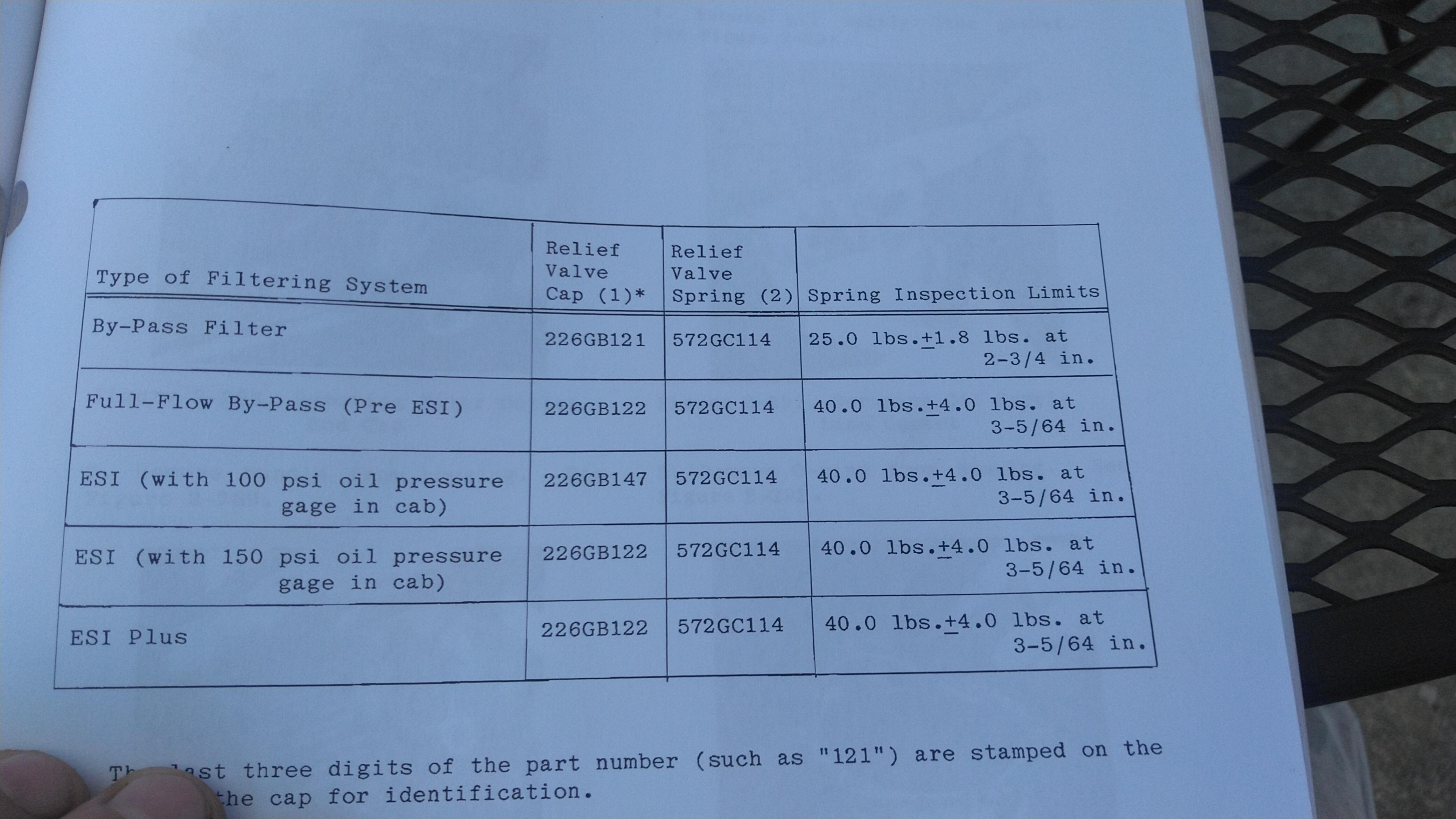

Anyone know of a parts supplier that might still have on oil PSI regulator spring?  Called Watts and no luck. Was able to get a part #   572GC110.
Have the Mack specs on this spring, so if I can't find a new one I'll check it and shim to the correct height and poundage.
https://www.bigmacktrucks.com/topic/72756-end-673-oil-psi-regulator-spring/

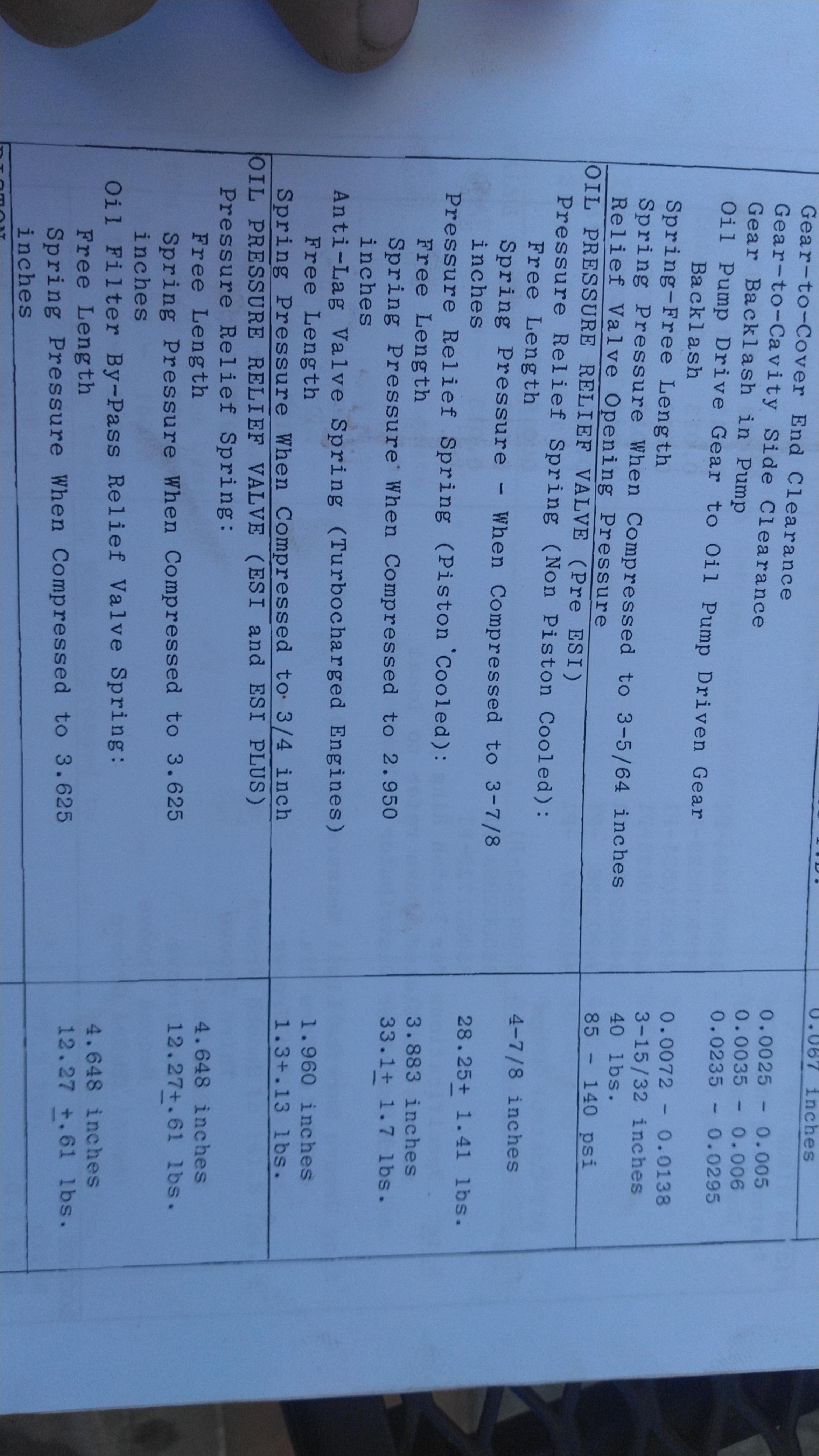

I dont know the reason for replacing the spring(s)..  , so I thought I would post some specs from my E-6,, 2 valve book..  It shows the compressed spring pressure and measurements..  I used this a couple years ago, when I was inspecting an oil pump for re-use..                    Jojo
Sorry about the crooked picture..
