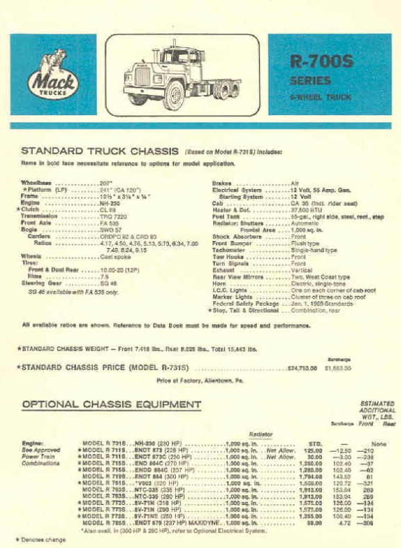

Lots of engine options.  See the brochure below.  Think this was about 1972.  There are Mack (864) and Cummins (903) V-8s listed there.
