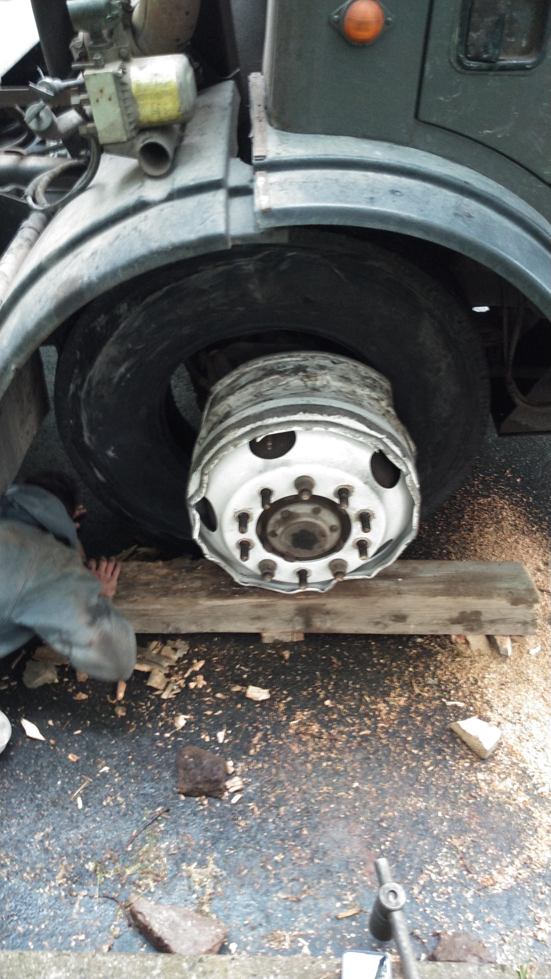

This was the start to our Thursday... My cousin was driving when this happened.  Brand New tires on brand new rims, second day on the truck.  Tire tech put on 8.25"rims, but the counter man ordered them to have 9" rims: 7,500 lb rims vs 10,000 lb rims. Fortunately it failed at 5mph not 50... Shop replaced junk tire and both rims with the right rims that afternoon.
I had to make a second trip to the shop to get the torch as the rim bent itself around the backside of the brake drum. When we got it back to the shop and got the other wheel off it was already buckling and had flat spots developing on the inside bead.
The tire is still on the axle. Apart from a little damage to the bead surface it held up well...
