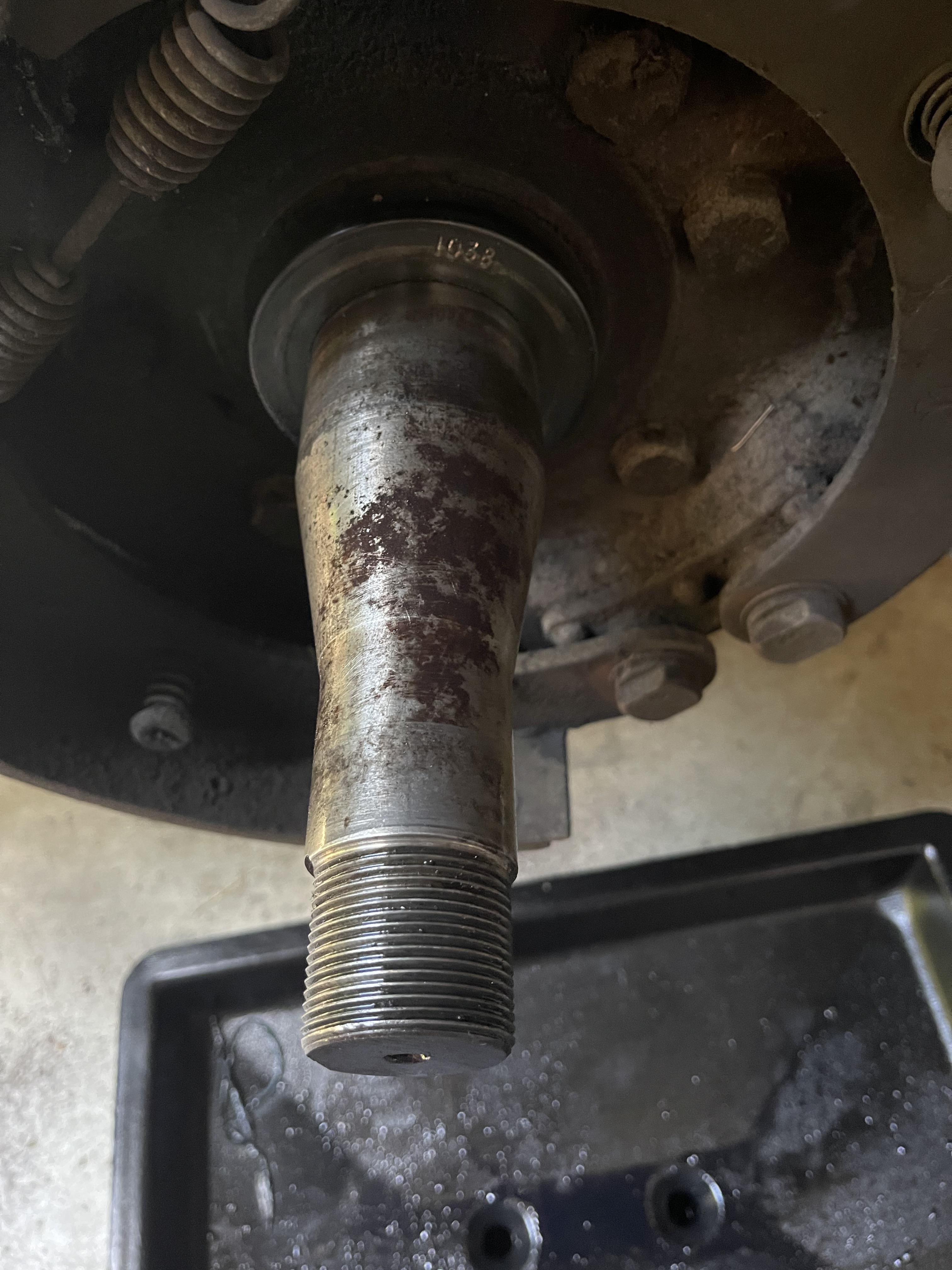

what if you can simply slide a new wear ring onto the spindle with no tools required? It’s a tight fit but goes on easy. Picture of old ring in question
you can,,,  just be sure to not warp it and it needs to be flush with the leading edge of the spindles seal area, or it will leak, also when you are sure about how you are goining to install the seal, put a light bead of RTV on the leading edge of the spilndle and once it's seated wipe off the excess RTV..  should be just fine after that..

that whole 1038 piece comes off ! comes with the new seal I believe!
Expand
It does and it has an o-ring behind it. I was confusing the wear ring with the 1038 piece. I know better now.lol. The 1038 comes with a corresponding stem o seal but I’m curious if any one piece seal will work with the 1038 piece.
