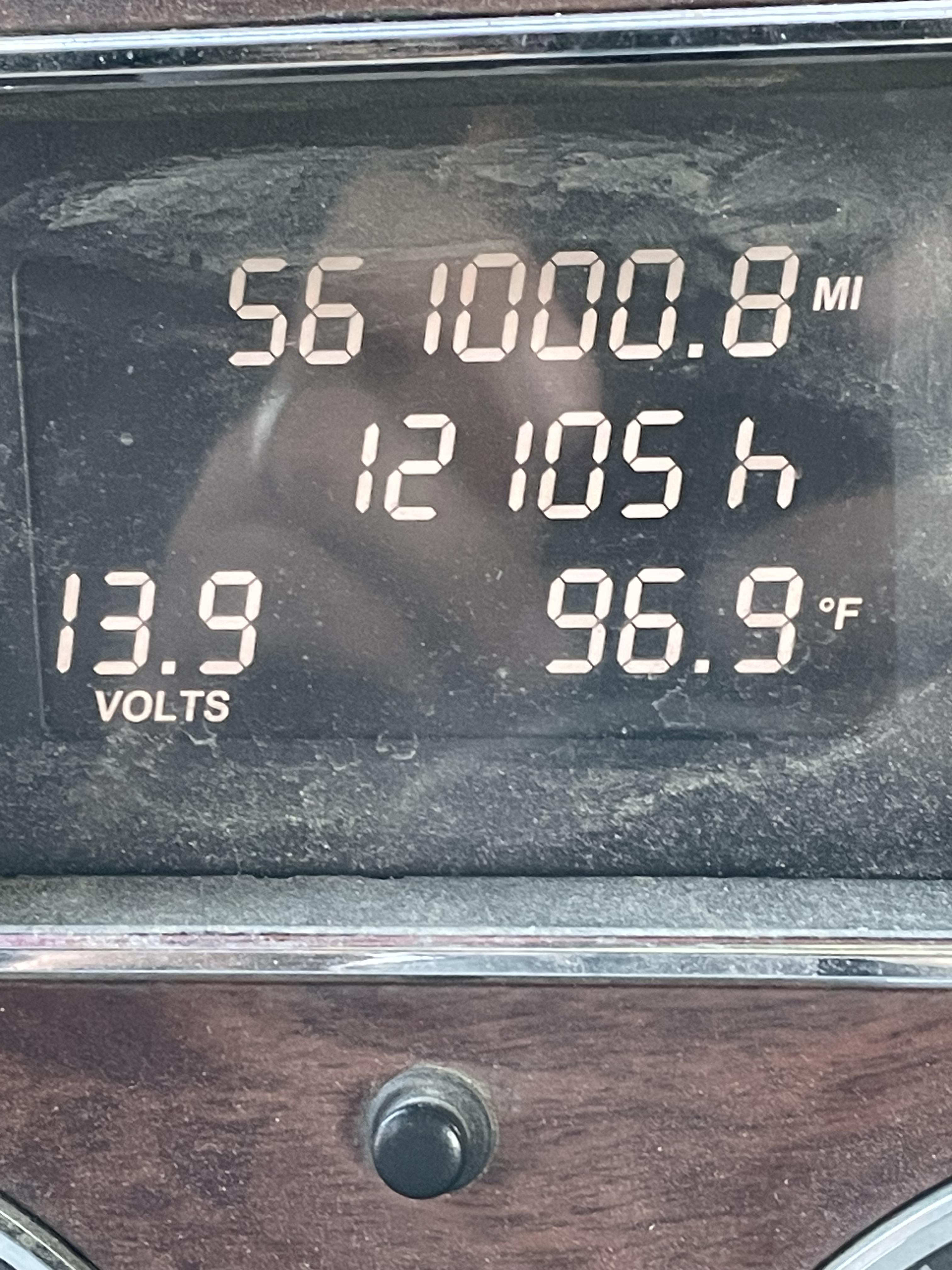

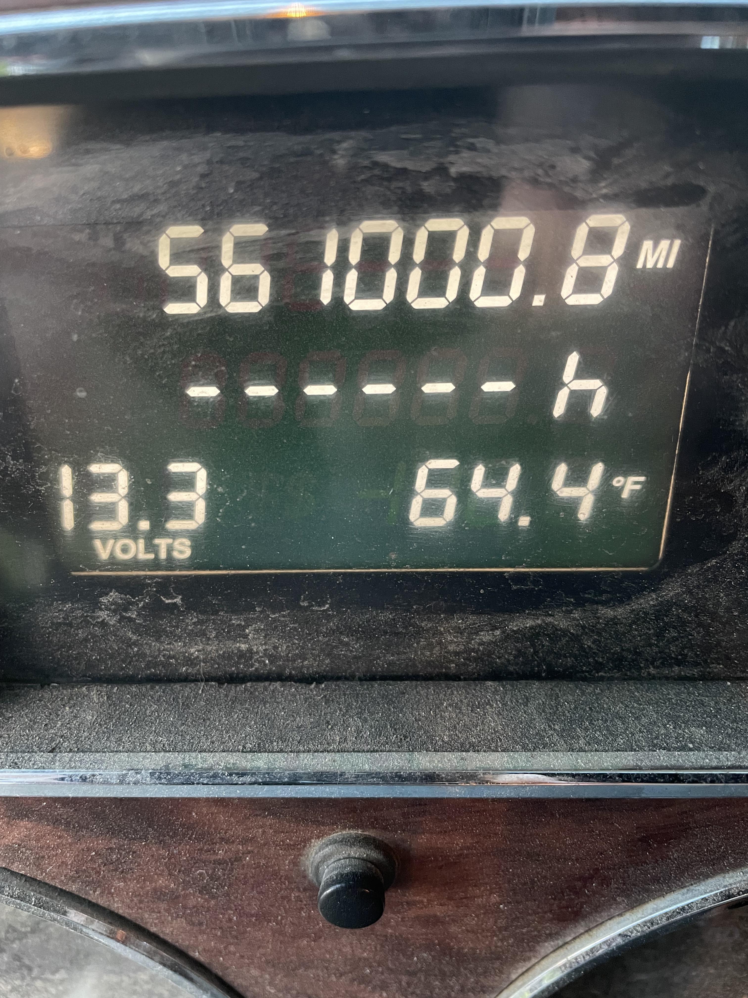

My ctp713 been shutting off at idle and while going down the road. Cranks up everytime after key is reset only if hours are showing. I noticed today it kept going backwards everytime it stalled out so I worked 12 hours but only showed I ran it like 5 hours. Sometimes it stalls out 8 times sometimes 1 or twice in a day some days none. But now it’s getting everyday. Any help is appreciated. It did it 2 years ago and stopped and has slowly started back. Nobody knows what it could be. Engine harness replaced and engine brake valve

Yes right under cb and above radio. Also one above the steering wheel adjuster foot pedal. So today it shut off 2x and ran 10 hours without cutting off. But I noticed hours were reading 12104 at 6am this morning then at 4pm it was reading like 12113 hours and like 30 minutes before it cut off it went back to 12104 after running 10 hours

Ok I check cluster and grounds. Didn’t see anything broken, I unplugged computer plugs with key turned on. I heard something sound like it spooled or turned like resetting when I plugged them back in. then got back in cab looked at hours and they were not blank and it fired right up no problem 🤔. I’m no mechanic but I’m thinking messed up harness or bad computer?????
Run it and if it happens again, try that same truck to see if it fixes it again..  the mother board in the cluster can fail..  You can get one through Volvo, and they will flash it for you based on the VIN.  Well, I had them done like that several years ago,  hopefully the same way today..
So it ran 30 minutes stalled out fired back up without unhooking computer. But immediately cut off but then fired back up ran an hour and half stalled out had to un hook computer to fire it up then cut off 2 more times now I’m home it’s been running in the yard for about an hour no stalling 🤷🏻‍♂️ . When I unhooked computer I hear something spin or like reset then it will fire up. So I should reflash the cluster or just try and find another computer?
