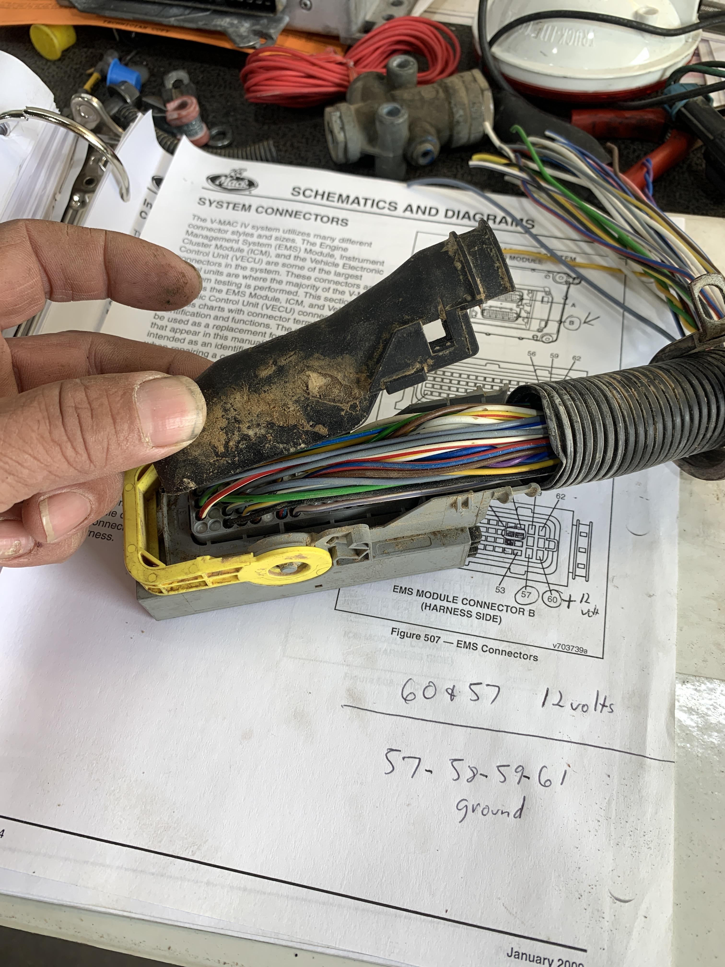

I’ll try to get a pic of the problem connector. It’s under the hood around the foot valve area .

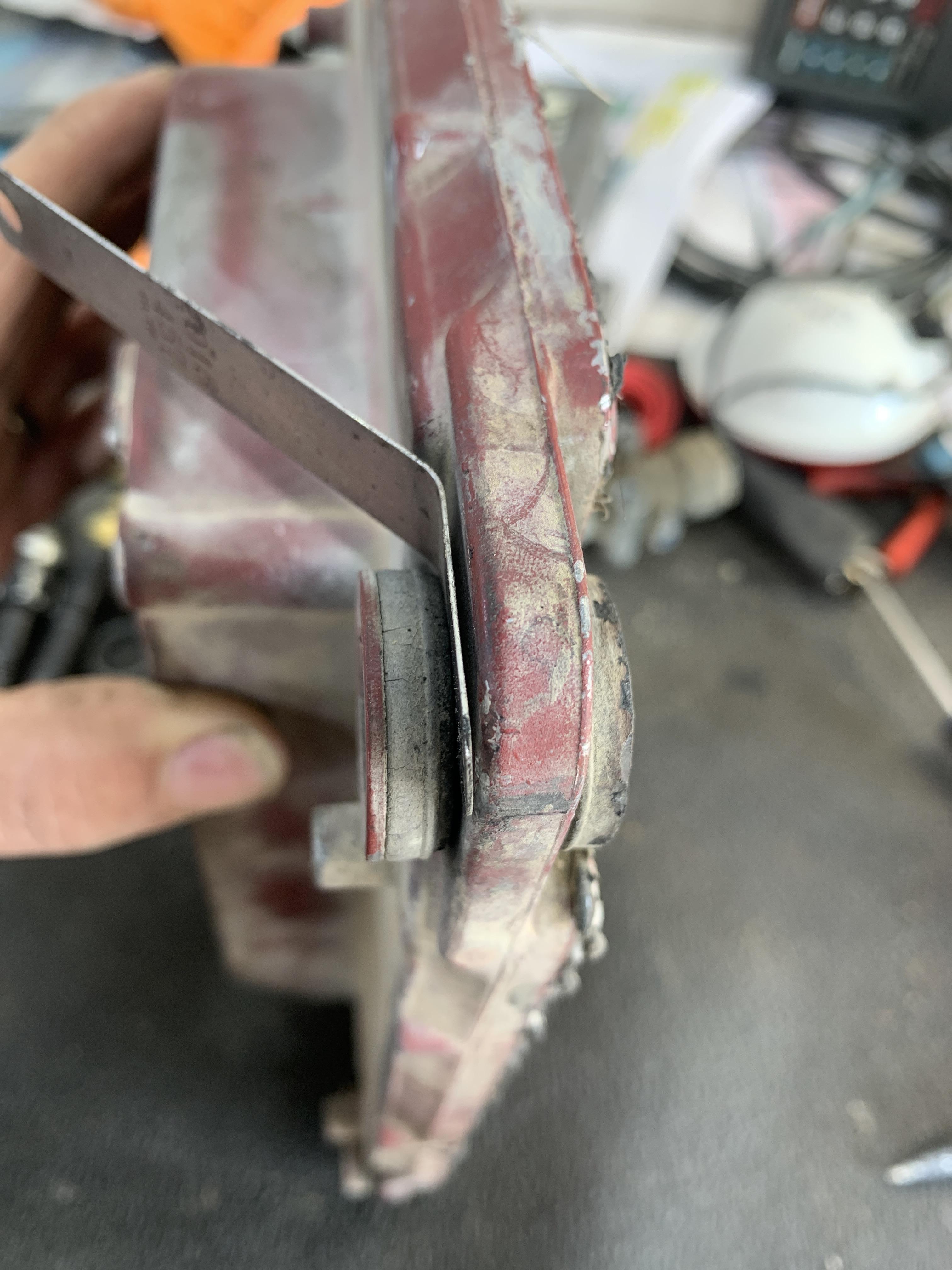

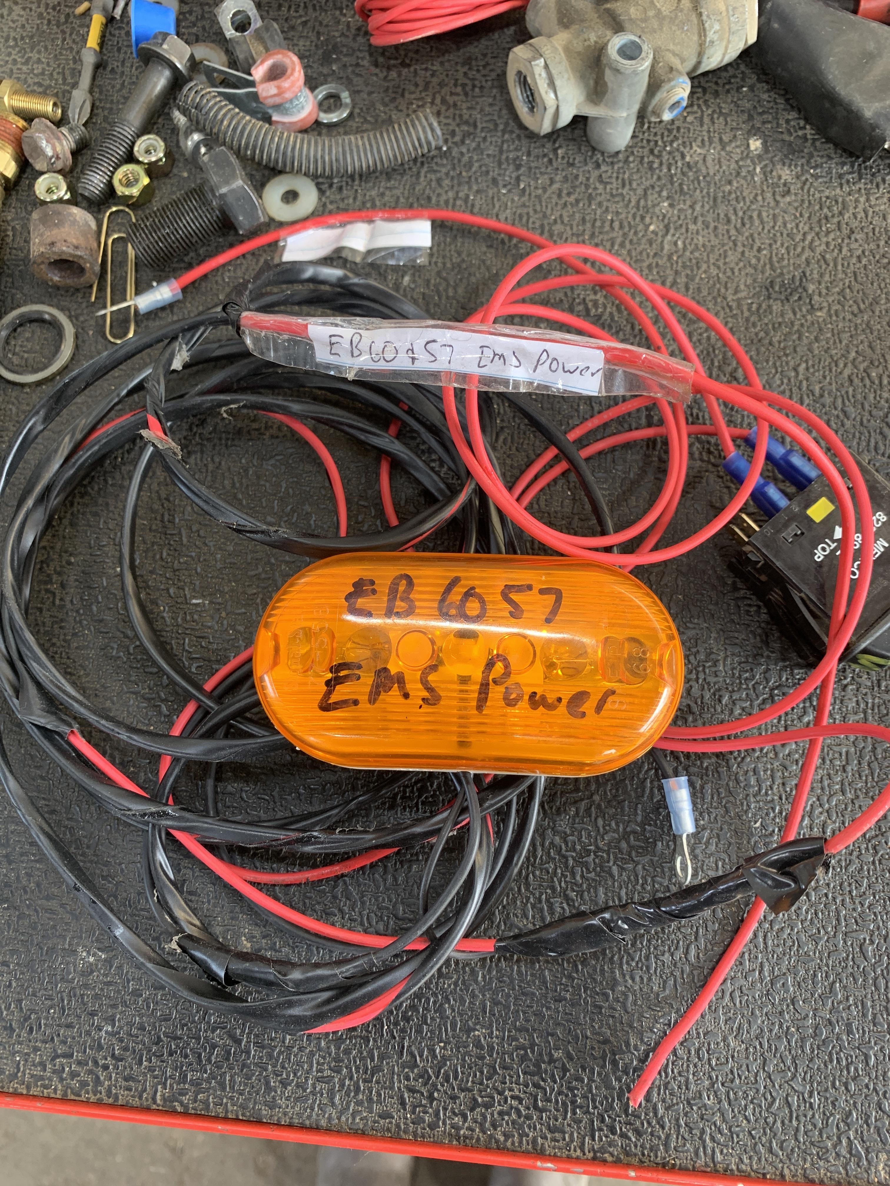

I even found my harness I made up to test it. What I have found is the rubber insulation grommets that the ecm bolts go through seem to shrink over time and this causes the ecm to vibrate/shake and causes the ecm to fail.
