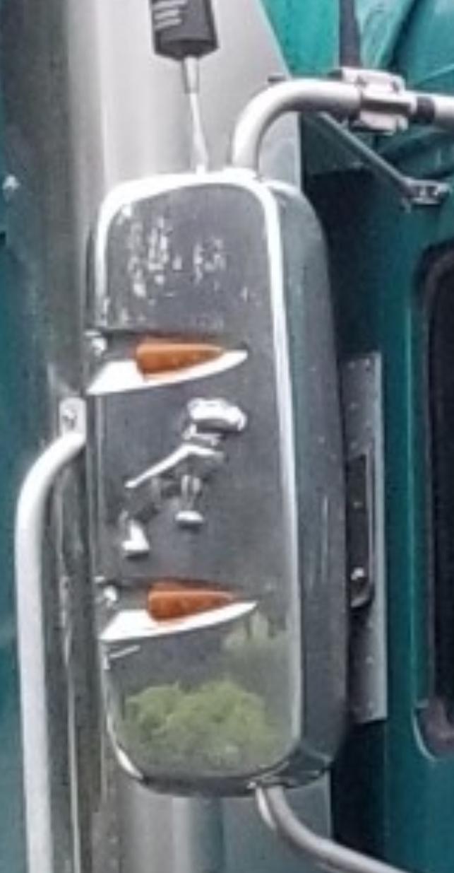

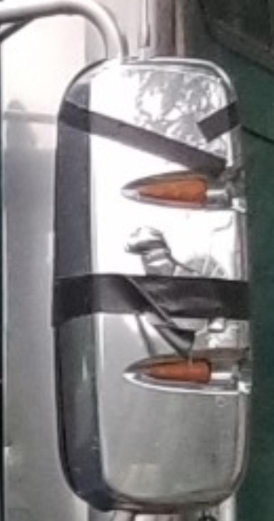

So this Mack I'm getting to know pretty well. It's getting completely rebuilt, one part at a time. The question I have is, the mechanic said the oil level/temperature sensor is bad. No matter what dealer i call, or site I look on, all I get is the oil pressure sensor, the one in the pan they say doesn't fit this truck. Maybe it doesn't? Can anyone verify the VIN on this truck? I'd also love a source on the mirrors this truck has, I believe it's the Rawhide edition. Next to impossible to find. The VIN # 1M1AN07Y69N004426 and it's a 2009 Mack CHU613 I'd like to thank everyone in advance, this forum has helped so much already to keep this truck rolling. Screenshot_20230522_152014_Messages.thumb.jpg.e85ede75b4203c6fbcab31e688418e95.jpgScreenshot_20230522_151941_Messages.thumb.jpg.24590589581fad4d38f09bc802ad74b0.jpg
