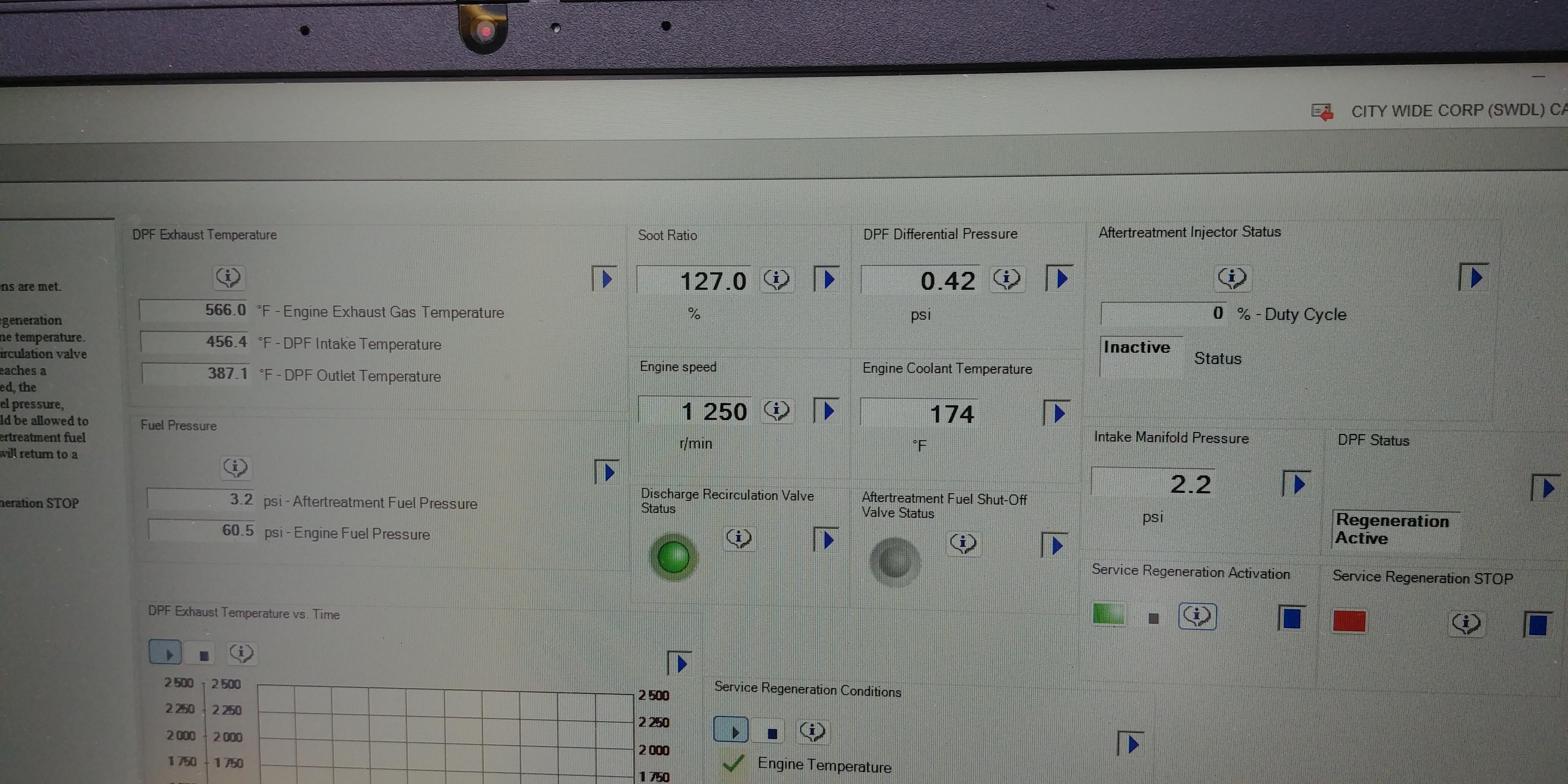

Good Morning, I have some pics available of a regen is ran, i will send them one at a time with an explanation of what stage I was at and observations I have made. Here is the first picture, this is when I started bringing the truck up to operating temp without starting the regen
