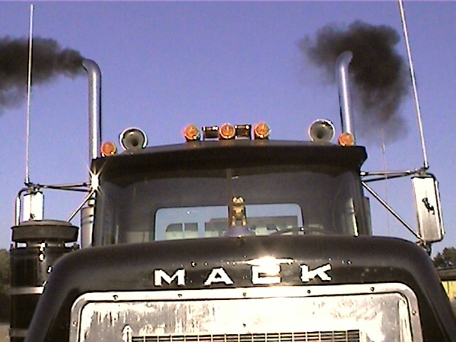

Besides fresh oil in the old girl looks like sludge after 2000 miles anyways
It wouldn't be that bad If someone wasn't playing with the fuel screw :D
