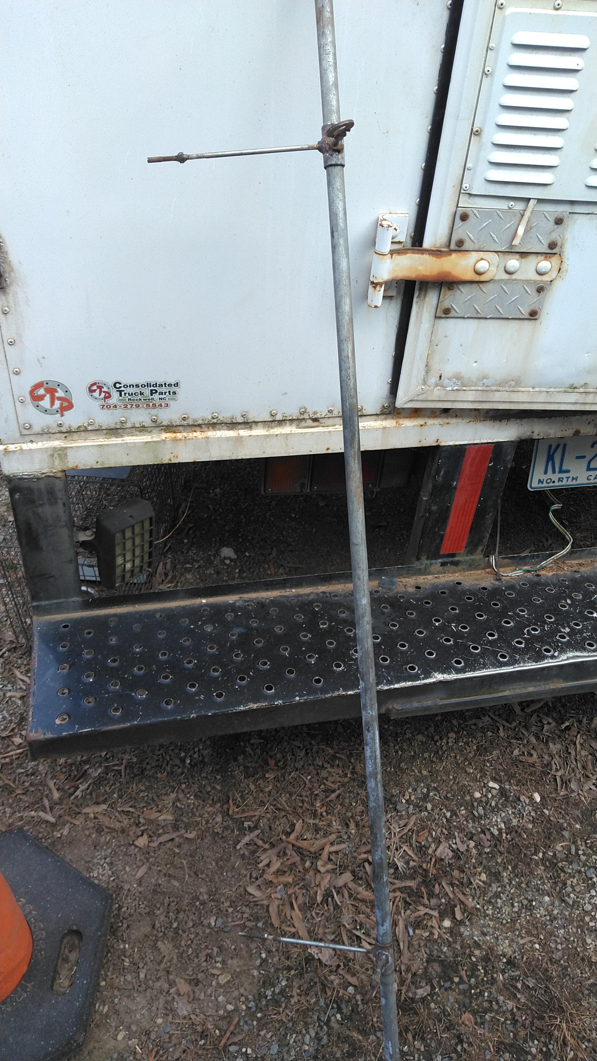

Here is a tool I made about 10 years or so, ago..  I needed to diagnose tire wear on a truck that was in a minor wreck.  I made this tool to measure the distance between the drive axles to see how far off they were..  Its ugly, but it works and I will still use it today if needed..  I basically made 2 sliding pointers with clamp bolts, and slipped them over some wire conduit..  i sharpened the tips of the pointers so they would fit good into the dimples on the axle flanges..
