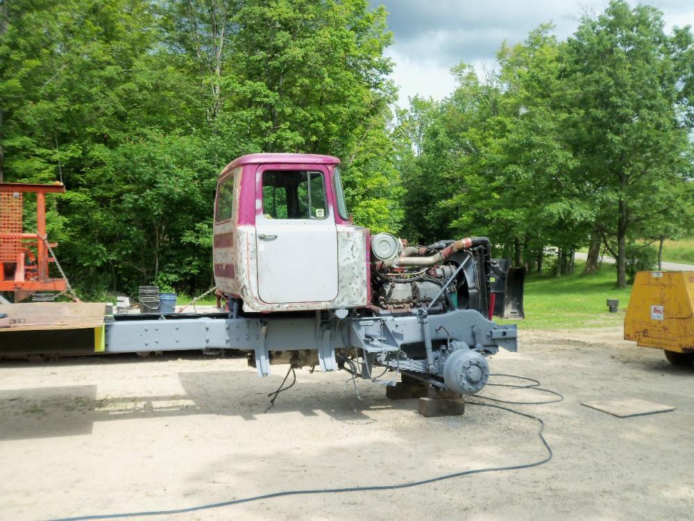

This picture was posted by someone on here a long while back. The rear portion is steel not alu in this case but you can clearly see the split.
Thanks Vlad, very detailed explanation
