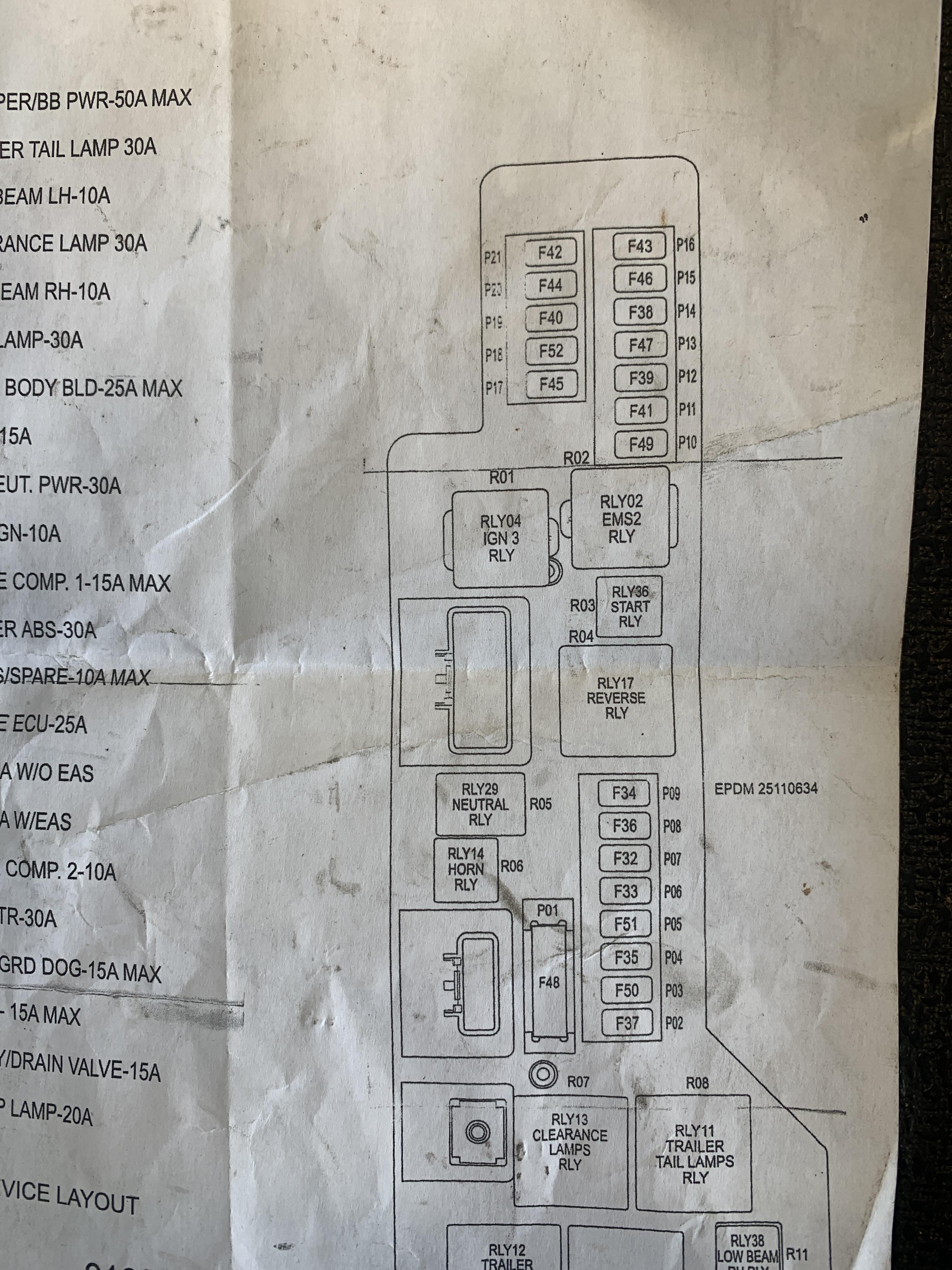

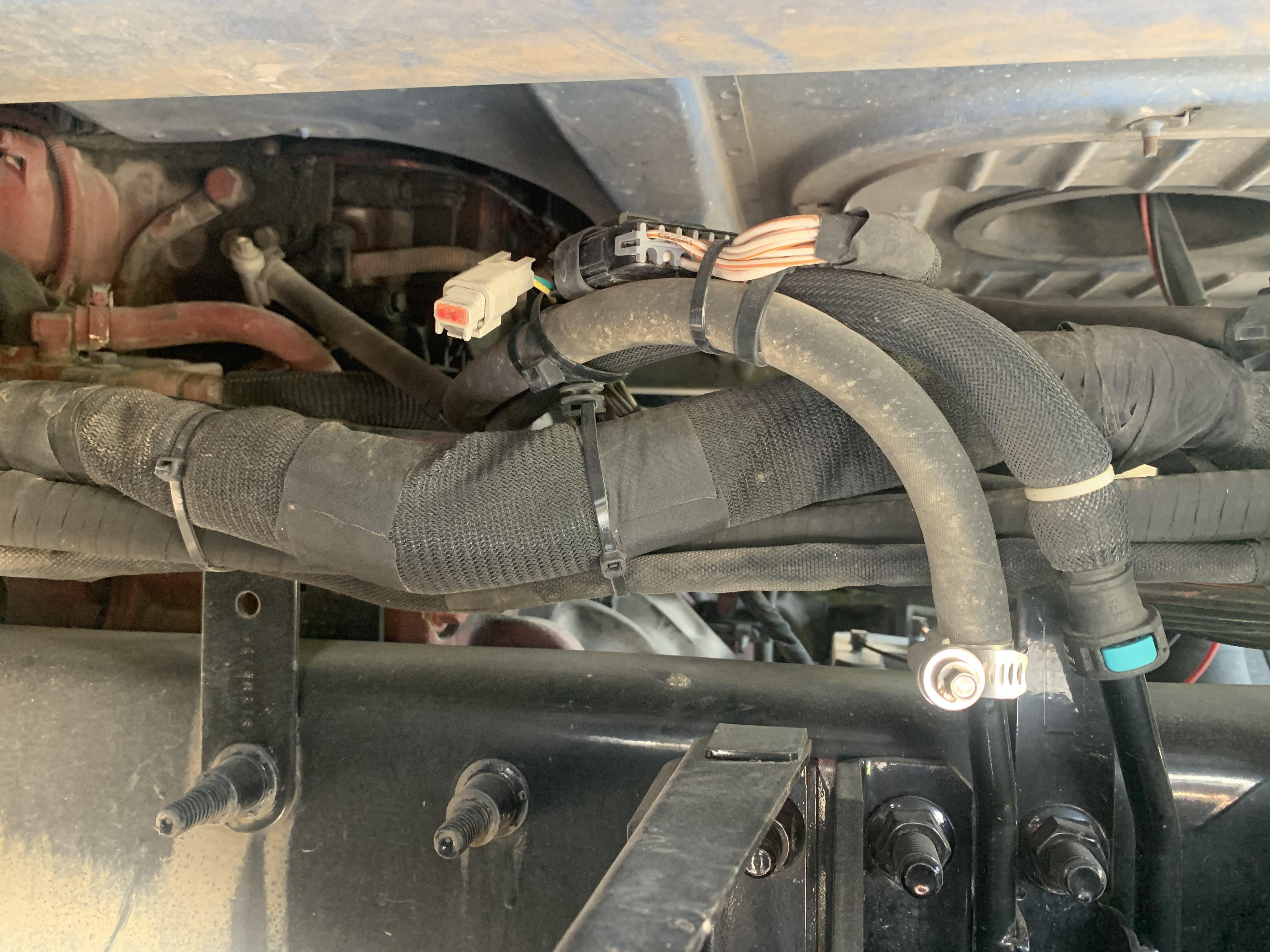

It’s a separate harness that plugs into the chassis harness on top of driver side frame rail. I’ll see if I can get  some pics in the morning. I’m thinking the Allison harness is separate and goes directly through the firewall with it’s own harness.
Edited by Mackpro
As far as Corporate helping dealers with issues like this ( change overs as they call them) it’s non-existing. They will set up the data files and if you lucky they will give the dealerships a Vin of a very similar truck as yours but with a manual transmission. Then it’s up to the dealership to go through each page of the parts look up and compare what’s different, from fuses, breakers , relays and harnesses. Been through similar situations with them years ago. They don’t make a parts list or how-to on things like this.
Thanks, Mackpro. This info is very helpful, it gives me a baseline for discussion when I talk to the techs today. I thought my local dealership guys knew their way around their machinery since that's all they do; and not to mention their healthy hourly rates. I thought the physical swap which I did in my yard was going to be the hardest part; well?
I'll appreciate any pictures you can send so that I can show it to them.
