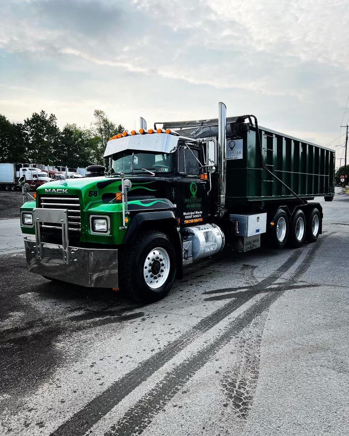

I have a new to me Mack RD with a 350 horse E7 mechanical engine. Don't have much history on this engine as to what was done on it, repairs, etc. We had leaking injector lines for #4 and #6 cylinders as the truck currently has the crappy cheap Mack injector lines and the fittings flattened out causing a leak. I replaced #4 and #6 lines with PAI lines (the double nut style). After doing #4 line, all is good. After I did #6 line, the truck has a haze to it when idling and blows a bit of grayish white smoke.
When you crack the #6 injector line, the smoke stops. The weird part is it didn't do this before I replaced the line. Could the line somehow be causing this, or do you think it might be an injector hanging open? Any other potential causes?
Checked for blowby, truck has zero. Any ideas?
