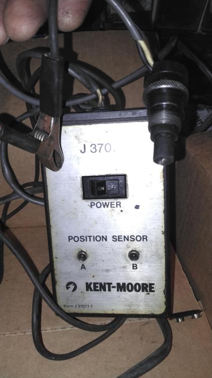

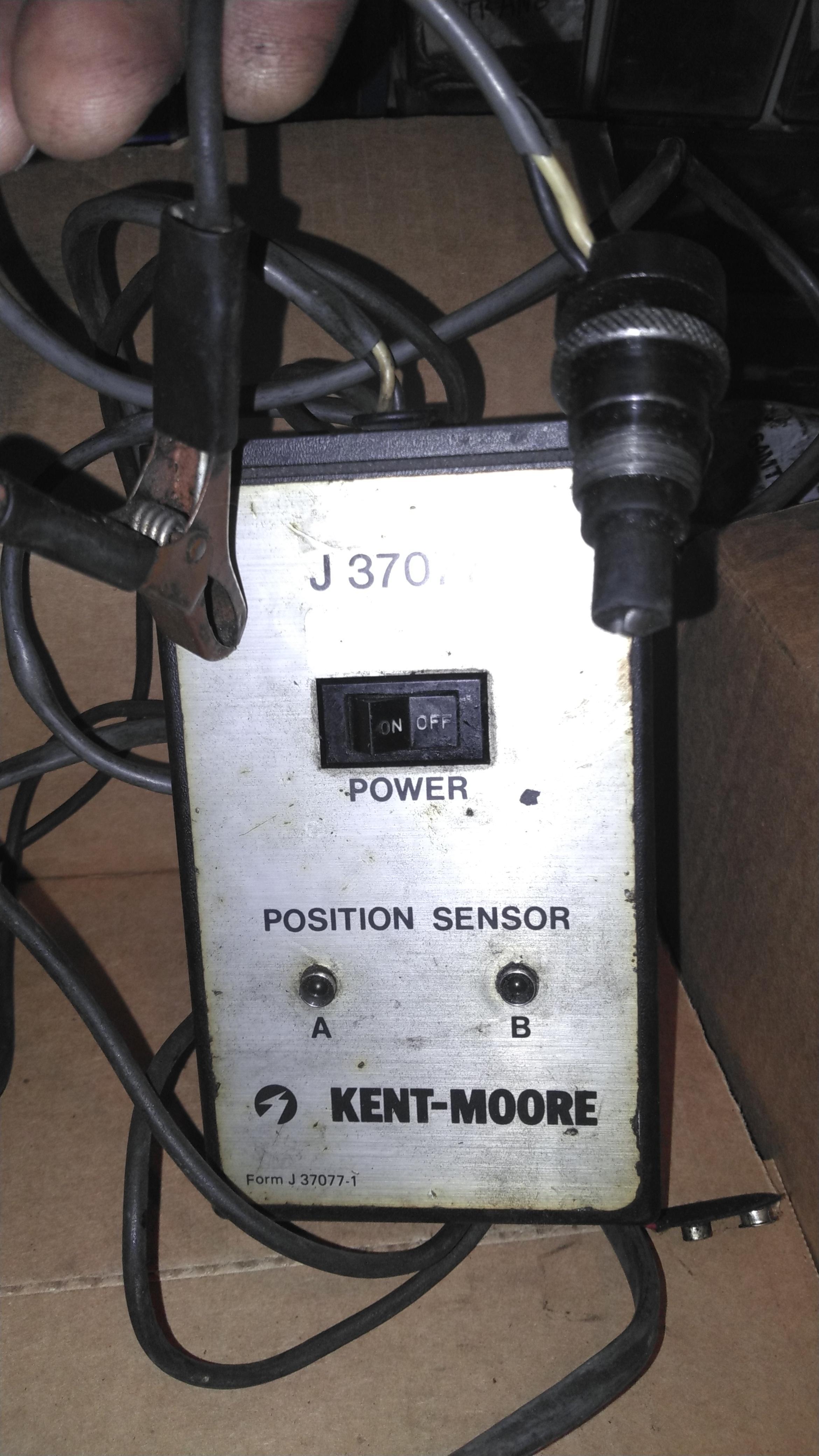

Proper pump  timing is crucial for best performance. Using a Kent Moore A-B light , set the pump timing 1 degree higher than what the tag on the valve cover . Never more than 1.5 degrees or overheating will probably happen. We rarely ever messed with the pump .  Good injectors, turbo, valves adjusted correctly, throttle linkage and kill cable adjusted correctly and the pump timing bumped up usually made a big improvement in power.
