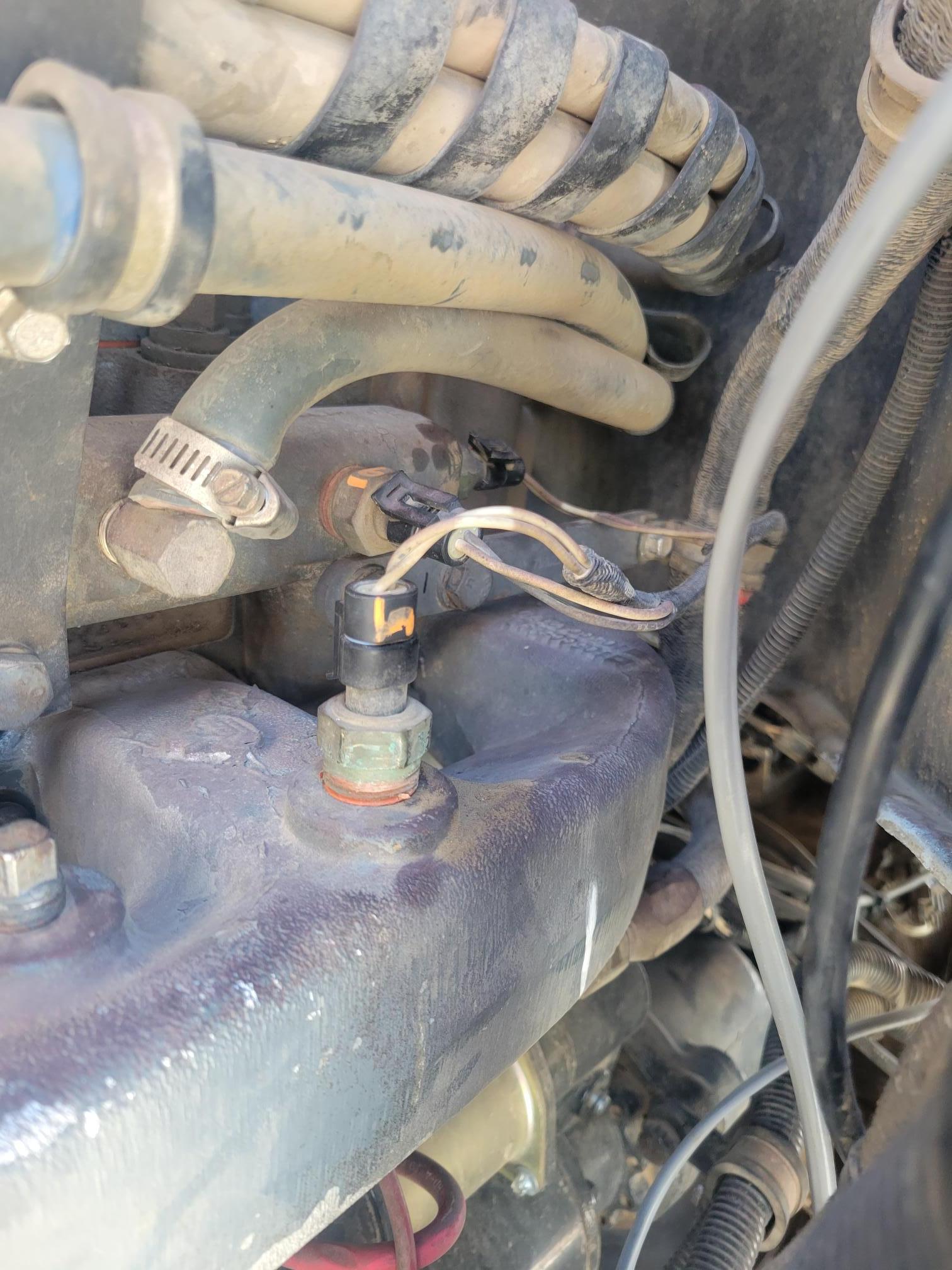

 I don't see anything like that on this one. I Have seen it before on older models, however this has electric wires going into the pump, no lines leaving the intake Manifold besides the air compressor air supply line. The only sensor is a two wire intake air temp sensor. I found a new pipe plug in a port that made me think he missed the sensor when rebuilding it. Some info on the truck Vin 1M2AA13YXSW058895. 1995 E7 -350hp engine ser# 5F2052. 20230717_133317.thumb.jpg.3f24d6ed0b8333fb83b44fce23d703c4.jpg
https://www.bigmacktrucks.com/topic/73048-e7-low-power-help/#findComment-535077
nope.. you dont have it, i think what you have is econovance, and my knowledge on this is weak..  Sorry, I guess you have an electric plug on the injection pump..

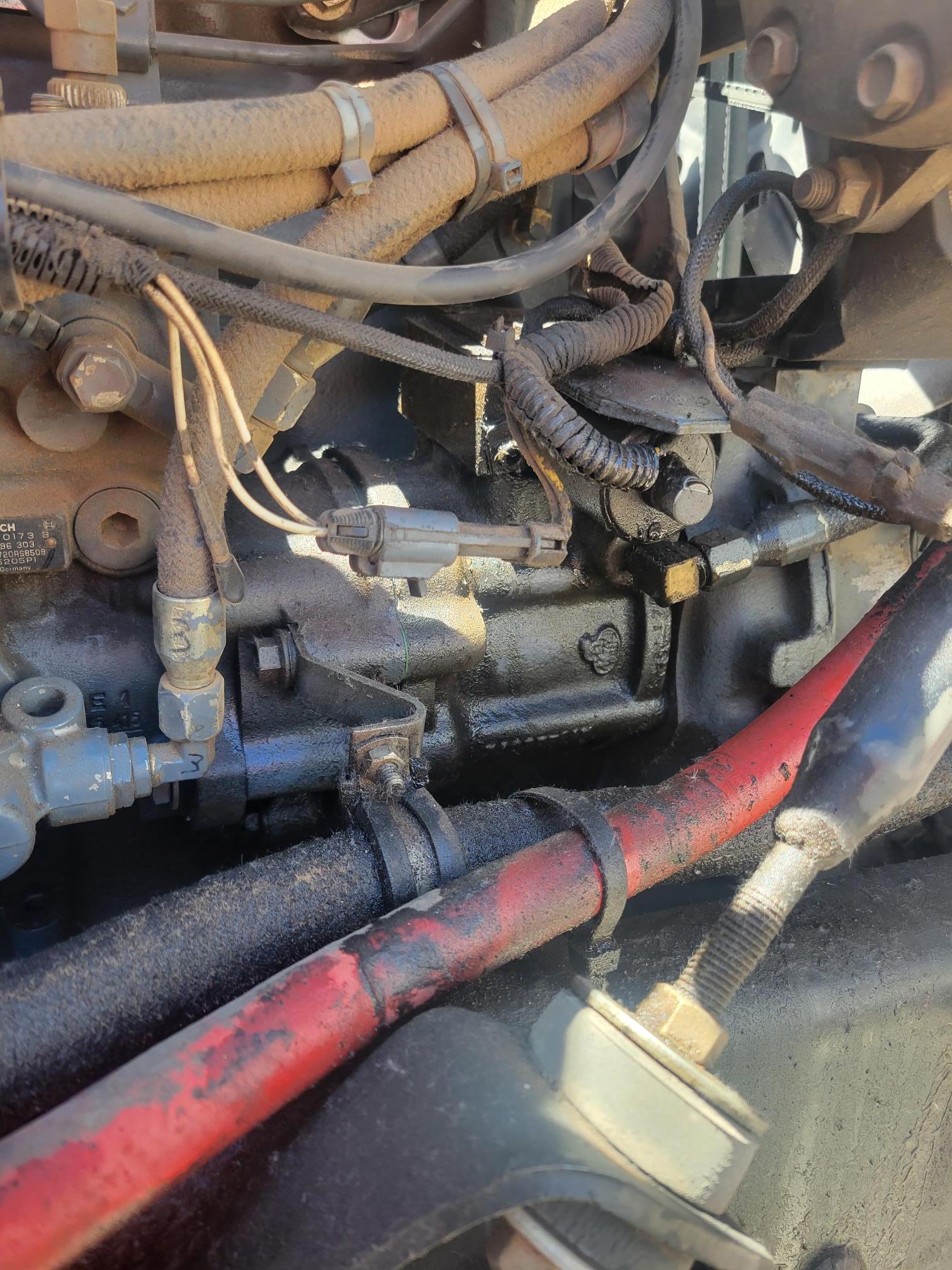

We will have a bay open soon so I can run the valve lash finally lol. I will check the plug with some back prob pins also. The timing advance solenoid has oil dripping from it. Would the ECM throw a code for Timing not changing? I guess I can put a timing light on it and watch what it does on the RPM curve.
https://www.bigmacktrucks.com/topic/73048-e7-low-power-help/#findComment-535082
it is a simple ECM..  back probes are not needed, just unplug it and look...  check the condition of the wires on the back of both plugs looking for cracked insulation and frayed wires..  is the holder for the plug still mounted on the inj. pump?  it needs to be there..

Well I eating some humble pie this morning I made a mistake yesterday my dial indicator was hitting the Jake housing so I got a false reading. Its hard to see the timing marks and watch the indicator at the same time.  So the cam Timing is correct at 27 deg's Mack dealer said the cam part # is a 454605142. According to the chart its on the money. This one has me stumped we crossed off intake leaks, exhaust restrictions, Turbo, valve lash, camshaft timing, injection pump Timing, and fuel psi. Even if they installed the wrong cam I don't believe it would be this low on hp. Its a complete dog! I looked at the injection pump rack Travel, it does not hang if I start it with out the computer controlling it will defiantly put the fuel to her. So it has the ability to run well. I don't understand why I can't find the intake psi sensor? Mack dealer said its sensor 20705960 boost/temp sensor. I am confused it is only a two wire sensor how can it have two circuits with only two wires? If I unplug it I get a active code for intake air temp. Nothing for boost.

No I understand the importance of the valve adjustment. I apricate the help any Idea on the temp/boost sensor? Why would Mack and Pai list it as a dual sensor? I am lost on how this works only using two wires. When I ohm the sensor it has continuity between the two post, and it changes with temp. part # 20705960. Does anyone have a ecm wire diagram for the engine sensors?
