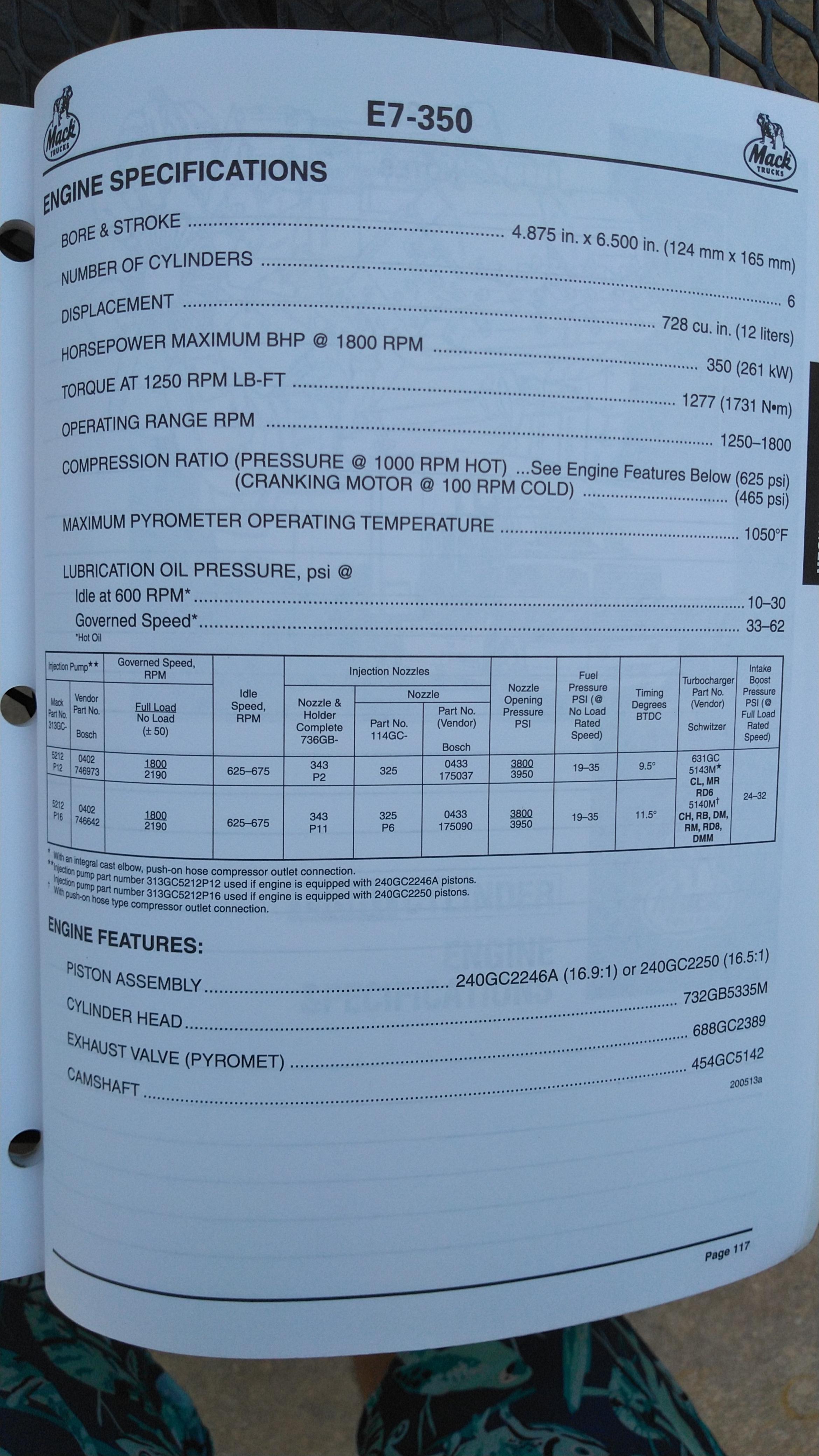

Original Cam and Cam gear was used with the original key. This makes sense with the Engine brake, since the compression brake has no Injector rocker arm to be the slave it has to use another cylinders exhaust rocker arm. Yes it is a Dyna Tard. Thanks for clearing this up. Does anyone know if 26 psi at the Injection pump is enough fuel psi?
Yes I am using the turning tool in the flywheel housing, yes I am turning it the direction of rotation I am not having any trouble setting the lash or checking it.  I am going by the book always do. I was just confused my the increase in the lash that is not common in Diesels.  I am a 35 year diesel tech not my first rodeo lol. This E7 just has me scratching my head.  Does anyone know the answer to my fuel psi ? I need to rule it out Thanks

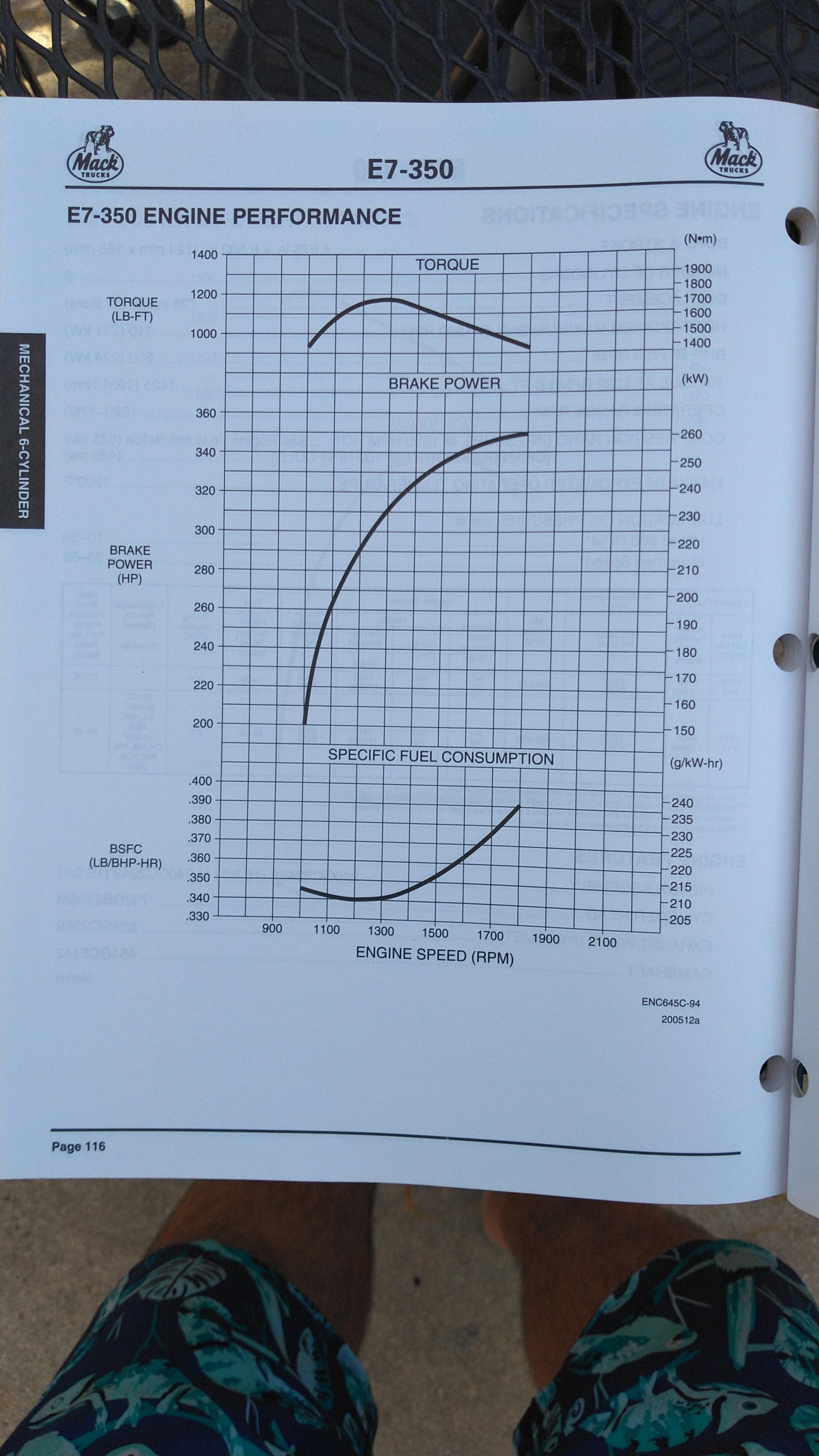

I don't know fuel pressure off the top of my head. What year engine? I have many E-7 shop manuals in my shop at home, and may be able to get you a picture of the page.

Taking the whole fac of is a bit of a pain as it has a tamper proof screw still doable however. . I would pull the 4 screws on the Fac and inspect diaphragm my self ! that way you get to see and understand what makes it tick! 😁 Your Good fuel pressure wise  ! (Actual personal experience talking here)  anything over 20 under load is fine it will pull !   15  will still pull ok but not great ! 10 not so much  think spec is 20 -35 !  If you take the little cap off the end of the fac dodad  there youll find a screw with a jam nut ! Loosen the jam nut turn the screw in (count the turns) crank it in two to three turns see if this changes your situation ! it will lay down some coal but this may tell us a little more about whats going on and will take some of the sluggishness out of your take offs! you can play with this a by tweeking the screw in little bit by little bit to get the desired lack of coal by turning it in 1/2 turn at a time! Taking the whole fac of is a bit of a pain as it has a tamper proof screw still doable however. Also the don't use the timing specs on that page as gospel  I beleive its a vmac spec your in the zone at 19 to 24 for your App in my opinion !!
Edit I see Joe posted the the spec page sorry my bad ! 19 min ! 🙄
Thanks FJH for your advice, However I am a little loss on the FAC I know the older mechanical injection pumps had them. I can not find anything like that on this pump? It only has wires going into the back of it. It has no lines from the intake manifold to the injection pump. It also does not have a Boost psi sensor that I can find only intake air temp that is also the only sensor that is in the manifold. It does have an air line for the air compressor inlet but no leaks on it that I can find.
Well My Bad I think I was looking at something and posting to another! you obviously have VMAC and joes posted the spec there that is the correct stuff except the HP which may change the timing! and Maybe the Cam key I don't remember! anyway I'm going to stop posting I think ! I'm getting tired of chewing on shoe leather and my foot is getting sore!🙃  Macpro or someone may have some answers here!
