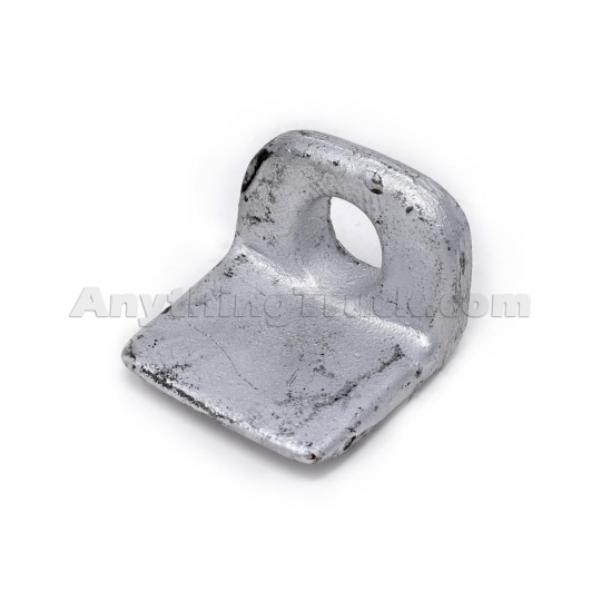

This is a timely subject as I am almost finished changing from 10.00x20 tube type to 11r22.5 tubeless. I noticed the spacers on the duals are a different width, one is 4" and the other 3 5/8". Anybody got a 20" x 4" pie crust type for sale?  On the side with the 3 5/8" one there is more stud coming through. The wedges didn't bottom out but almost. Both sets of drives run nice and true at about 200 ft lbs torque.
https://www.bigmacktrucks.com/topic/73056-dumb-question/page/2/#findComment-534984
New ones should be available, but not stocked. Special order item.

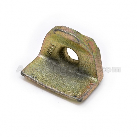

 There are two classes of wedges for duals. Heel and heeless clamps.  Heeless should never have the heel end touch the spoke, Heel can have a small gap or touch, provided it doesn't touch until the nut is torqued to 80% of final torque.
I would be surprised if the side with the narrow spacer has proper duel spacing, and the tires don't "kiss" on the sidewall when loaded.
If you measure the flat part of the spoke, from where it starts to taper up in the back, (where the taper starts, don't include the taper) to the end of the cast spoke.
If the measurement is:
6" try a 4" spacer band
6 1/4" try a 4 1/4" spacer band
If it is less than 6" pay close attention to duel spacing with modern tires.  My K-7 has a low GVW of 16500lb still uses a 6" wide (long?) spoke, the same as many modern hubs built for 11x r 22.5 tires.
Spacer bands are "sized" by the outside measurement across the band, not inside width.
 These are the most common combinations.
 Also there are  whole pages of wedges for duals with differing profiles and depths.  It isn't a "one size fits all" type of assembly.  The wedge must go over the end of the spoke and not be right at the end of the spoke casting when tightened.
 My 1942 IHC with 8.25x20 tires still takes a 4" band, I doubt that narrow band is correct.
 If you can find a casting number, or if it is branded (Mack, Gunite etc) see if you can find a part number in a parts book for the correct wedges and spacer.

I have the heel type clamps marked "Mack". As far as the spacer there is plenty of space between the tires and no load. It is a hobby truck. I never noticed the difference in width until both spacers were laying side by side and then saw the size marked on along with the brand Firestone. I had noticed a little more thread sticking past the lug nut on the one side but it still tightens down without the spacer heel touching the spoke. Hoping for lot of ride improvement with the radials.

When you tighten up on duals, if the wedges bottom you need a wider spacer
If you don't have one, weld a bit of roubd bar around to build them up, asin the Swishmans picture (top right) if still not tight enough, bunga bit of rod on the other side of the spacer

It might not be the "proper" way, but I have welded a few beads across the back of the wedges too, so they would clamp tighter. Whatever works, eh? Never had any DOT man look at anything that close.
