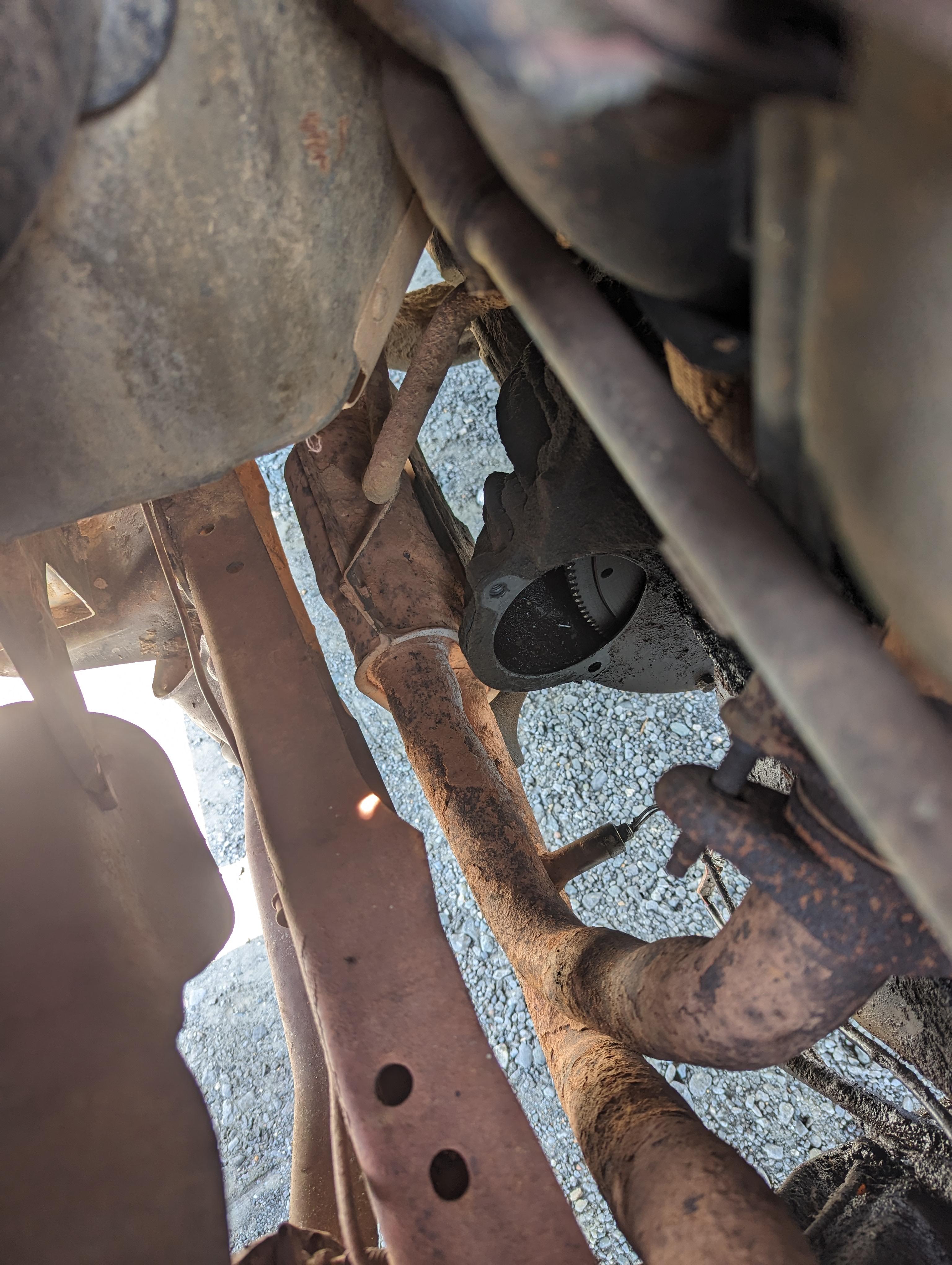

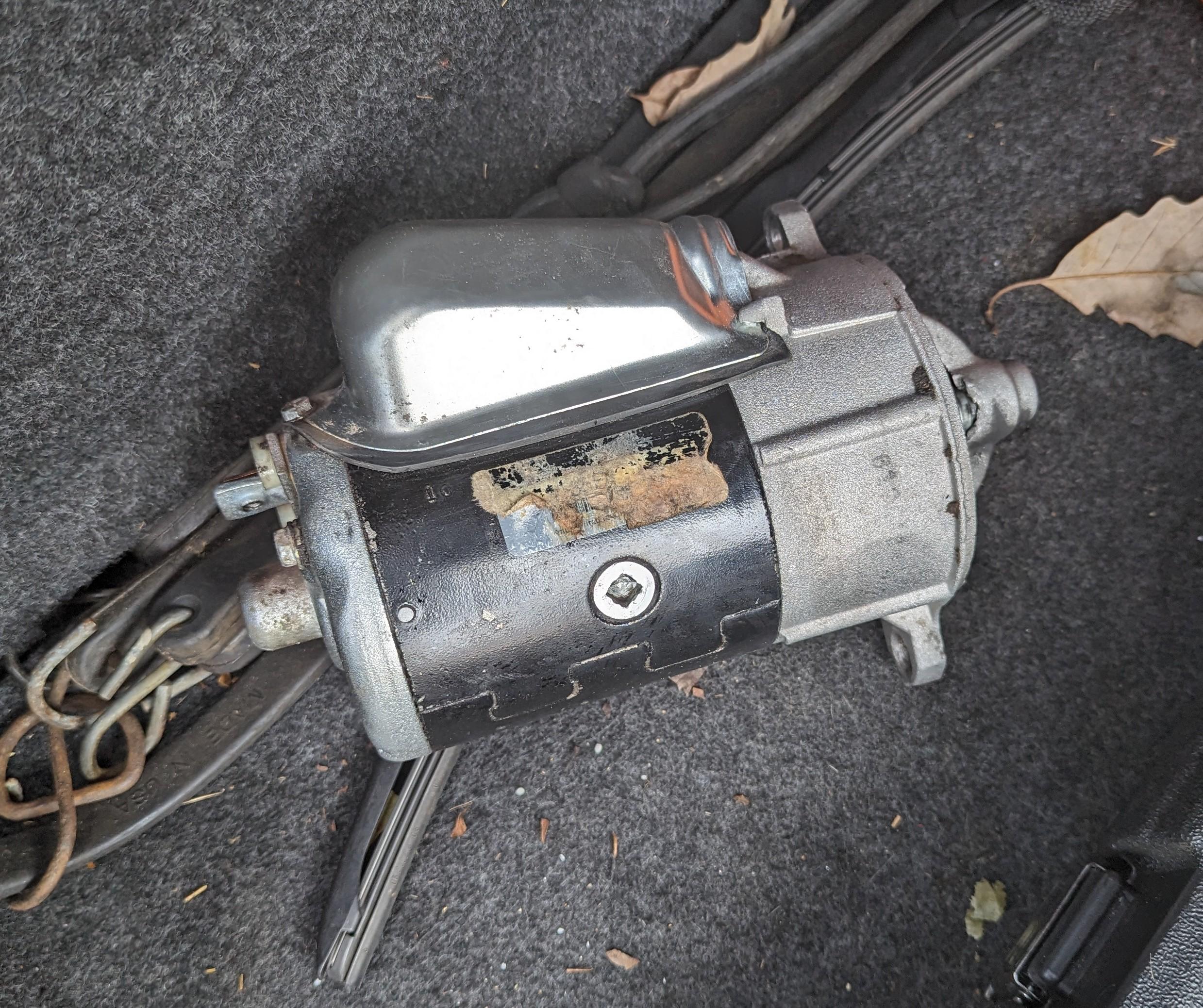

I decided to not be too much of a wimp today and went and took that starter off, on the ground, in the heat. It didn't come off too easy, even with the bolts backed out it didn't want to budge until I pried on it with a large screwdriver and got it to move. I could see the problem when I got if off, the teeths on the flywheel looked pretty chewed up, and I'm pretty sure that's what made the starter hang up.
I'm going to try a new starter and hope for the best, but it really needs a flywheel. I expected a starter to be about $40, but I'm out of touch with reality apparently. A starter was $90, with exchange. Supposed to be at NAPA in the morning, so I'll go put it on and see what happens.
I sprayed some brake cleaner on it so it looks pretty.PXL_20230725_150022667.thumb.jpg.9ecaafc9e0ef9c793d870fa84425c6d1.jpg
Hey bud,  take a small bastard file and dress up the teeth.. just clean up the leading edges.. the new starter will push the bedix gear deep. If there are no burrs or debris in between the teeth you will be good.. of course there may be other spots on the flywheel that need some love so put a paint mark there and roll it around and look.  Easier than pulliin a tranny in a 4X4...   Jojo
Oh, for sure, I was dreading the thought of possibly having to do that! So, if I took like a three corner file and tried to clean those teeth a bit, is that what you mean? I used to have several three sided files, but I don't know where one is right now. I guess I can find one somewhere though.

Yes....... i have a triangle file that cuts great..
I have a flat file, but It's a big one. Probably too big to fit between the teeth. I'll see if they have a small flat file at NAPA when I get the starter. Or Tractor Supply. Better to spend some time doing that than having to pull the transmission. I'd have to pay someone to do that, I couldn't handle that by myself on the ground. I'd pull the transmission out of my Nova and put a clutch in it in an afternoon, by myself. Did it several times, but that was almost 50 years ago!
Ouch! I thought a starter was about half that much. I thought a file would be a couple of dollars...PXL_20230726_133052089.thumb.jpg.3a6a42555325a48f9d0b0a031f7d855d.jpgPXL_20230726_132938068.thumb.jpg.3cf86d01fb23004a699f166889747c51.jpg
I know Ford parts cost more than Chevy parts, but that seems a bit high for a starter. Especially a re-man..  I see you had a core charge..
