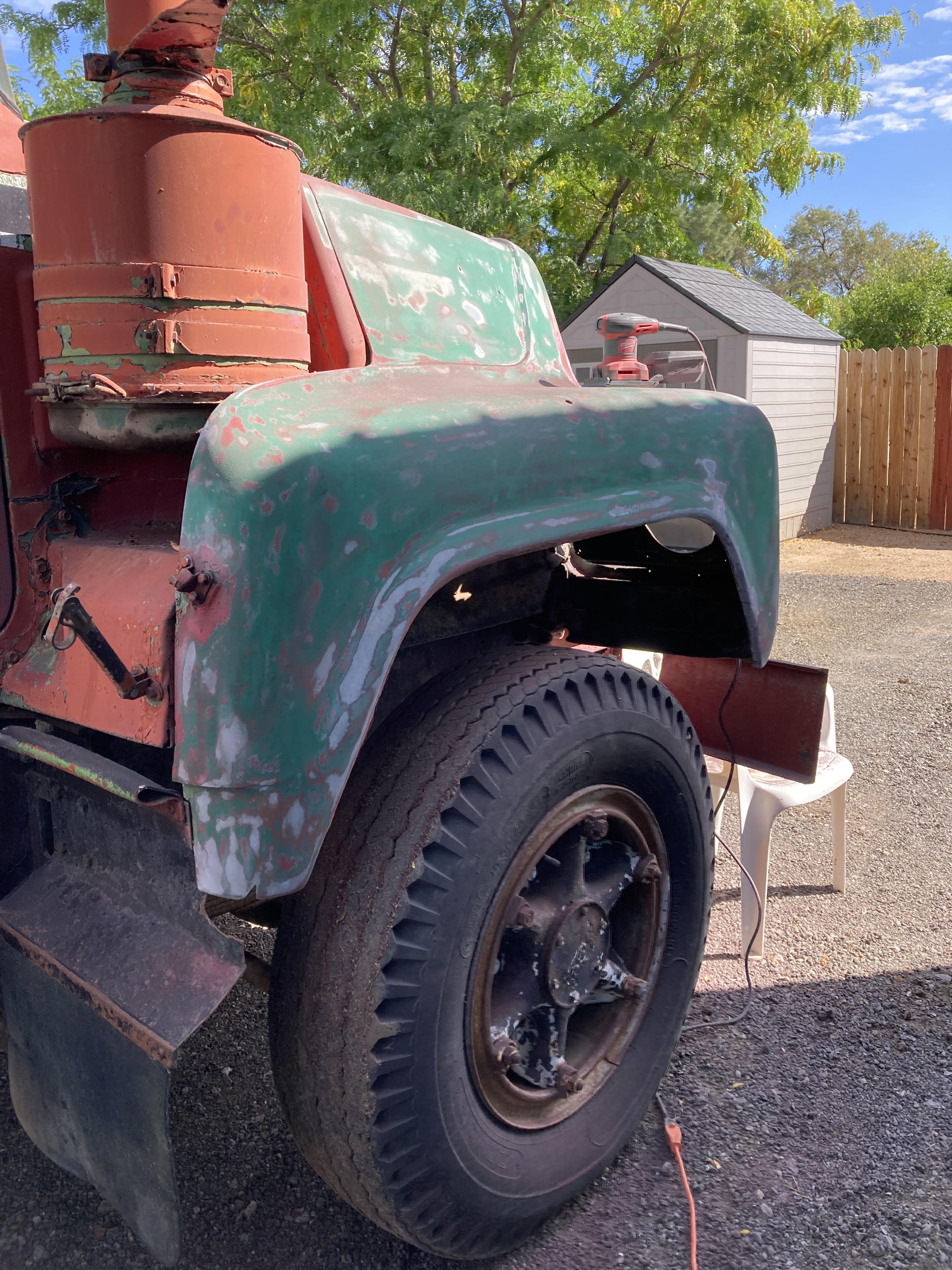

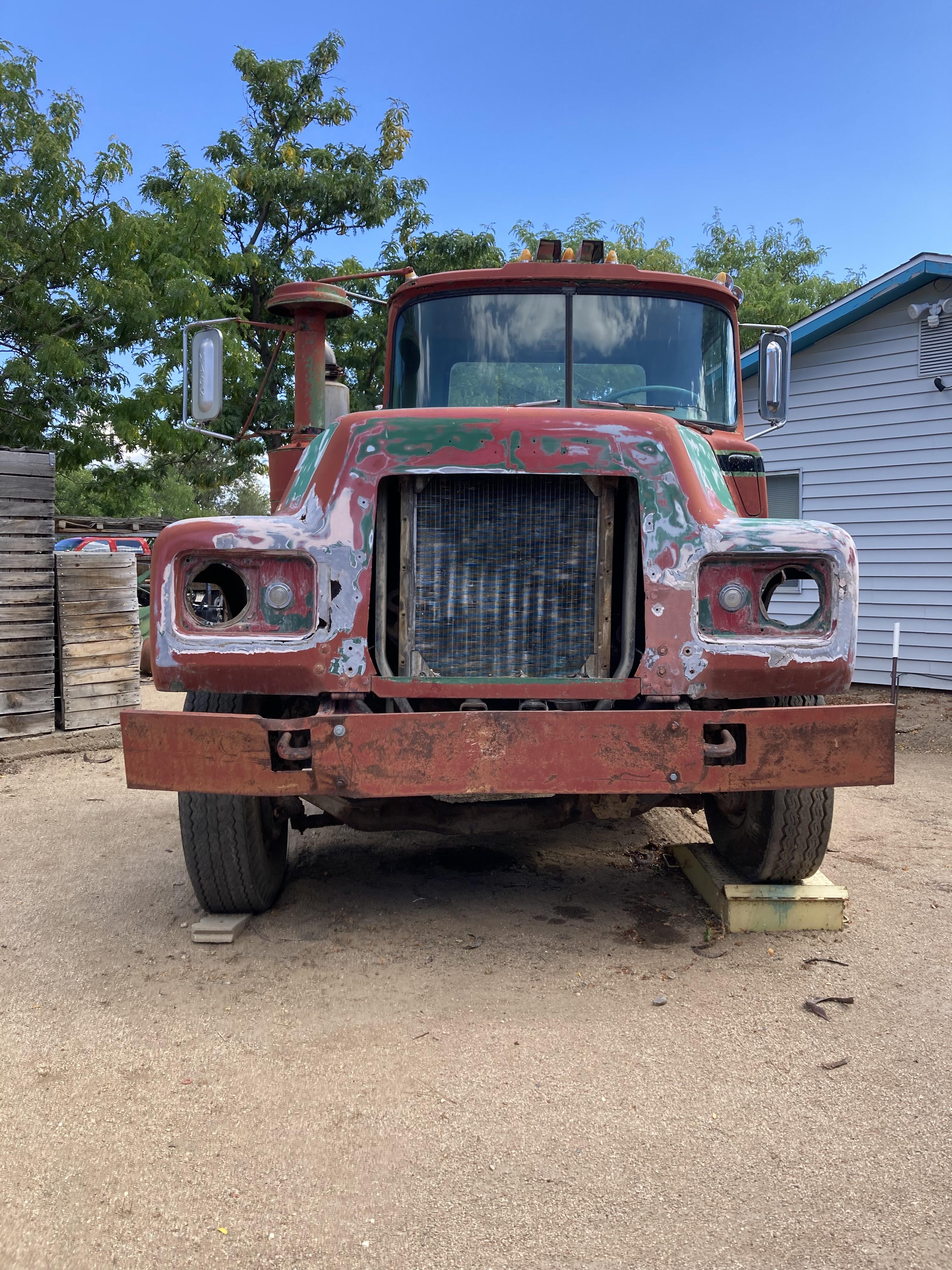

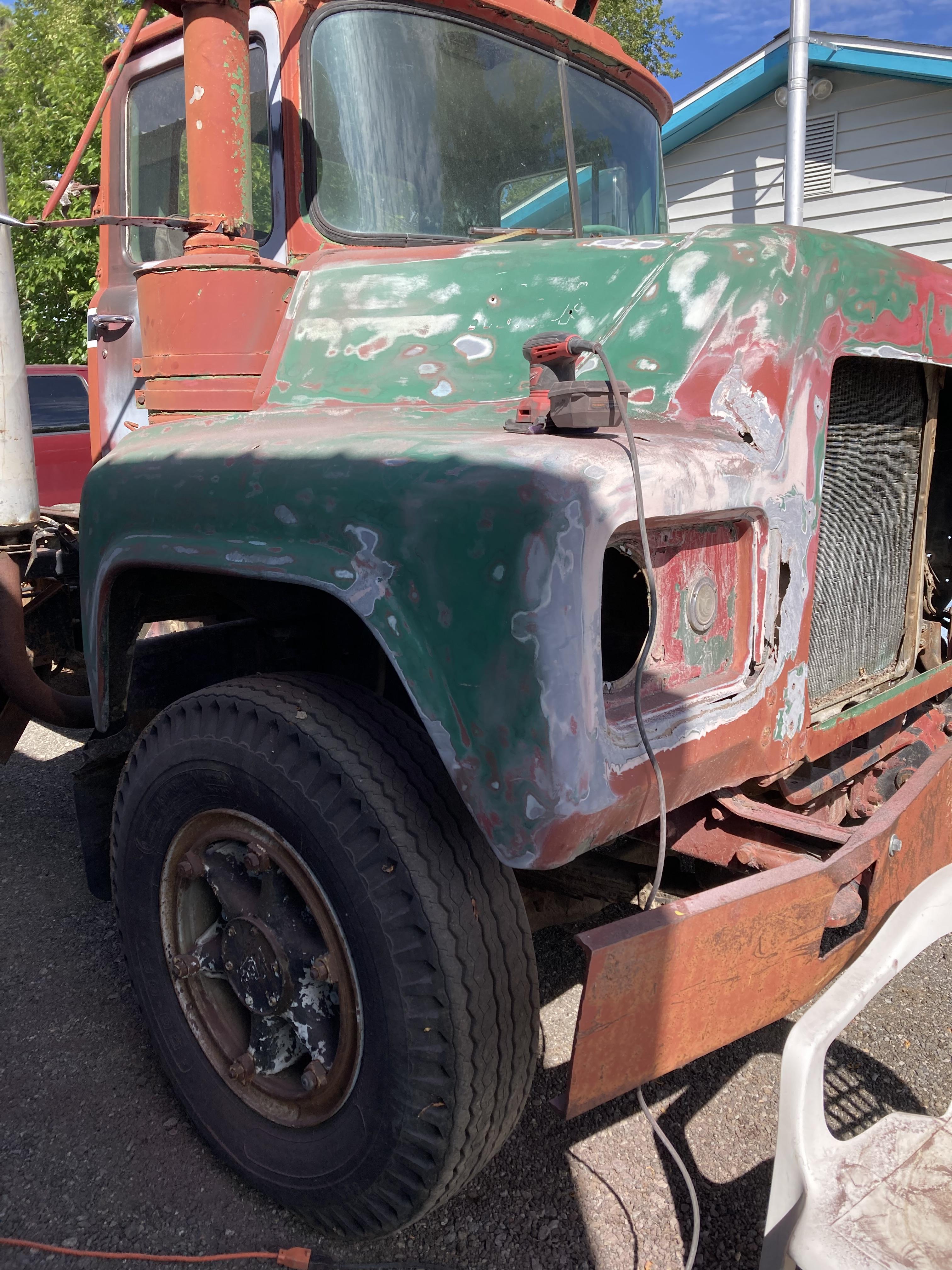

Well, I didn’t get any sanding done but yes, I worked at it for around one half hour getting too late still have to do yard maintenance and start winding down for early bedtime as close to seven as I can get … bob
