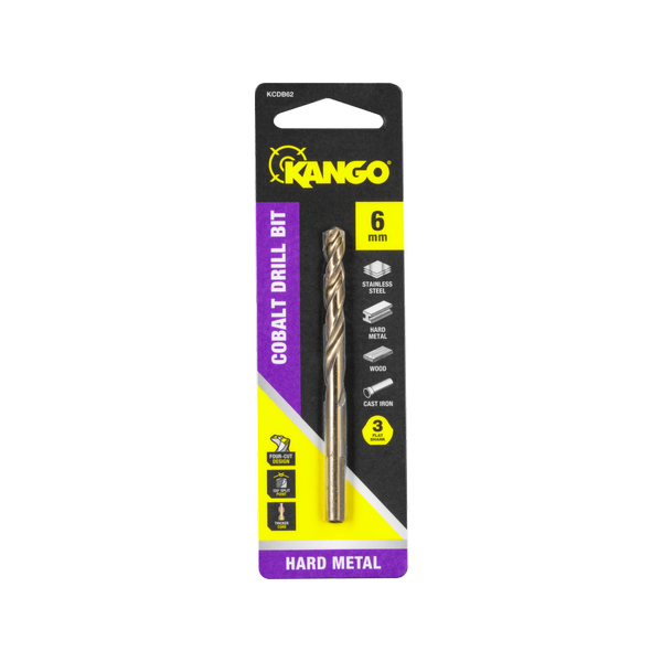

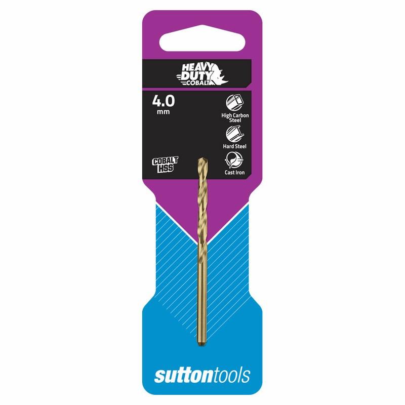

I found for tough going cobalt bits are the go
You can't sharpen them as the cobalt is a coating and once you grind it off the are back to a normal drill bit
I can drill hardox steel okay with cobalt bits were as a normal high speed steel drill just goes blunt in a few seconds
Paul

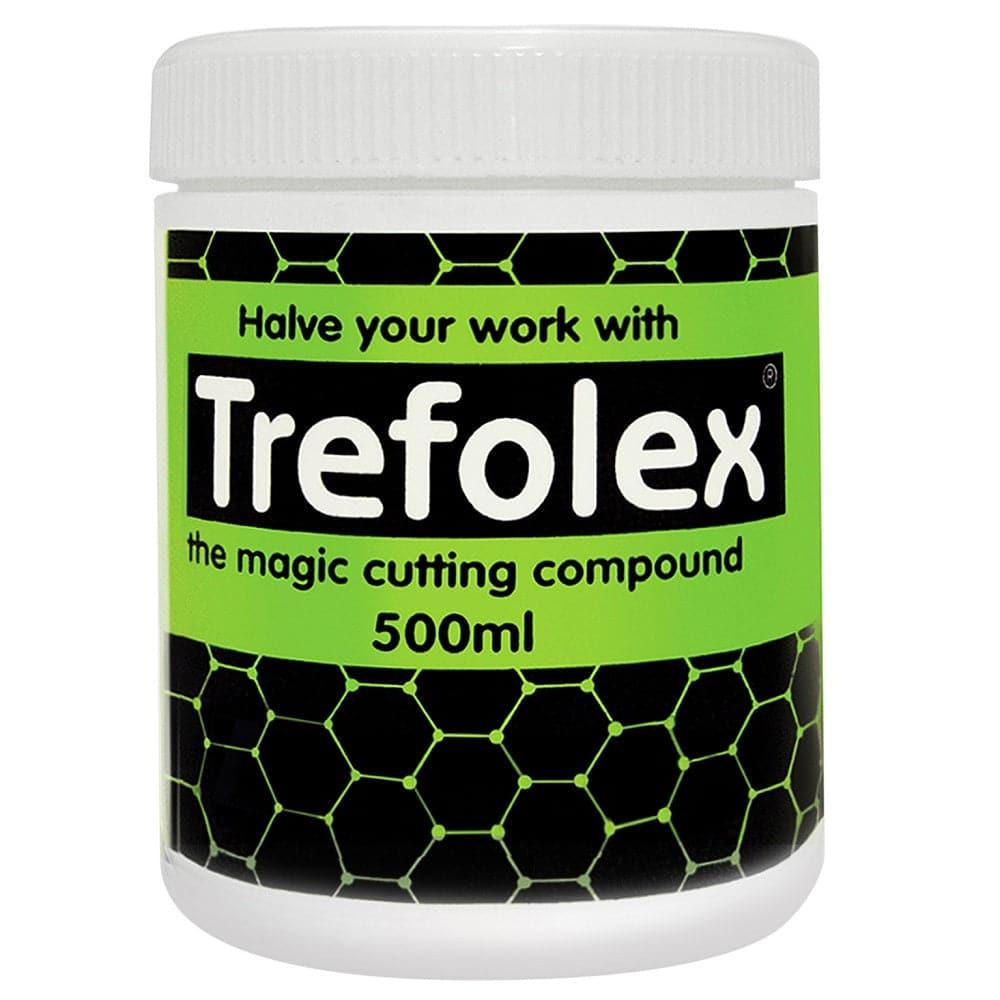

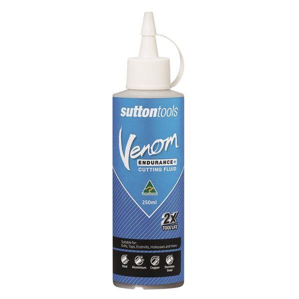

back in the frame drilling days , carbide drill bits ($$$$} worked best. using a lot of lubricate to keep them cool. excessive heat the frame rails became close to impossible to drill.
Yes, I remember that old trick from the old craftsmans when I was a kid watching them , they would always use oil in fixing I’m doing the same thing I make my second attempt at that plate. I think I can punch the old drills out from my back right now I’m just changing the oil ,,filter, filter in lines. started pulling them apart. Yesterday did not finish. I’ll get out there today. Pull out the filter taking out the lines tomorrow. I’ll stop at Freightliner and see if I can get the replacement parts sock filter. New lines just woke up still drinking or I should say, just started drinking coffee, wound up buying a bunch of oddball wrenches at a swap meet around 25 years ago bunch of hand wrenches were like 10 bucks. Turns out one of them has been toolbox. All this time actually fit one of the flanges like man are usually don’t get that lucky to have an open and that actually fits, once you get over 1 inch I usually don’t have one

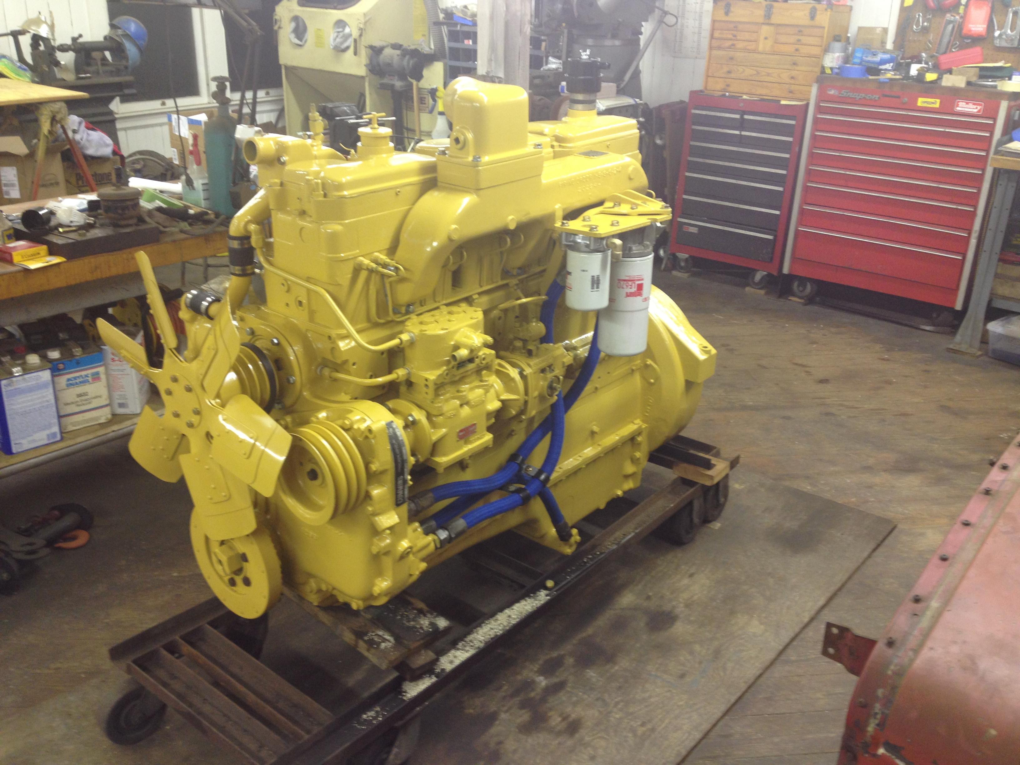

Oil line any of you fellas know where I can buy this stuff  they run off the oil filter canister to the block 2 of them are 7/8 I’d 1-1/4 outside braided…  1 is 5/16 id 11/16 outer we have three hydraulic line shops in town and they are all open 8 to 5 and close Saturday and Sunday. Thanks fellas.
Not a normal hydraulic size, I know this because of my own shopping adventures
Ended with a standard low pressure hose, "Ryco Trucker hose"
Pretty  sure Ryco is a Australian brand
https://www.ryco.com.au/product/t5-trucker/
Should be able to cross reference off the list
My stuff was woven reinforced type of deal, so if the link works, 350 psi
