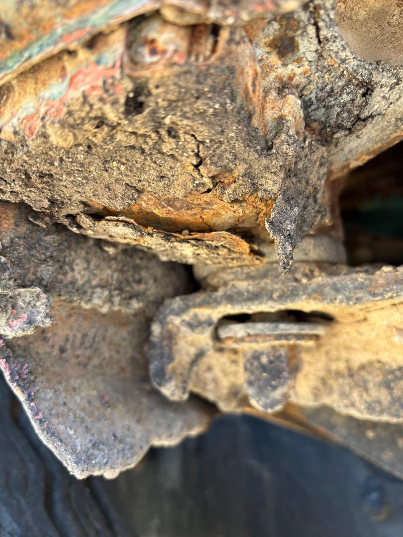

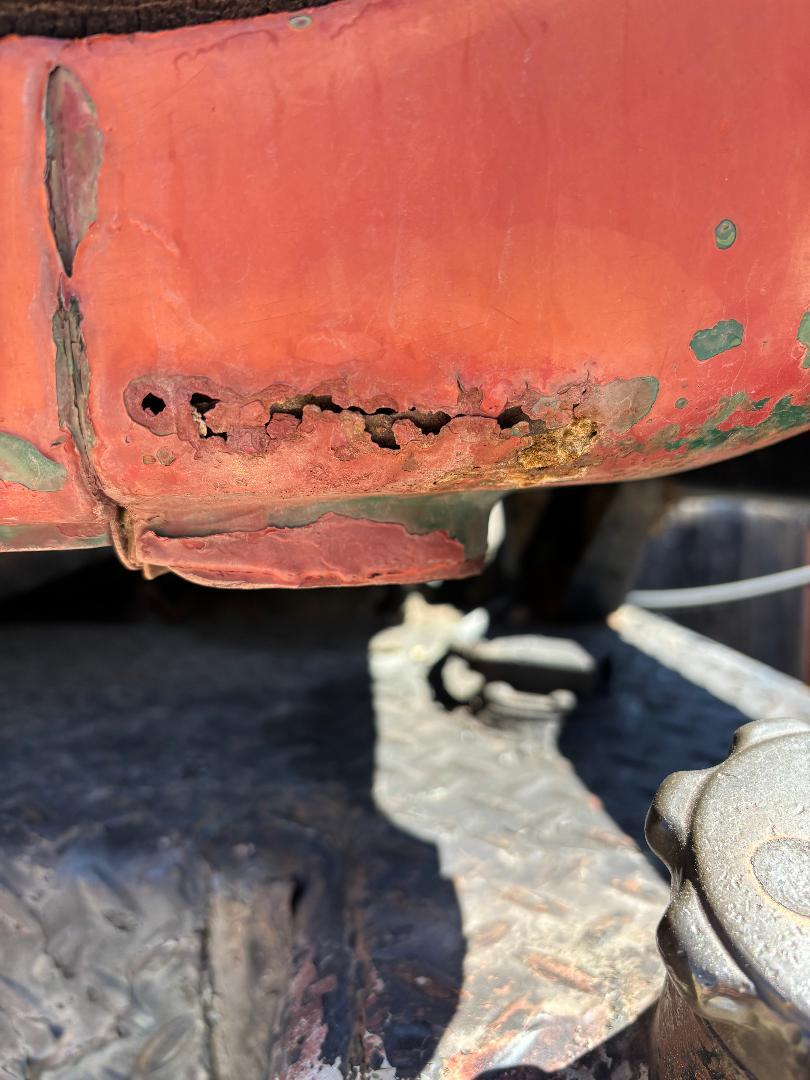

didnt have time to work on it this weekend,,,,between another challange 5k walk and wifes birthday weekend....but i think it was mark T asking me about drivers side body condition this is all i can find..as far as cancer.....looks like a protective plate mack added,,,bolts to body mount bracket,,,flaking and looks like bushing is shot and corner of rear skin...bob
