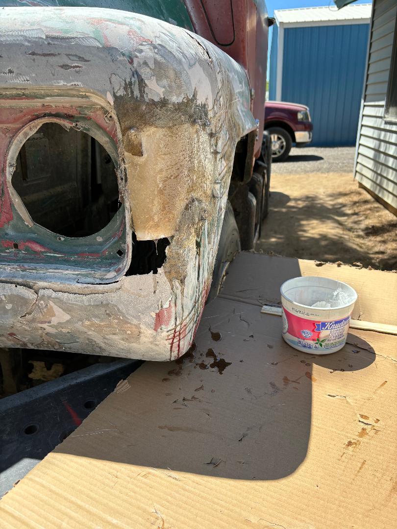

Once I get that left corner squared away that’s the worst part Got a couple of honeydews today gotta finish my yardwork. I might go mess around with it a little bit a little later as I mentioned I’ll probably gonna cut the panel right out the headlights and reset it in there
Yes, for one thing it’s the right level right where it is I’ll save the last area right where the hinge bolts go for last repair then I will pull it off to repair the underneath section that goes. I’m going to paint the outside and the underneath I’m not going to be that fussy with the underneath section. Just basically make sure I get all the oil and grease removed so that paint sticks. I’ll have to get a friend of mine over here to give me a hand, when the time comes I’ve done so much yardwork around here the past couple of days I’m sitting here drinking coffee, thinking I might spend most of the day in front of the TV
As I mentioned, they must’ve had some real crummy drivers in this thing through the years. I’ve never seen a dump truck get beat up so bad but usually back into shit. If nothing else I don’t know what they could’ve been running into so many times to destroy the nose, the way it is, wow wow wow ha ha

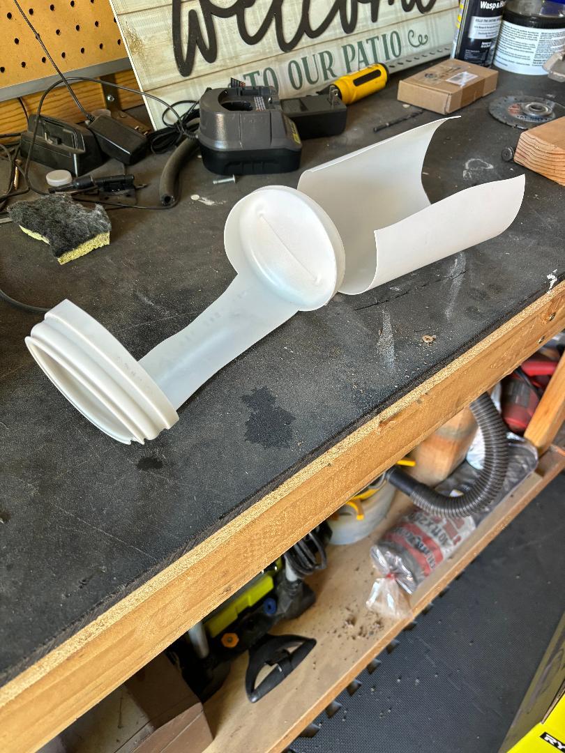

i was actually able to pull that piece of plastic rite out after it pretty much dried,,,,i didnt think that was going to happen,but thats what i was hoping,,,bob

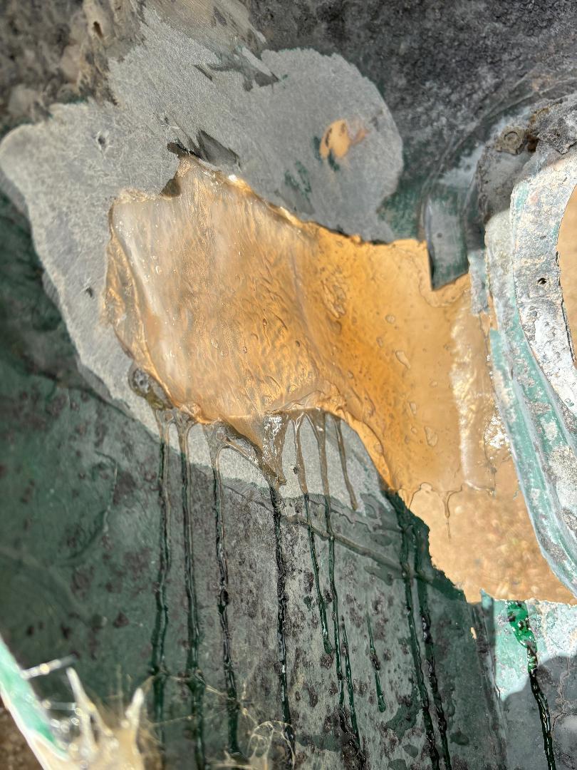

I think someone mentioned that (lol)   do a couple layers on the outside, then smooth out the back and start laying it on to give it some strenght.  Remember , air bubbles are not your friend.

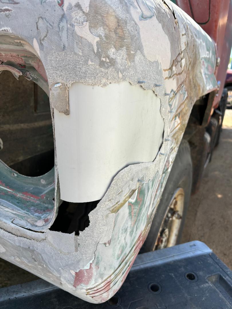

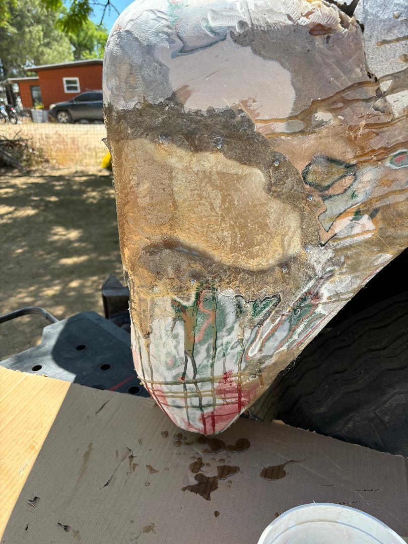

Yes, thanks I’m sure I’ll wind up reworking the same area at least twice. I was just out there looking at all that needs to be done. Next…  first layer didn’t freeze up as straight as I would’ve hoped but I had a start somewhere. My goal is to do as much fiberglass as humanly possible without using a whole Lotta bondo

Do you make the patch thicker than the original piece to add more strength

I’ll be laying it on thick to begin with and then the back I will put on another coat for reinforcement Thanks for your interest and input fellas

Hoping to be priming and painting the nose before the weather starts going south on me ….. I’ve been doing a pretty good job of putting a shoe up my own ass lately….as soon as I get this big mess cleaned up rest of the body work will be pretty much coasting and yes Mecho,,,,, 10 four on the phony president with absolutely nothing to say … bob
