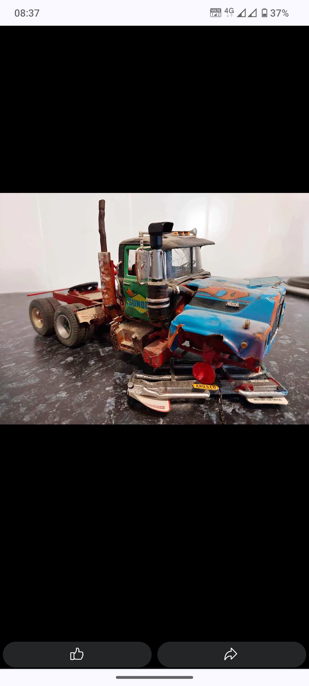

Hey Bob, just found another project for you once you get the DM hood done. should be able to knock it over in no time.
Keep up the good work.
Thanks bud …. But I’ve been working on a DM800 for 20 years….. sounds appealing but I wouldn’t hold my breath lol bob

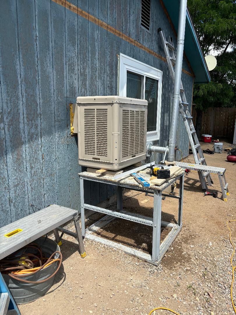

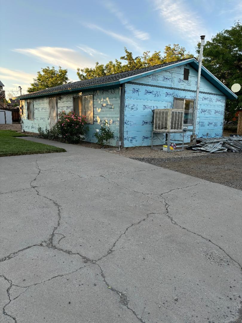

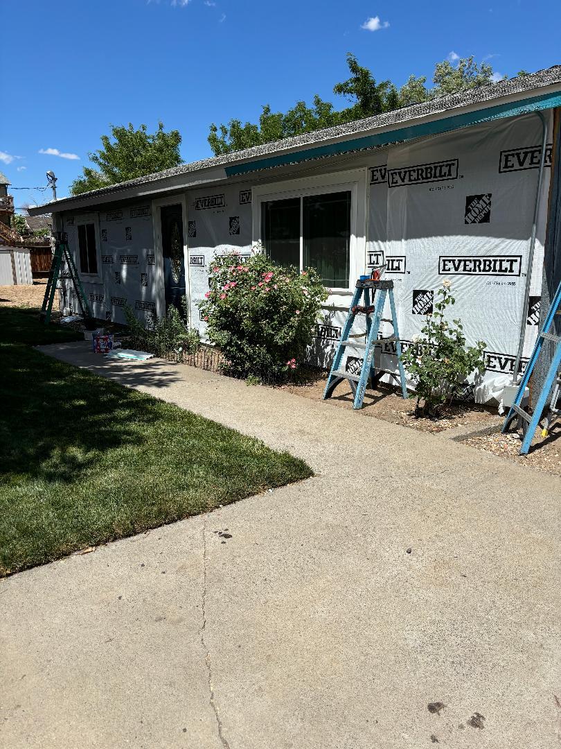

Look at that I’m stepping on my own tread. Actually I put it on here because I was gonna work on the Mack  but right now I got a construction crew changing windows and siding so it’s gonna be a little inconvenient to try to get it moved and do anything with it cause those guys, probably use the extra space to move around

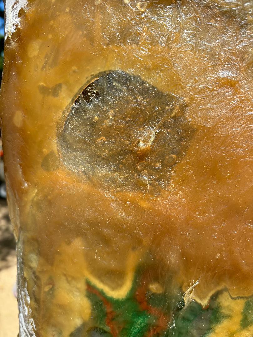

Speaking the hood it's much easier to apply epoxy on a horizontal surface. So I had my hood removed and we fitted it on one side at a time for a few bondo's than turn on another or over. Actually that's not a really hard deal if you have a spare pair of hands. Having my truck in a yard (no hoist or so) I put a stake of pallets in front of the truck levelling its top with hood hinges. Than opened it so the front layed down on the pallets. Took the hinge bolts off in that position and than two people can lift a hood and carry it into a shed. Three men is better though.
Yeah, that’s the problem. I have around here my friends all work nights and they all have the same problem. I don’t like to bother them on the weekend because they only have one good day but I’m going to have to call one guy over here at least two do the headlight panels, I was just thinking of that the other day there’s no way I’m gonna be able to put fiberglass there without turning the nose  upside down and yes that’s the problem I’ve been having a lot of sagging. I try to watch it and make sure it’s not sagging but I think I missed something  Slipped down without me noticing it But as you said, an extra set of hands is always handy. There is one brand I can depend on he’ll come racing right over here late Saturday or Sunday I don’t like to bother him. unless absolutely necessary … bob
Bob, sometimes (sometimes) those saggy ones if you plan it out can be held in place with 2" tape. From back at the part not being patched, and stretched tight across . It's not ideal and you end up grinding the tape off and usually redoing the mat and resin where the tape was. There's way less sliding off the 2" part though afterwards.
Thanks for that. I had wrapping tape on it in the inside last …  go around it seems though it slipped anyway I was thinking of probably both way to do it. Just do one piece at a time and mix up a little resin for just one piece that way here I can focus some at one area, possibly duct tape might be a little different than box tape I will give it a shot or should’ve left those screws in there. I originally had for that first piece of plastic. I should’ve left them in there until I was done with that area. they probably would’ve helped out considerably .  Bob

you know ive seen fellas build thier models,to look like they drove thru a snow storm,but ive never seen one biult to look like it was sitting in a wrecking yard,,,,wow
