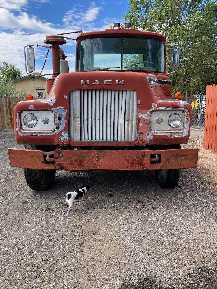

IMG_2296.jpgwhile we’re on the subject my little dog decided to crawl underneath and make sure I didn’t miss anything,,,,, of course I hadda have a treat ready for him after his full inspection 4??????????? Lol

And good progress on the bonnet
Fiber bonnets dont repair real well, I something happens in the fiber glass as it ages
You can get stuff that goes in paint to make very flexible
They use it on motorbike mud guards,sorry fenders for you lot and it allows the plastic guards on dirt bikes to bend around a lot
I wonder if when pain time starts, at the primer stage anything and onwards if it would help with cracking etc
Happy days
Paul

20 hours ago, Joey Mack said:
one of my Favorite Pen-Pal's asked me to help out..  Asked me to post a picture for him..  I bet Ya'll will reckognize it..  Jojo
Soooo.... Are those blue spots were made by a grinder? Or by the age??
On my mind there's a reason to apply a coat of epoxy primer over the repaired areas. It would harden the surface under the final coats preventing show up of uneveness of dencity and flexibility from down below. Also cracks should be opened up and for their full depth in perfect cases. With edges more parallel to the outer surface than perpendicular. This kind of job may be very time consuming. And the final result may vary depending on the amount of sweet and hours invested. And dust breathed in.
Vlad I think the heat from the motor causes most of the issues, all the different materials are heating and cooling at different rates, this causes the paint to crack
A lot might have to do were the truck operates and how long it operates for
A hour driving off to a truck show as compared to 12 hours at -40° c or +40° c
Anyway it's a few weeks until that stage is reached
Paul
1 hour ago, mowerman said:
Blue spots at  ground  it down through the fiberglass out doing yard work today
 I ground out the damaged areas  well into kind of dish it out …. That’s what your seeing
 We were barbecuing earlier  the truck was parked, pretty close to Porch notice  I missed a few spots  I will probably go over it next weekend. I’m going to sand  down the entire nose. As well as grab what. I Missed weekends over boohoo back to the old grind soon … Bob
Paul
Paul, that makes sence for sure.
The original hoods on my R's had very thick foam insulation glued to the inner side at the top and the sides. No less than 30-35mm (1-1/4") thick. That may help lowering down the heat affect to the fiberglass. I doubt many old trucks still keep that insulation in place and also don't know how your truck was outfitted from the factory.
