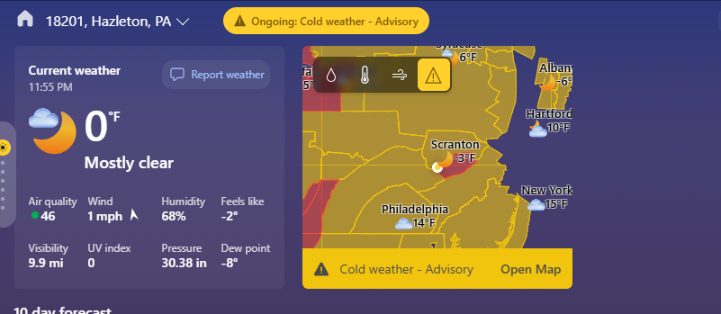

41 minutes ago, mrsmackpaul said:
Nice and warm here as well, well over 100 f yesterday and a much nicer 87 f today
Paul

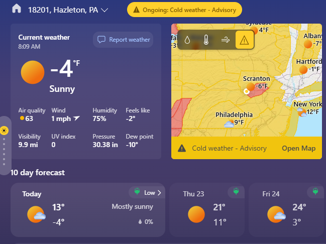

3 hours ago, cruiseliner64 said:
JC do you live in the Scranton area? Just asking because I was there once many moons ago....
Paul
Scranton is about 40 miles north of me up RT81. About a 45 minute drive
