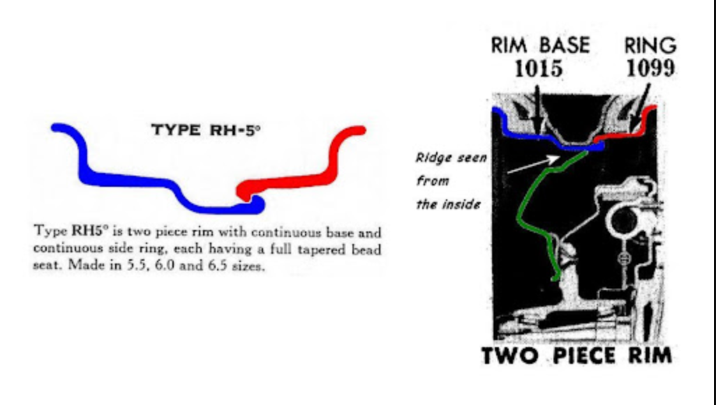

3 minutes ago, Geoff Weeks said:
I've even heard people say "Spokes on the steer are illegal"!
Now I hear guys saying multi piece rims are illegal.
I have many "tire shops" say multi-piece rims are "Illegal" I always correct them, They are not Illegal, you may refuse to work on if you chose, but that isn't the same thing, Be honest about what you are doing.
Not even the Firestone RH 5 deg (widowmaker) is illegal, it and all multi-piece rims/wheels  were "recommended" to be made Illegal by the Insurance Institute, and insurance trade group, but they have no standing to make law.
 The Firestone is the only one I don't like to do. There is no good way to be sure it is going to stay together after all these years.
The way they latch together is also where the most rust and weakening takes place.
Edited by Geoff Weeks
Add info
1 minute ago, Joey Mack said:
Damn. Ok guys. The only one i heard was no caps on steer axles, no biggie, just asking.
That is an extremely common one and many police inspectors get it wrong. It was something at the CVSA class the instructor harped on. It only applies to buses.

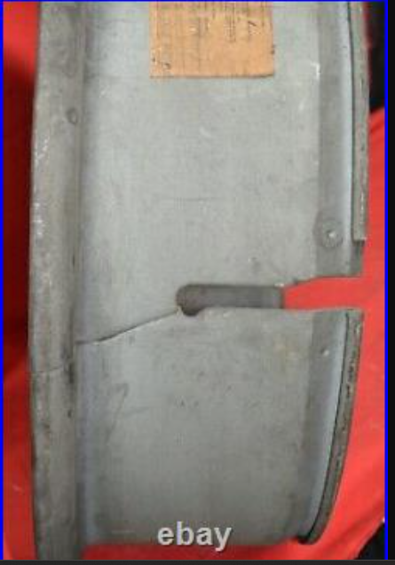

 The old Goodyear rim that splits along the valve stem slot is another rim that most young inspectors get wrong. The claim the rim is cracked all the way through! Ok, what is holding then?
Isnt that the rim style on my KB ?  They are true split rims..  I understand them, knowing the ring holds it all together and the air is in a tube.. im not eloquent, but i get it, and have no fear of doing tire work on that style. Hell, dont need to take the rim of for front or outer tire change or tube repair.
Yeah you used a block of wood on the floor to offset the split
Not exactly, the spokes force the rim out and that is countered by the solid lock ring, holding it from expanding.
To dismount, you have to remove deflate (or deflate and remove) break the bead, place on a block near the split, then you put a rim tool into the slot, and pry the rim in under itself, pealing it away from the tire.
When mounting, the safest is to air up after mounting to the spoke, the  spoke will expand the rim, bringing the ends into alignment and holding until air pressure can hold it.
I have a bunch on my K's, I still prefer split lock ring style, but I restored a bunch and mounted tires on. It was hard to find lock-ring style in narrow enough width.

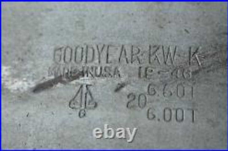

Goodyear "KW K" rim

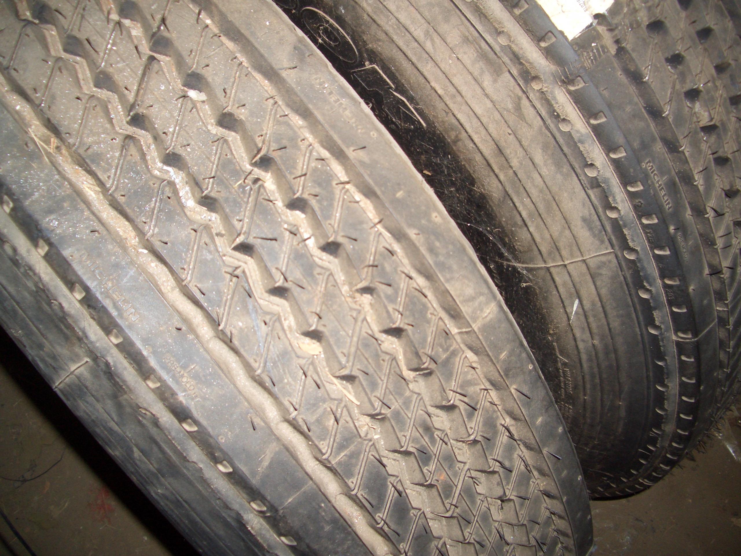

Interesting post.  So a capped steer tire would have been sold as a trailer tire, or an 'all position' tire ? I didnt know about weight limits for regrooved tires. I would assume Schneider Natl'. knew the ruling there... I drove cab overs for them from mid '98- late '99, and i saw them using an iron to trace out the grooves and sipes . I thought it was pretty neat at the time. I do see, 'regrooveable' cast in to the sidewall of some drive tires..
You can get caps in many tread designs. I used to get them in "goodyear 159" type rib tread, that I ran in all positions. I didn't run "lugs" on the drives.
If I remember I'll take a picture on the brand new caps on the rear of my Marmon with 0 miles.
The weight limit on re-grooved only applied to steer position. Drive and trailer could be used to the full weight rating of the tire.
Re grooved on steering is limited to  somewhere around 4K lbs (I don't remember the exact figure) but for just about all purposes, a re-grooveable tire, would fall above that limit when on a steer axle.
