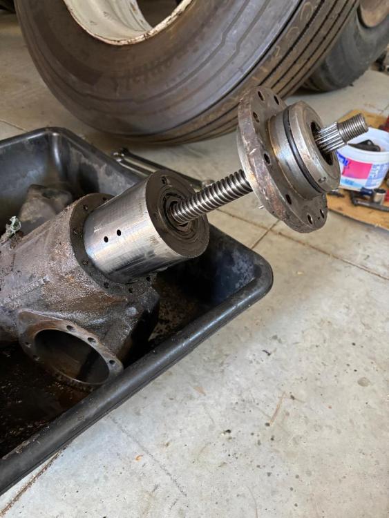

Mech, glad you are here. Take a look at the other thread im posting in. Its about pulling a RB inj. Pump.  I posted some info, but you may/will be able to fine tune the info..

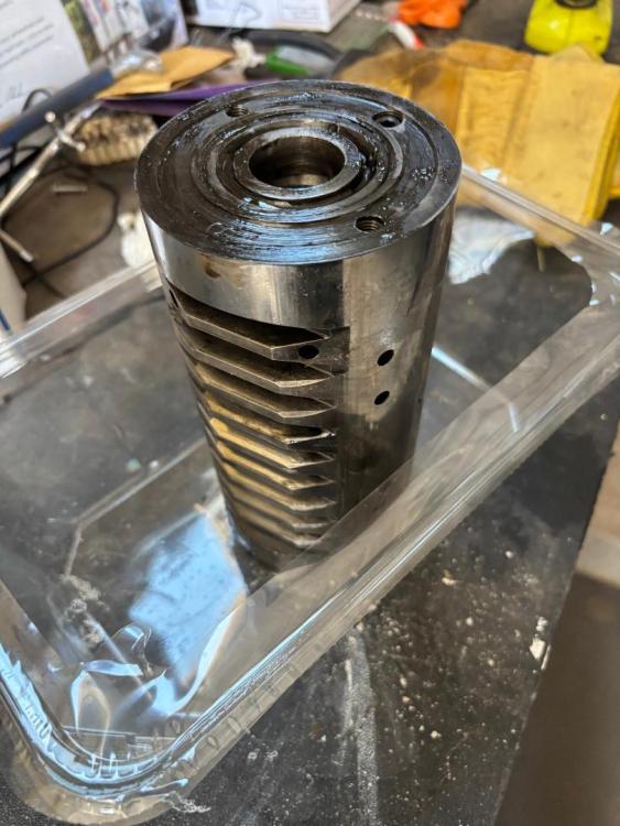

9 hours ago, mrsmackpaul said:
Needs two people as far as I know
One at the pump pumping and one turning the motor over slowly backwards and forwards
It's called spill timing out here, has been 20 years since I have been involved in doing this
Paul
American pump ;after SUPER CLEAN top of pump . remove  hold down nut -- 1 1/4 wrench ;pull barrel and needle valve. replace barrel /hold down nut. helper starts the engine turning while watching flywheel marks(degrees). fuel stops flowing from pump ; it's on mark. spill timing complete. for the Robert bosh I remember having a tool for barrel alignment. basically a 3-4 in slotted bar which clamped to #1 cyl also slotted end went over cly2 and three
