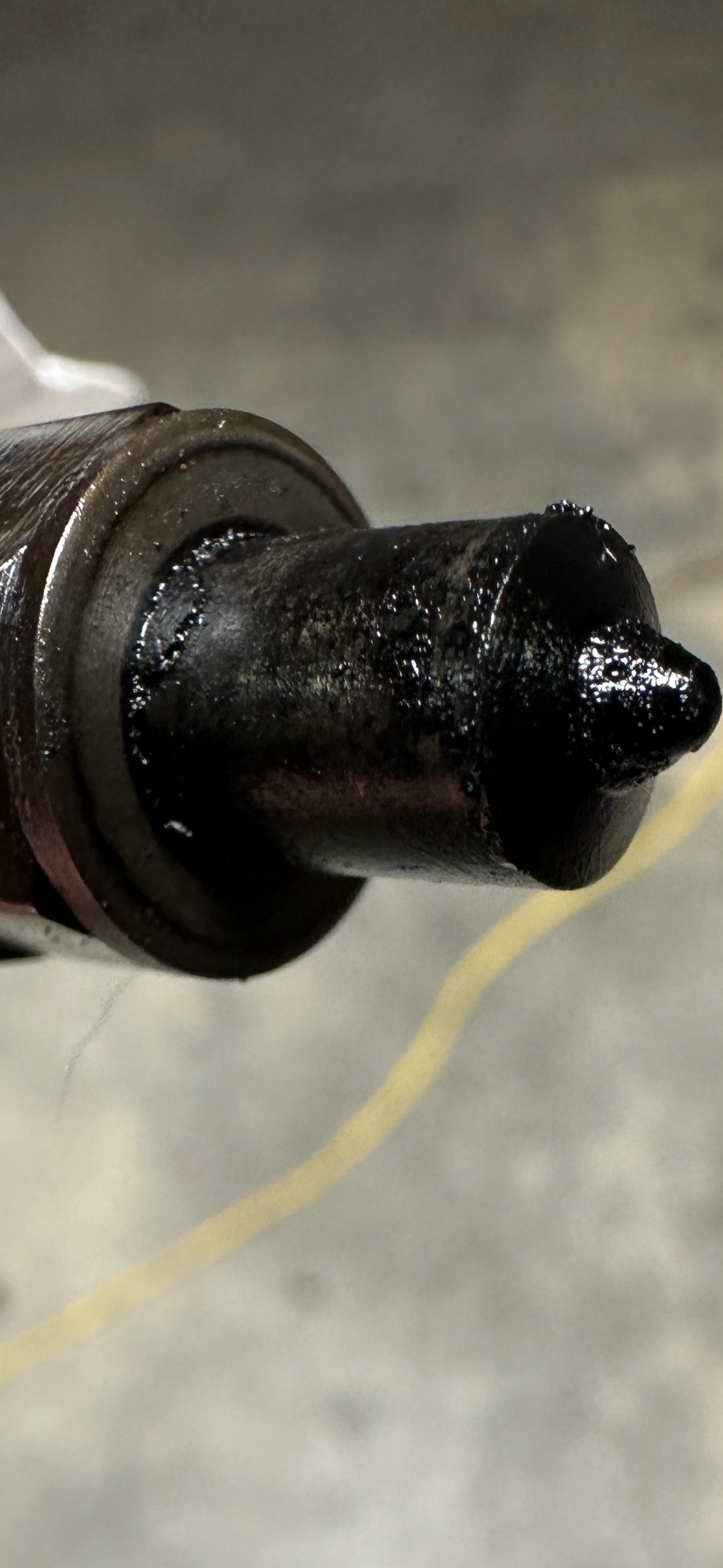

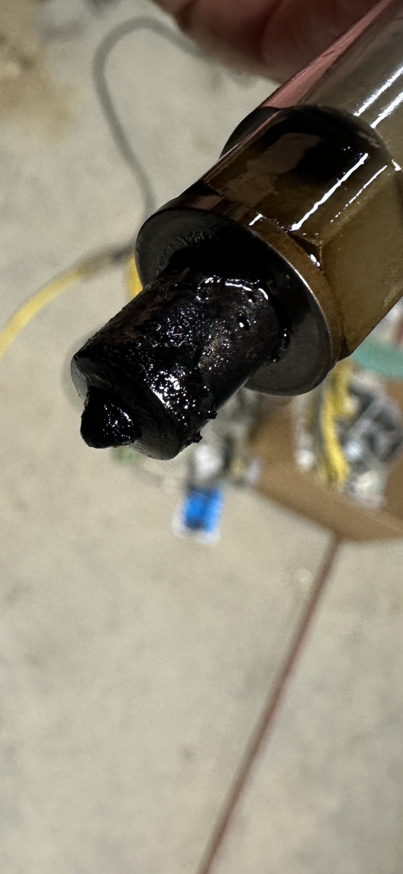

I just pulled these injectors from my 96 DM688S with a e7 350. Comments welcome. Injector No. KBAL 137 P 26 571.  I see the same no. for a e7 400 except for the 571. Iam not super familiar with the injector numbers. Does this 350 have 400 injectors ?
  I also noticed that the injectors have 2 green paint marks on the top ? Would these marks be something original from the factory ? I have never seen that before on replacement injectors

Factories typically put paint marks on during assembly to indicate they've checked/torqued bolt down to spec. Could be all that is. If it's a Remack engine or was rebuilt by someone in the past it could be the reassembler's Quality Check mark.

I dropped them off to be tested a a Bosch pump  shop. The guy there said the green paint marks were a QC mark from the bosh factory. They are most likely the original injectors.  Pretty sure they are going to be nfg. 3 out of the 6 definitely had bad o-rigs as they were soaked with fuel and leaking out the head.

You should be changing your oil then!!!
