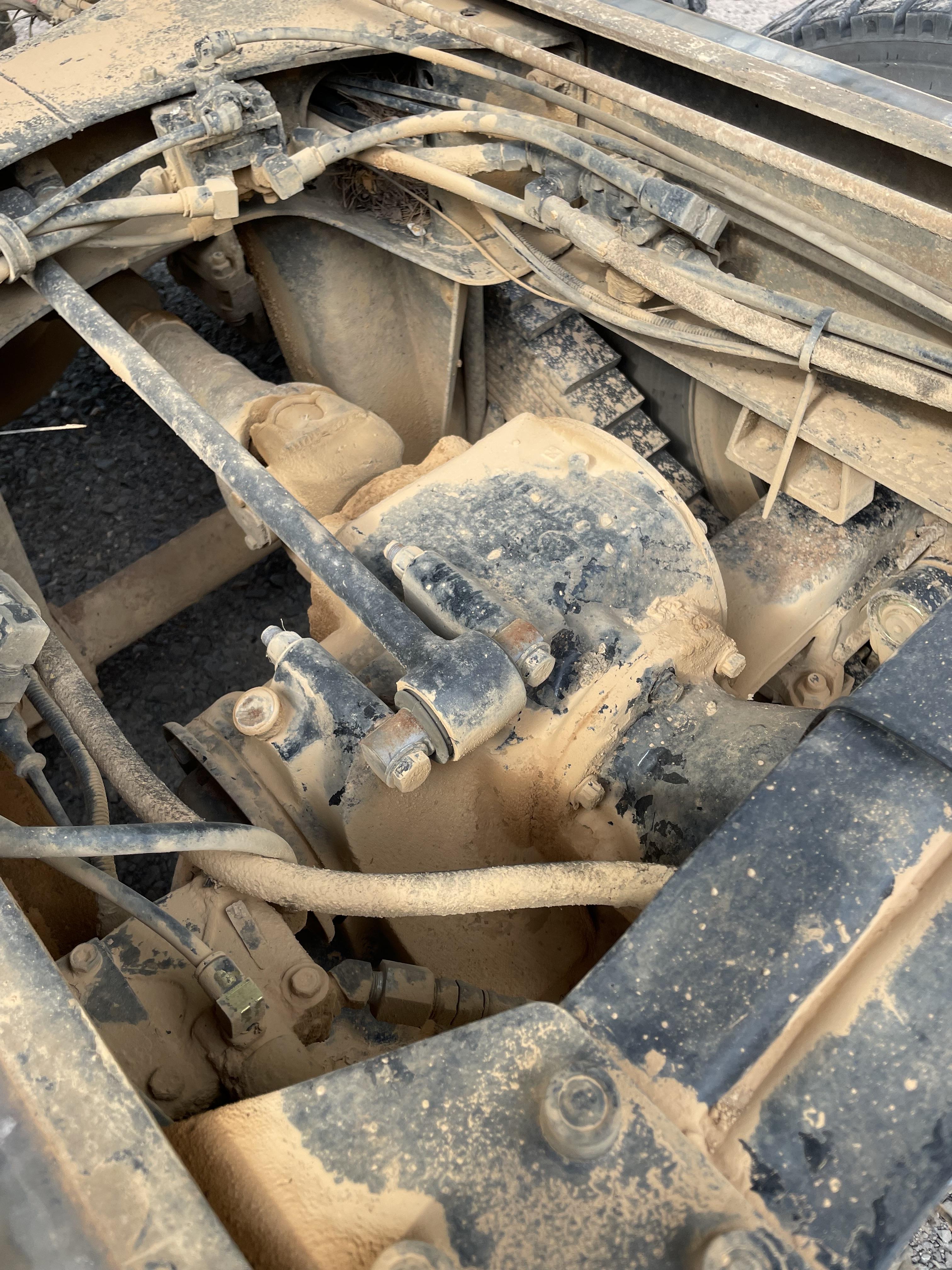

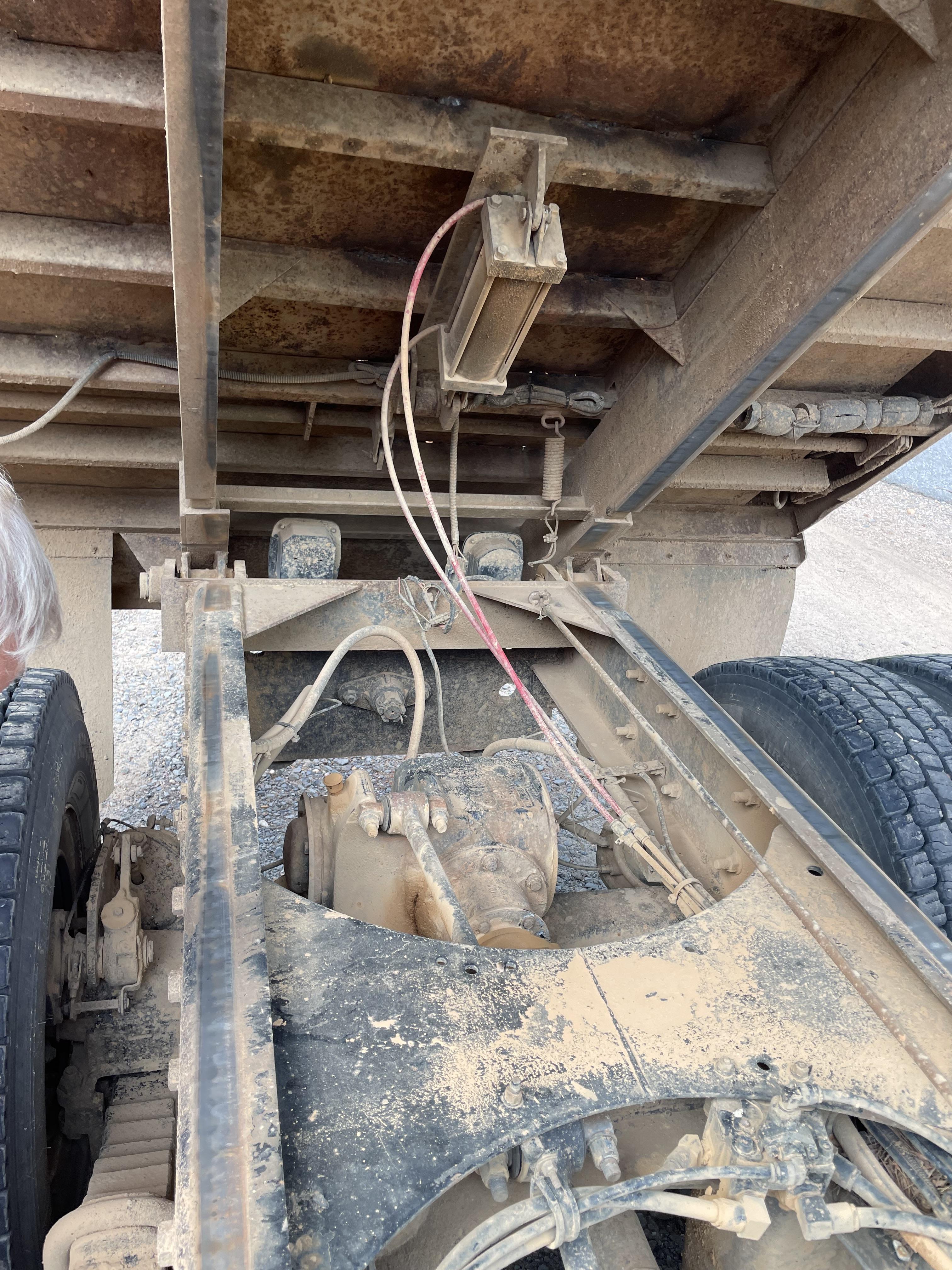

next question is how do the rears work. Do i have a power divider? Are the front set positive track and the rear set limited slip? I dont have a button inside to lock the axles. IMG_3293.thumb.jpeg.56dcbabc8809bad149611bc2d1c2cfa0.jpegIMG_3292.thumb.jpeg.391104016219f20e8178d836f0f3cbf6.jpeg

Ricky.  The front diff. Will have a longer power divider with an air line going to it. There is a shift fork housing there. The picture of the front diff. Doesn't show the whole thing, but looks like it does NOT have a locking power divider.
The rear axle is the main drive axle, the front is supposed to come in when a rear wheel looses traction..  it doesn't work very well.

If you don't have a dash switch up next to the ash tray then you have a peanut style automatic power divider. It requires at least one wheel to spin on each axle before you're "stuck". Not exactly sure how to interpret your particular situation you found yourself in, but I'm guessing your power divider was engaging and you had traction on your forward drive but not as much on the rear, so you had some weird tire actions.
If you have the dash switch up by the ash tray then your power divider is manually turned on/off. To use this style you have to stop all wheels, flip switch on, then try going.  One of my trucks has this style, I tend to reserve it to get myself unstuck rather than using it to get stuck. If that makes sense.
