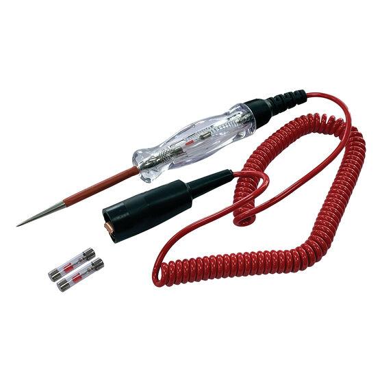

Well something in common to all of the above is most likely the culprit
I would check the grounds, or earth or what ever you blokes in yanky land call the frame/chassis side of the battery, can't say negative or positive as I dunno if it's negitive ground or not
Either way, pull some of these off and try cleaning them up and see what happens  then
Paul
https://www.bigmacktrucks.com/topic/73121-1951-mack-85-ls-1522/#findComment-536257
Paul said it best ,start with the test lamp probe.   their should be a junction box on the firewall (in engine compartment) with the main power switch on the box (terminat) should have power. check the positive & ground connections . It sounds like their is no power to the junction box  . I would try  connecting a jumper wire (#10 ) from the negative side of battery to the junction box.
https://www.bigmacktrucks.com/topic/73121-1951-mack-85-ls-1522/#findComment-536304
Will do thank you for the help. The fuse box is in great condition. I have to check the large fuse above the fuse box looks like a shotgun shell.
