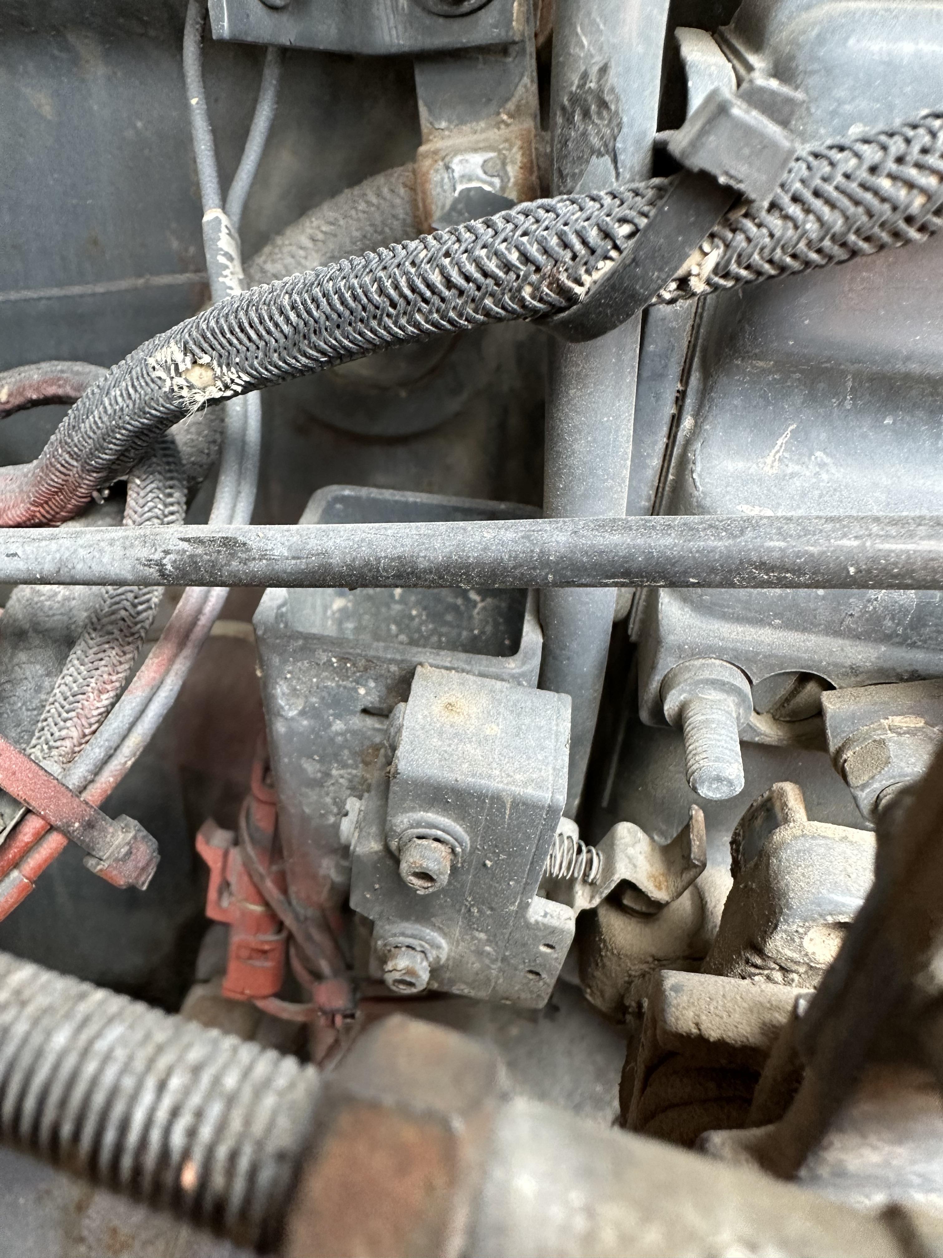

Dirty contact inside can cause resistance, and the one at the injection pump is always subjected to dirt, oil, and heat..  just something simple and 🆓 to inspect..  I have found bad throttle switches on dump trucks, that were affected. Can you post a picture of the throttle switch?

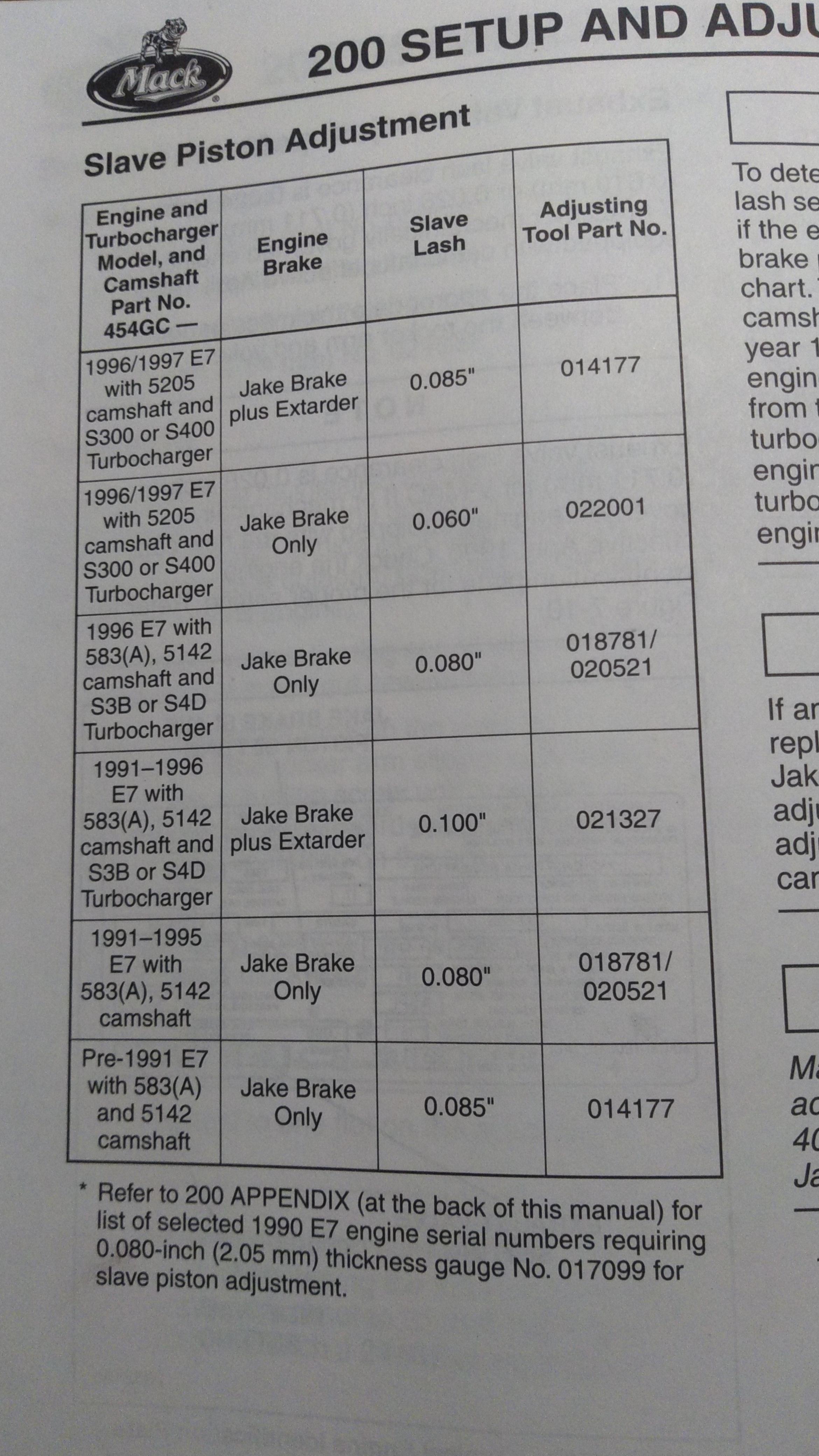

I think a valve adjustment is in order.  Stay with the procedure that Mack lays out in the book.  We can guide you..  also, many guys dont look at the valve yokes on the 4-valve engines...  they HAVE to be set..  You Can, Remove the jake heads,( this will allow you to inspect the top end).  Or you can leave them installed..  and get (2) .010'' feeler gauges..  put one under each end of the bridge and press down on the bridge, and feel the drag on each feeler gauge,  adjust the screw until they are evenly dragging..  no need to rotate the engine for this step..  then put the jake heads back on and run the valves by the book..

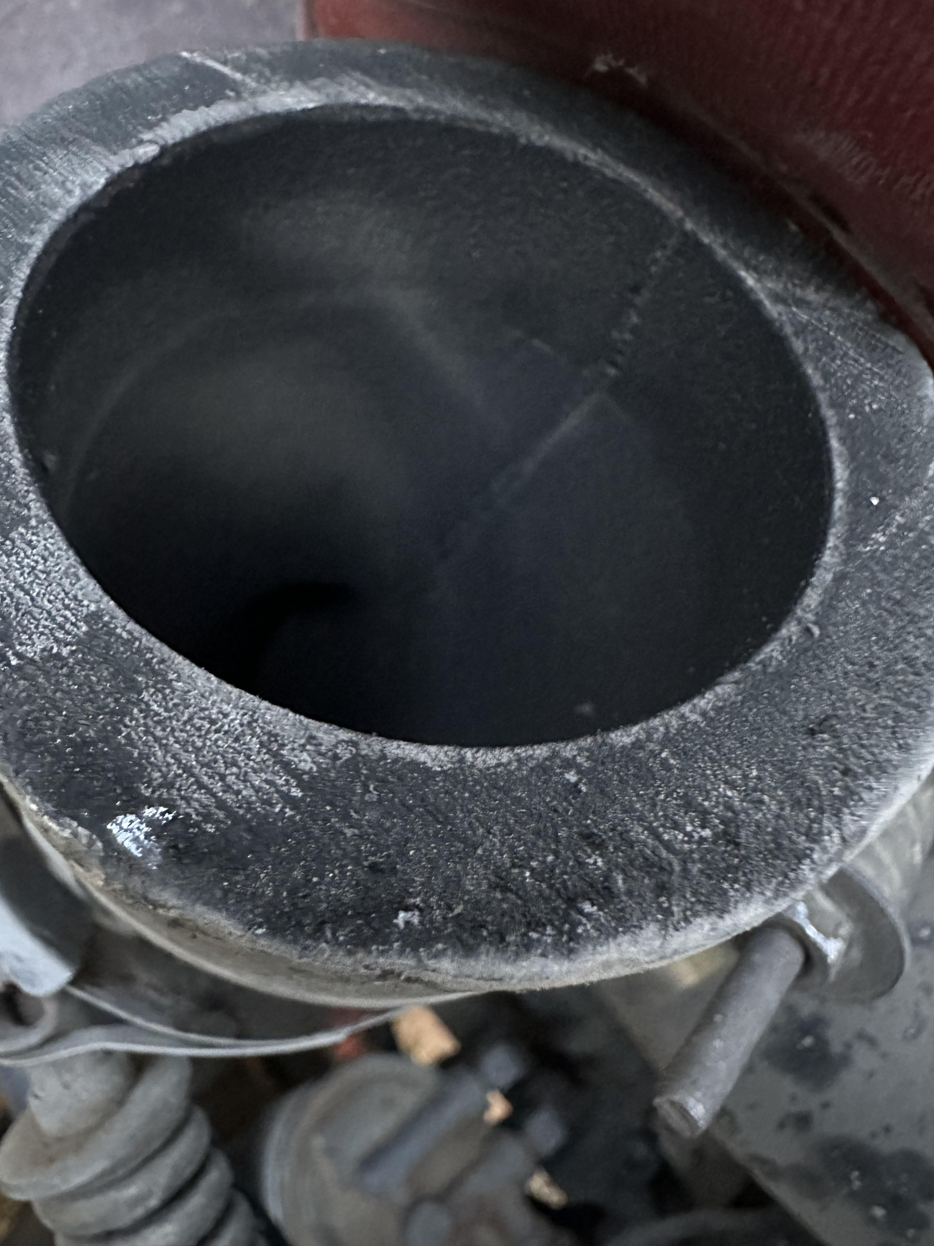

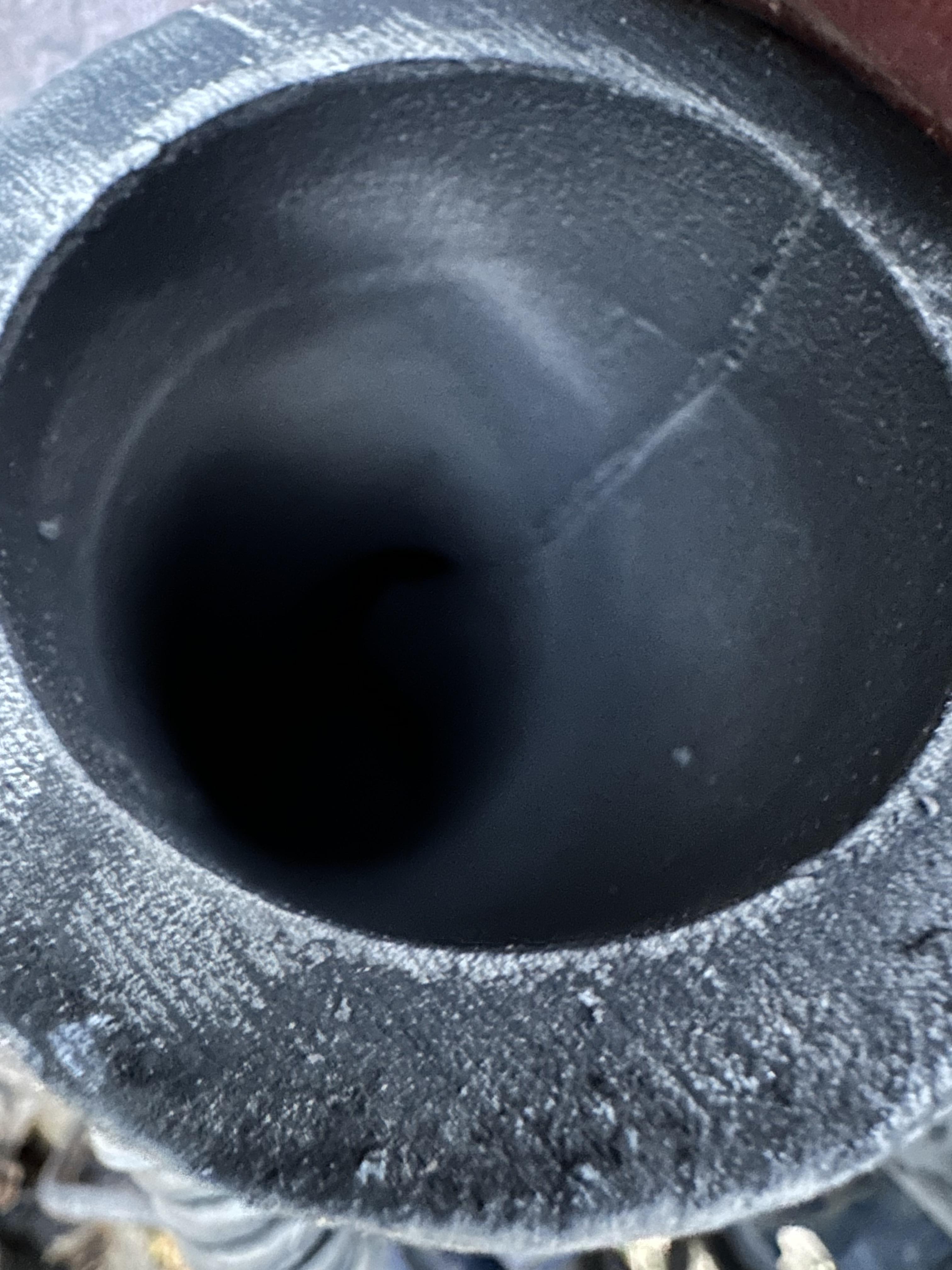

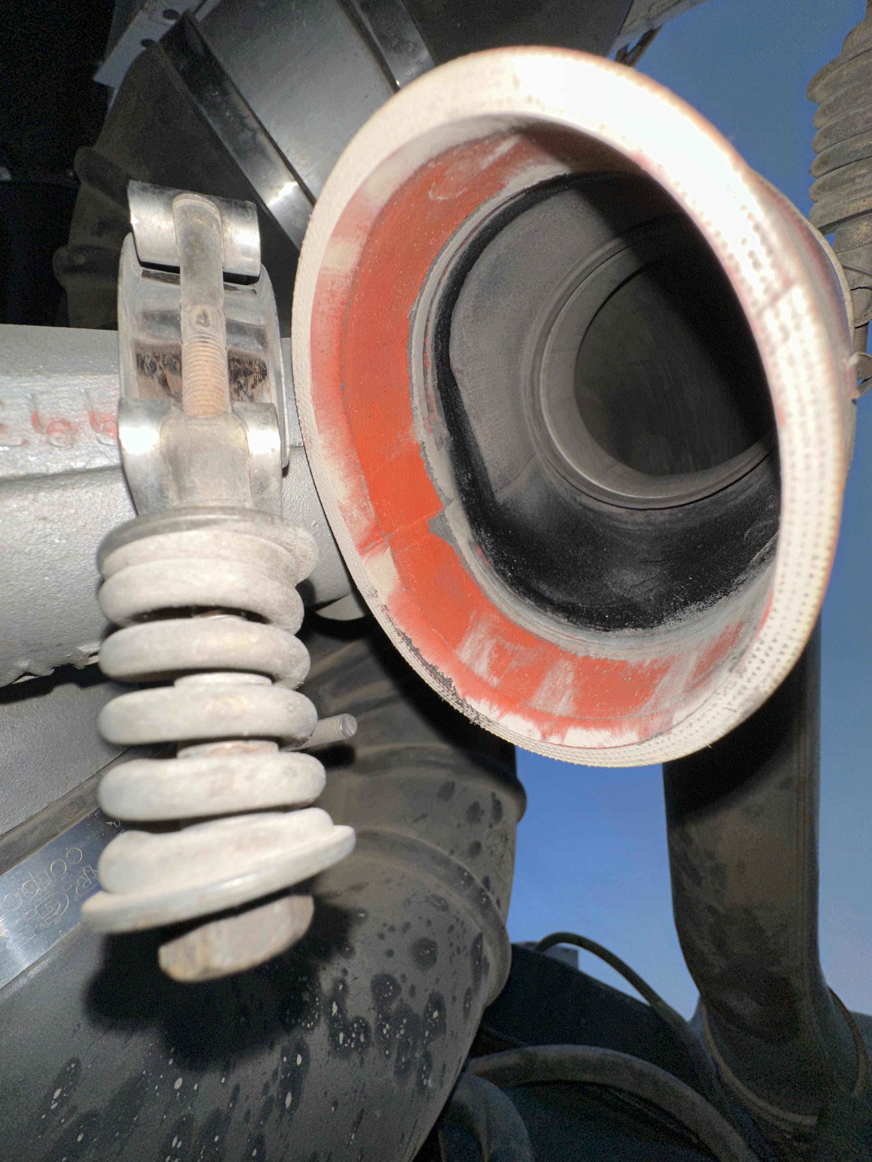

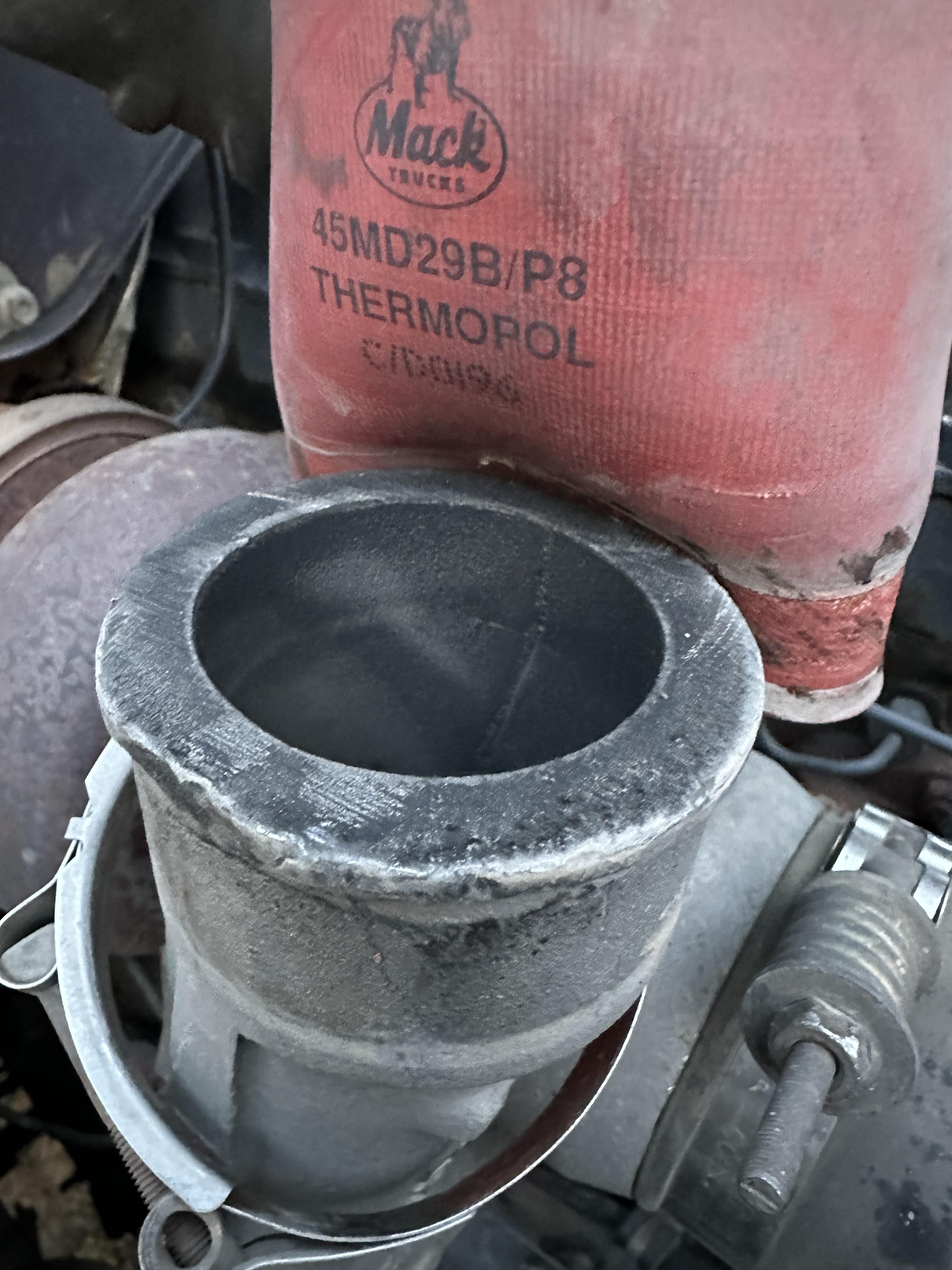

More issues. Just pulled the boost hose off the turbo looking for causes of bluish smoke and some oil consumption.
  So I don’t think what I found is good. Sooty, black and tar like on the compressor side of turbo. Not like some I have seen soaked with oil. Here are some pics. Could this be enough to cause on and on bluish smoke all of a sudden.
  Boost only hits 20-25 max with the pump opened up. Should hit 30 +++ in my opinion
Almost looks like exhaust going into the compressor side ?
Will look at intake tomorrow.
it doesnt look all that bad..  pressure test the CAC.. Cracks appear at the top right corner and run down the weld where the viens meet the side tanks..   usually on the front side.....
