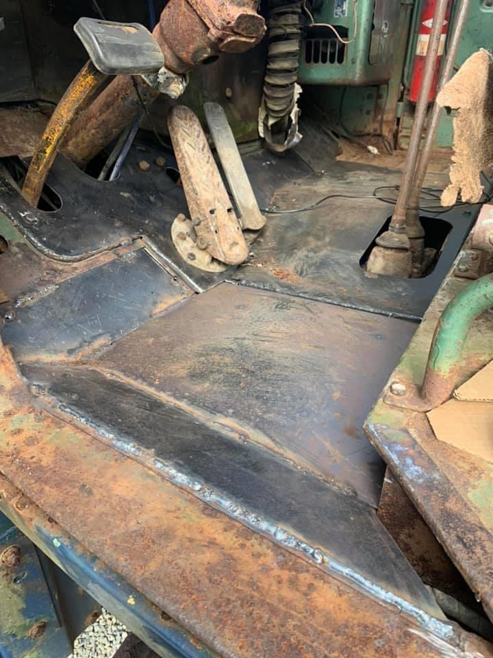

Is there any difference between the B80’s and the B60’s cabs other then the lip under the drivers seat of the B80’s.My reason for asking is the two panels that I have the sanding disc on are not original,but they do work so I will most likely leave them in.If someone out there would have a cab for a B80 series laying around I would like to get a look at it.
I think I probably might have mentioned this before. I don’t think most of us thought you were going to get so deep into this project. That’s excellent. Many pets on the back ha ha coming along nice thanks for letting us know…. Bob
