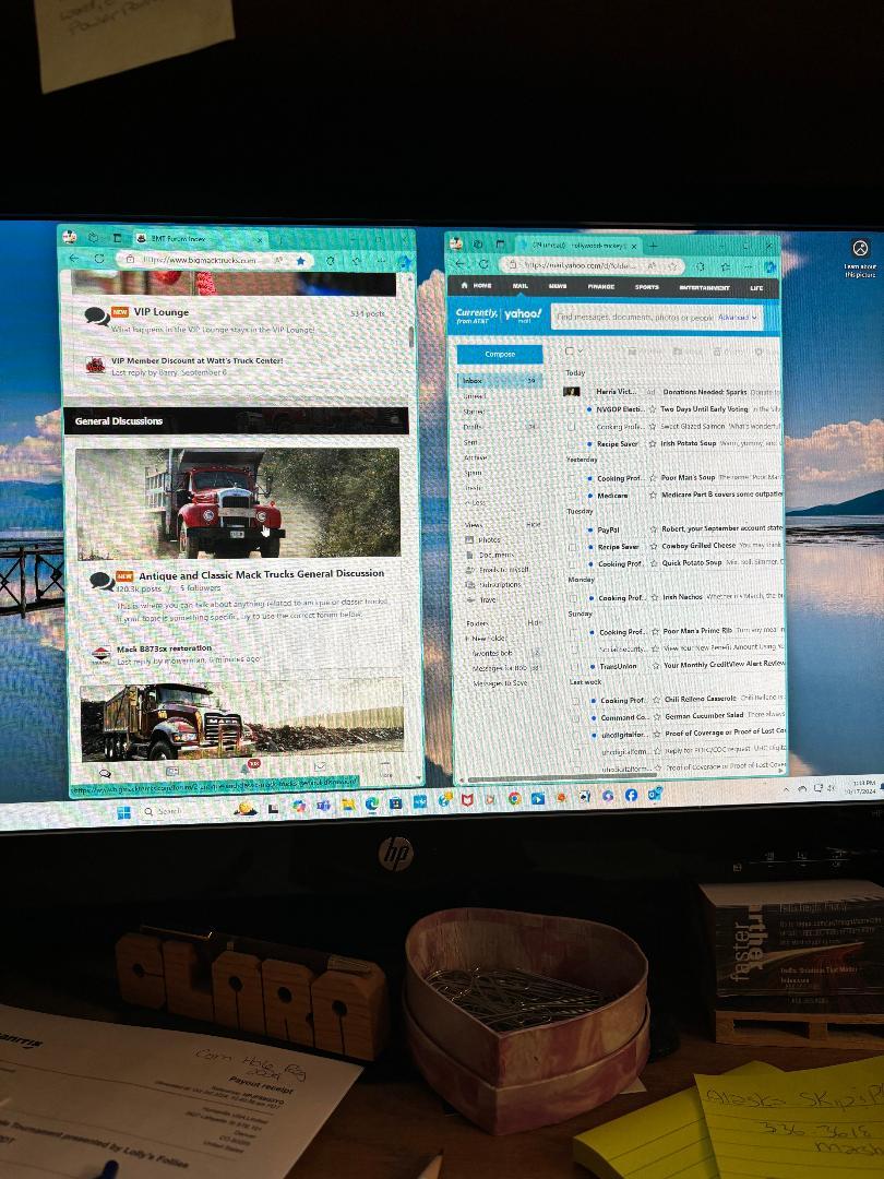

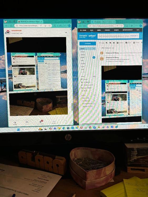

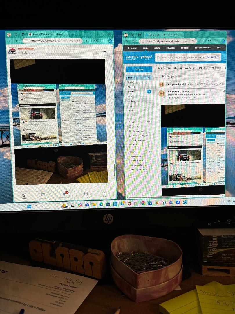

  On 10/17/2024 at 8:18 PM, hicrop10 said:
Yes I’m having problems with posting pictures Any help would be great.
Expand
send it to me, i can still post pics.
i will then add them to your post.
