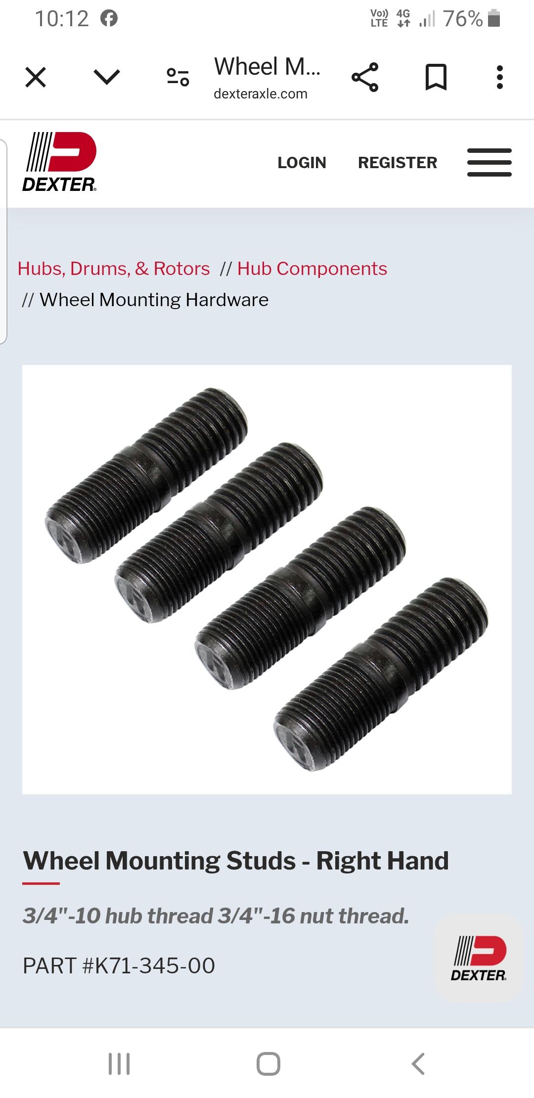

So in my language theats 3/4 UNF on on end and 3/4 UNC
Mack 58,000 lb back ends used these studs in their spiders, or at least they did in Australia
Wheel Mounting Studs - Right Hand | K71-345-00 | Dexter Axle Online Store https://search.app/2ZQQnD2s2rABNS4w5
Dunno if these are long enough or not ??
Paul
Wonder why they were made that way? Normal wheel studs (for spoke wheels) are course thread both ends. Normal studs for other purposes, the course thread is the stationary thread (on the end of the stud that stays put) and the fine thread is on the rotating (nut) end.
That is back-asswards.
Course thread resists being pulled out, fine thread provides more clamping force before failure.
axle drive studs, course in the hub, fine on the nut.
Edited by Geoff Weeks
I dunno why they are this way Geoff, but they are a pain in the ass some times when changing a flat tyre on the side of the road
44,000 lb back ends are normal, course thread each end, 58,000 lb fine in the spoke and course on the cleat
Stupid idea I always felt
Paul
