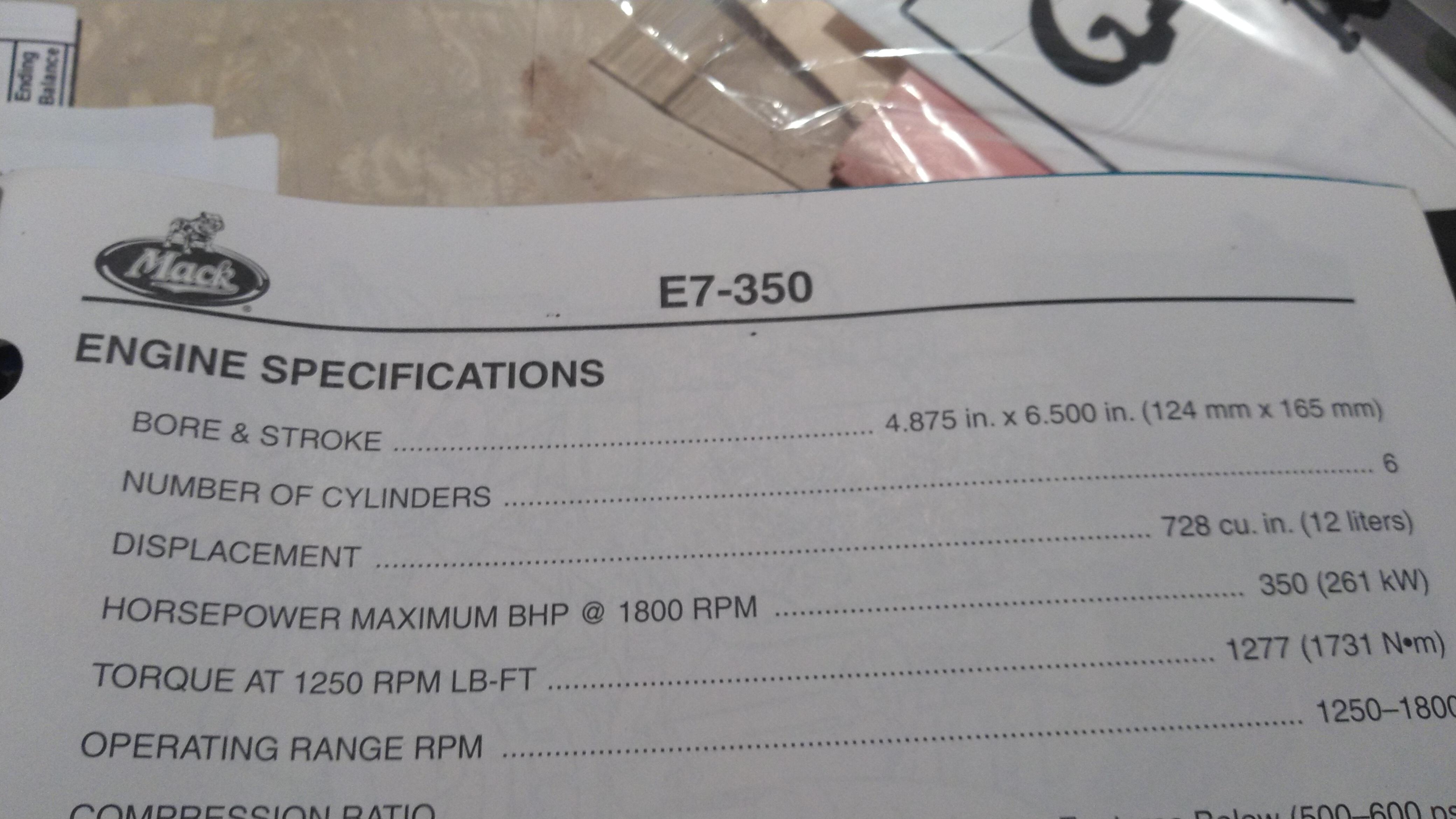

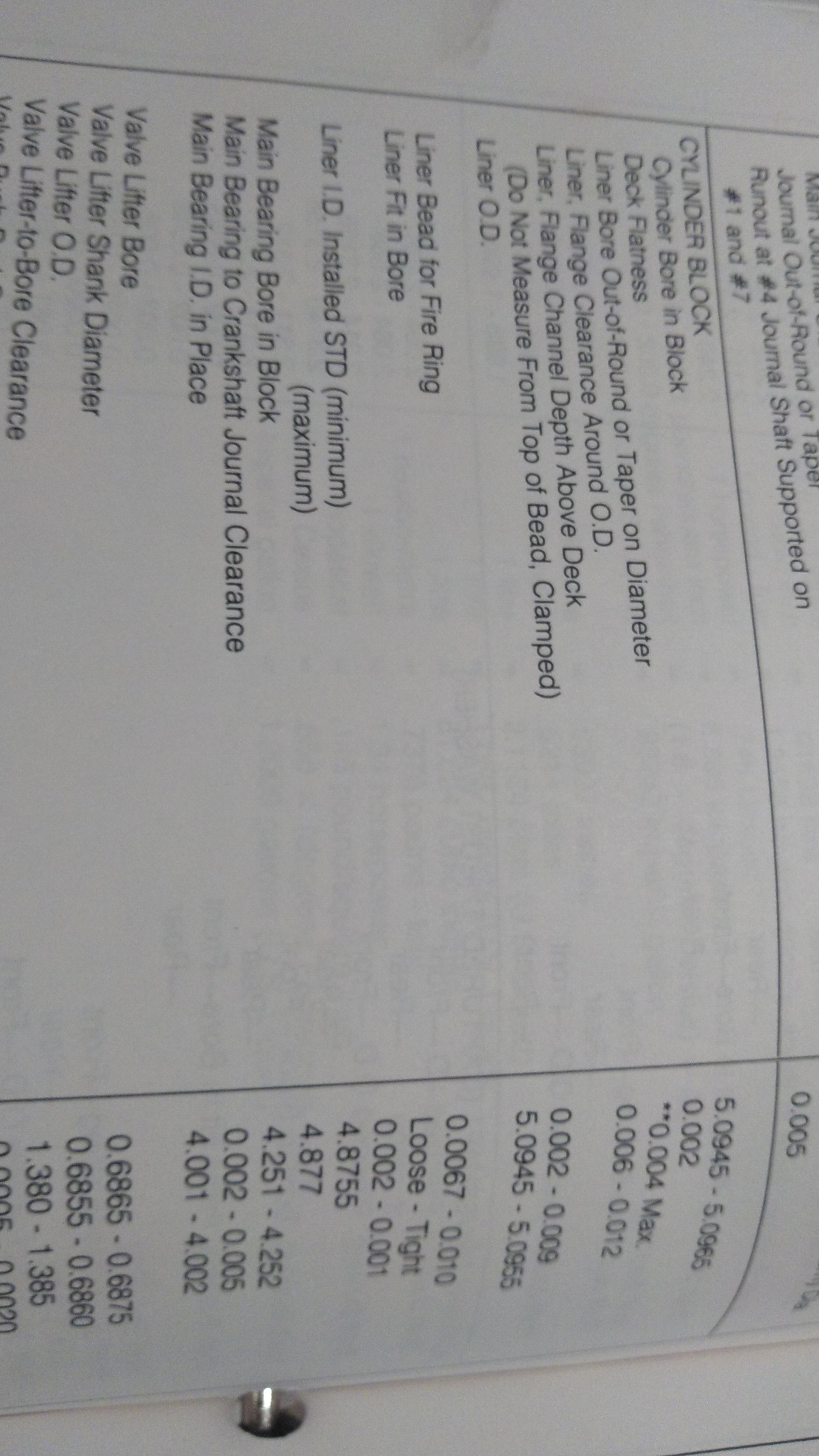

I wish I was smarter on these differences, but i think the liner protrusion is a different shape/style between E-6 and E-7.  the 4V heads have a fire ring groove to seal the fire ring to the top of the liner, that I beleive the E-6 (2V) doesnt have..  Man I wish I could just blurt it out like I can on an E-Tech..
here are 2 pics from my books,  E-6 + E-7  I was also thinking about bore diameter..
