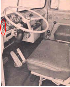

Do you have the toggle switch on the dash to flash the high beams?  If so, do they work when that switch is flipped?  IIRC, that same toggle will dim the lights if they are on high beam.  I THINK that switch energizes the high beam filament without going through the "tilt beam" switch.
Might help narrow it down pretty quickly to the dimmer switch.
Thanks tjc transport and Doubleclutchinweasel, I do have the dash toggle, didn't even cross my mind to try that. Will give that a shot....  before just replacing the switch then do a jumper test if needed...  Prefer to diagnose before firing the parts cannon, although the dimmer switch is pretty cheap ammo...😂
Thanks again guys....
High beams working with dash toggle, cleaned up pigtail and switch connections and working fine with switch now...😁
