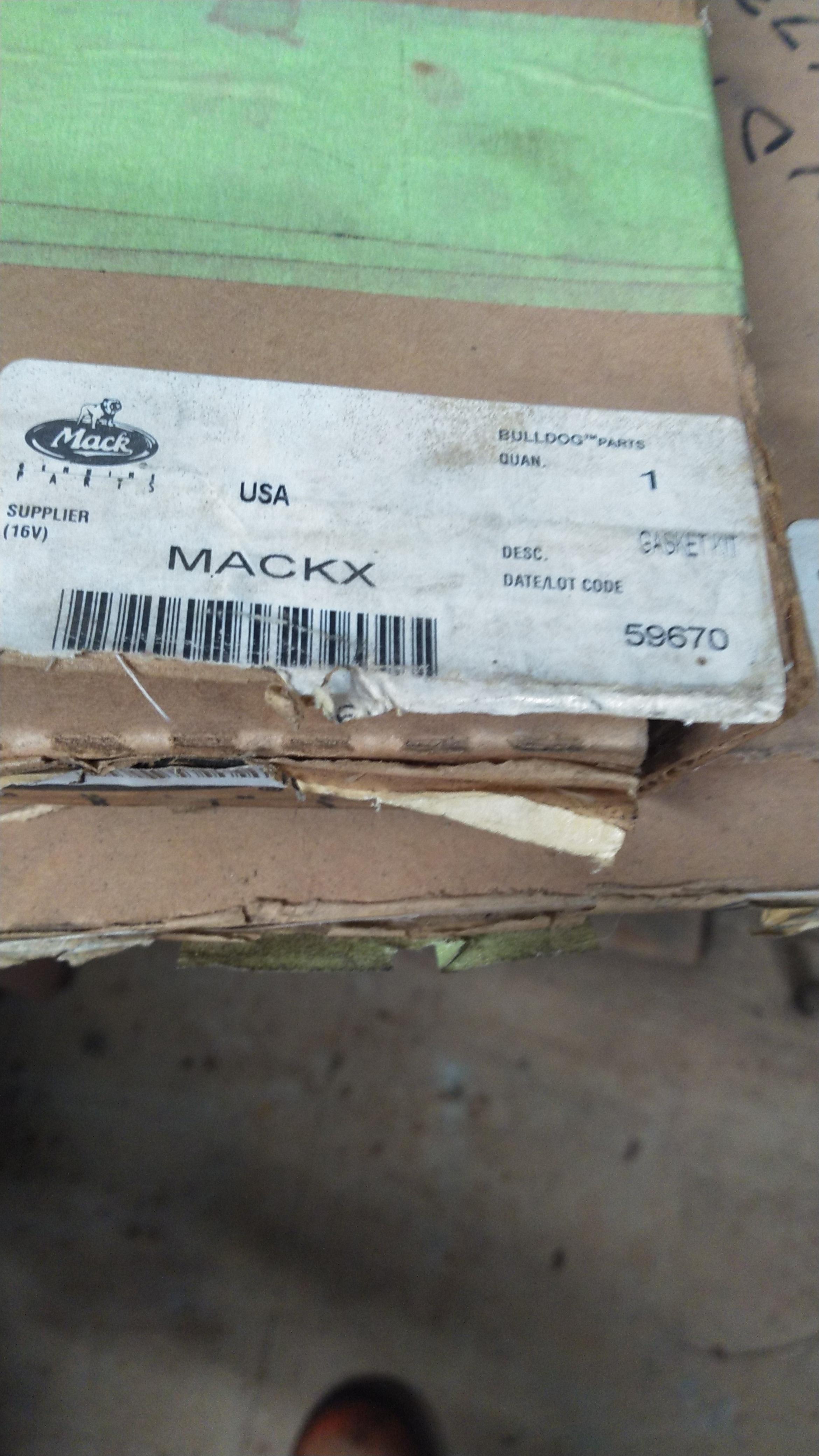

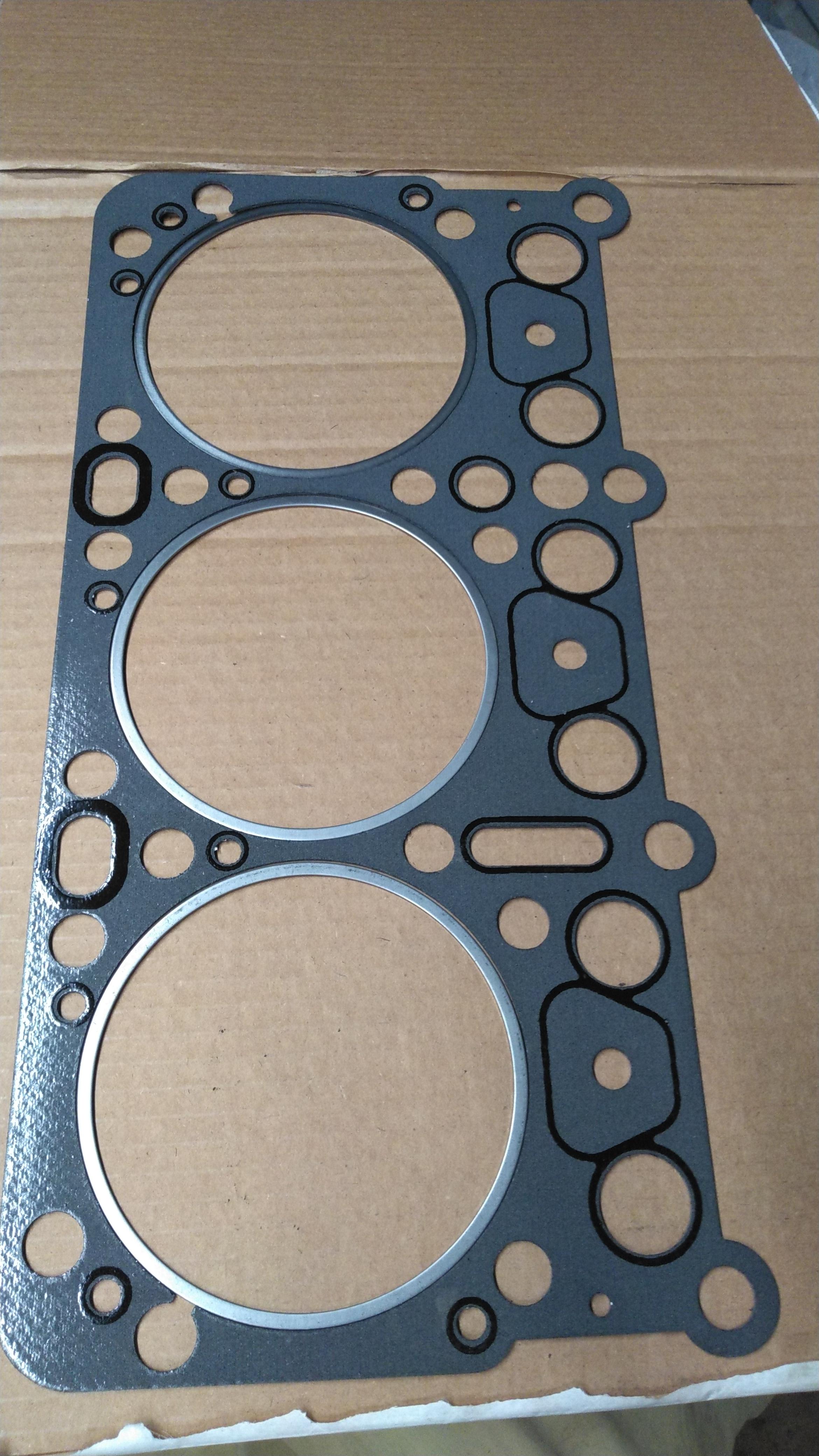

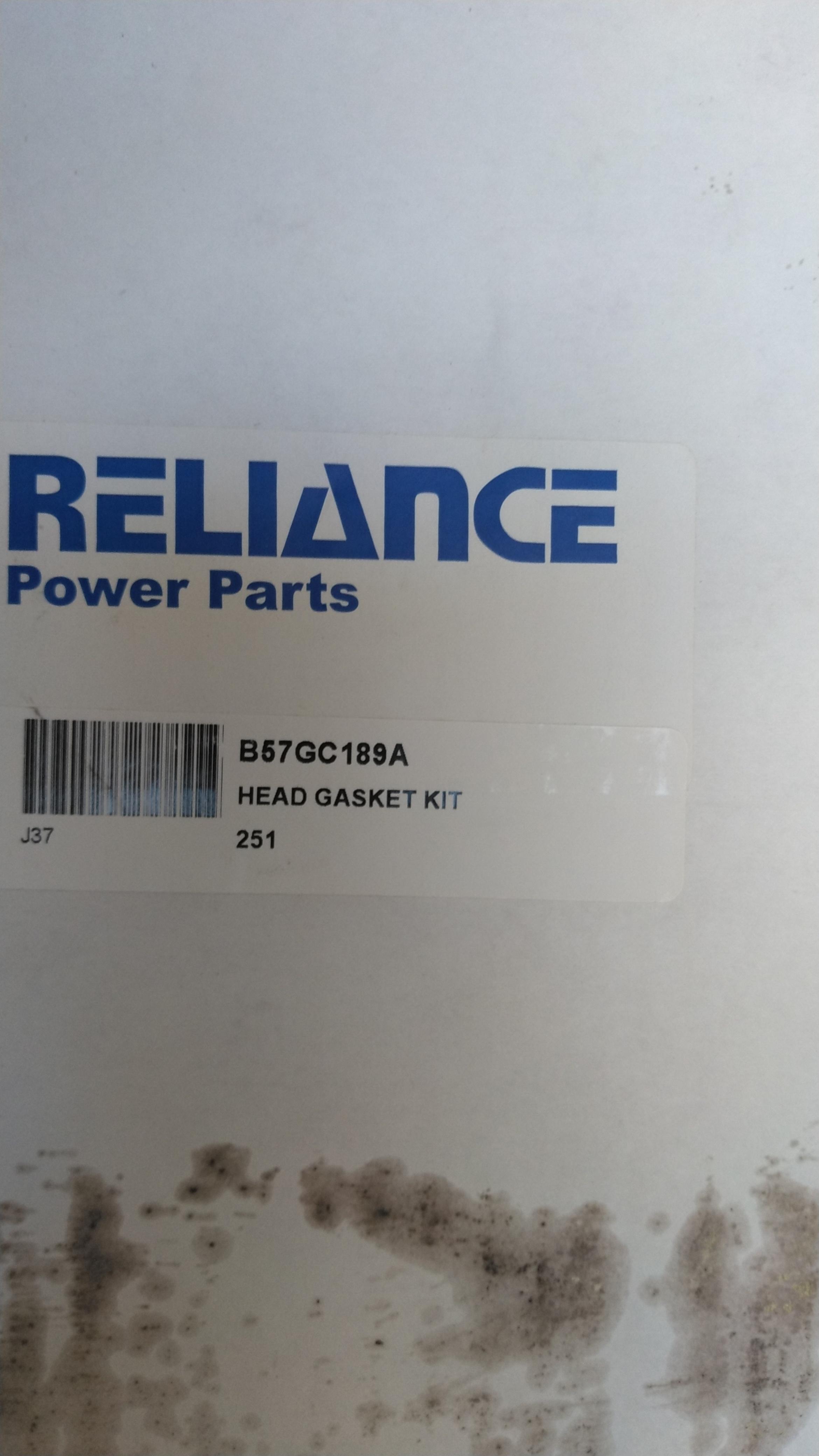

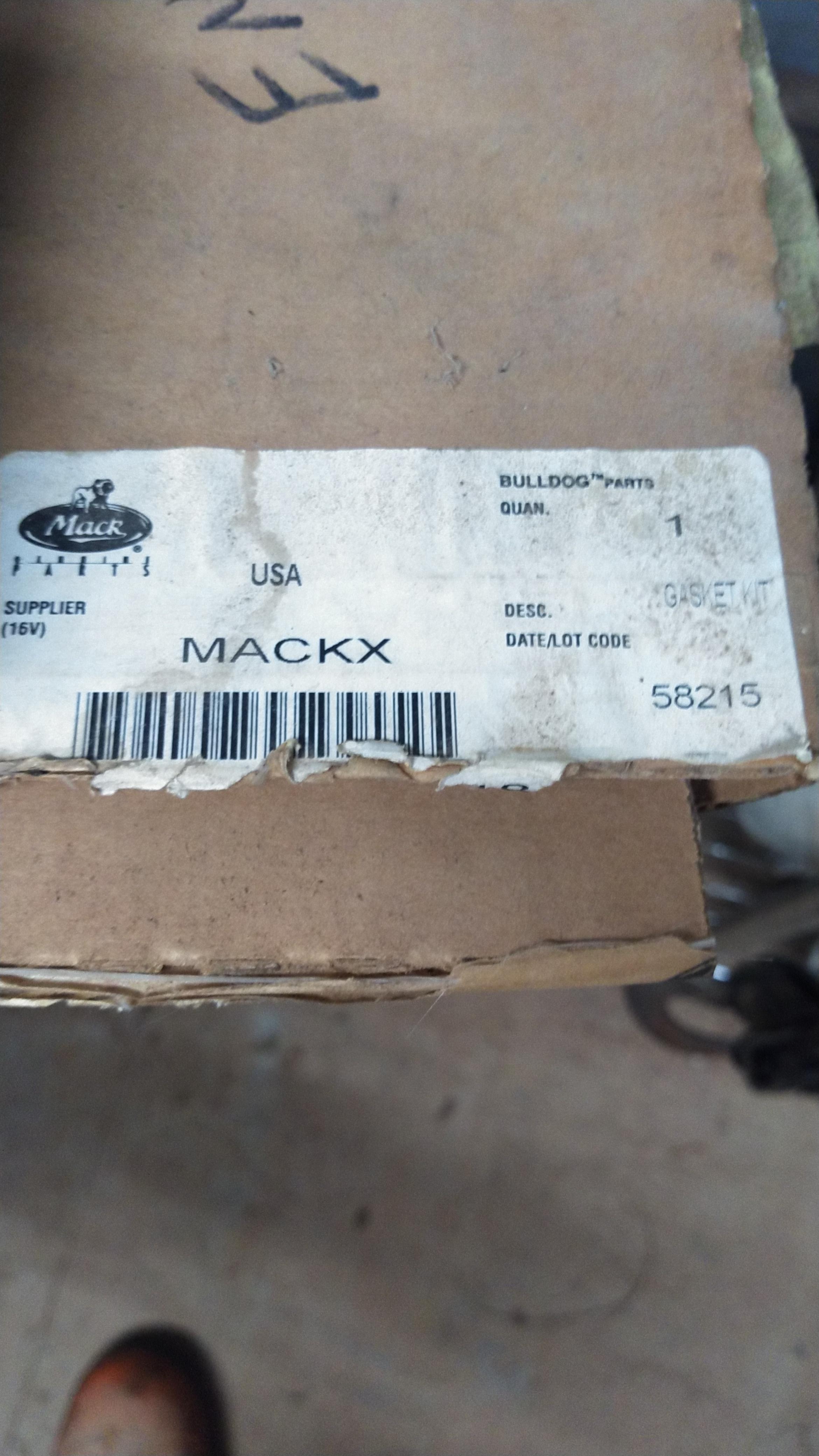

I have an ENDT 673 in my shop..  These are the gasket kit numbers to do a head job and full rebuild.  I hope they are the same ones you need..   ''PAI''  is your friend on this one..  Jojo
