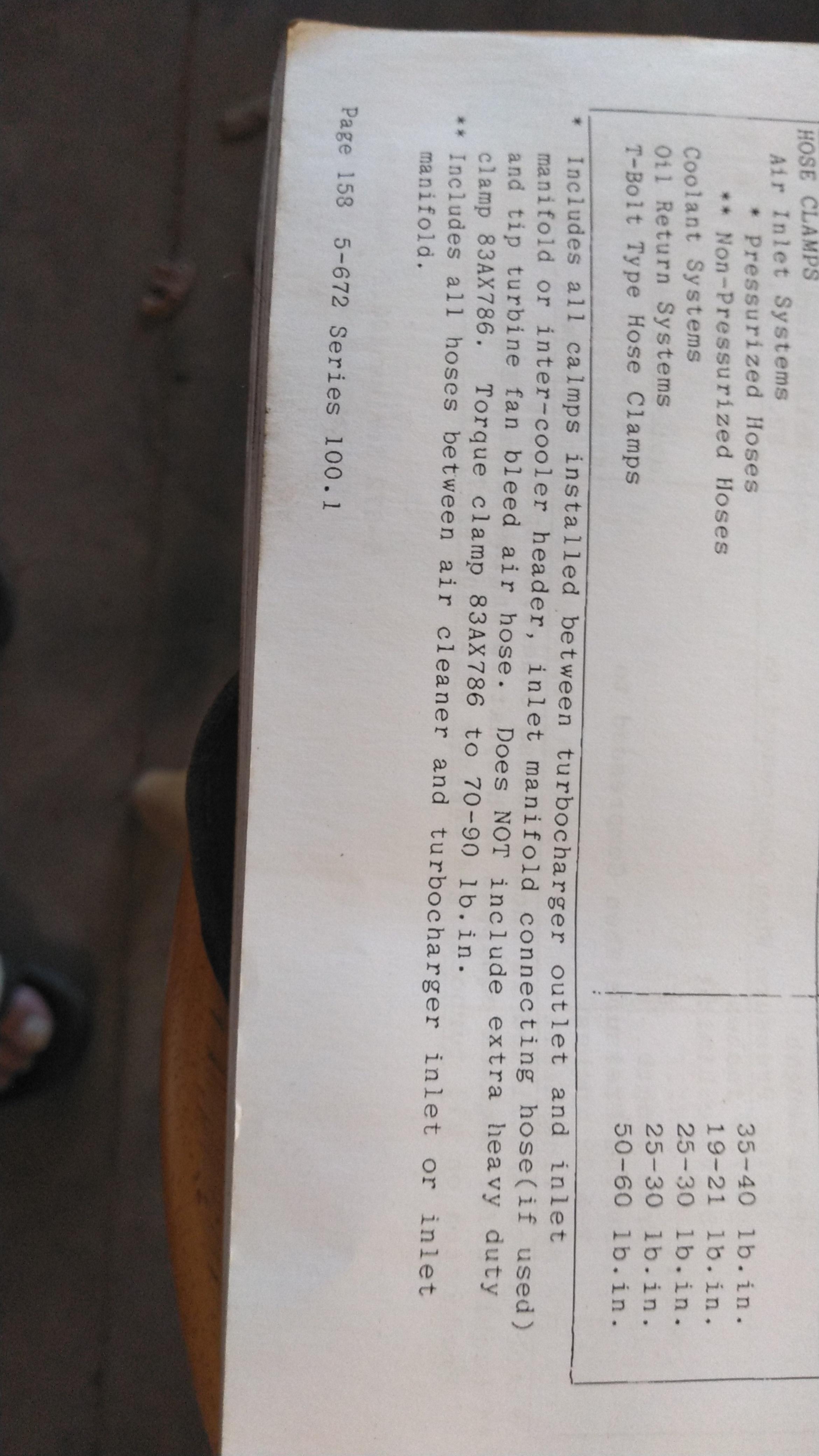

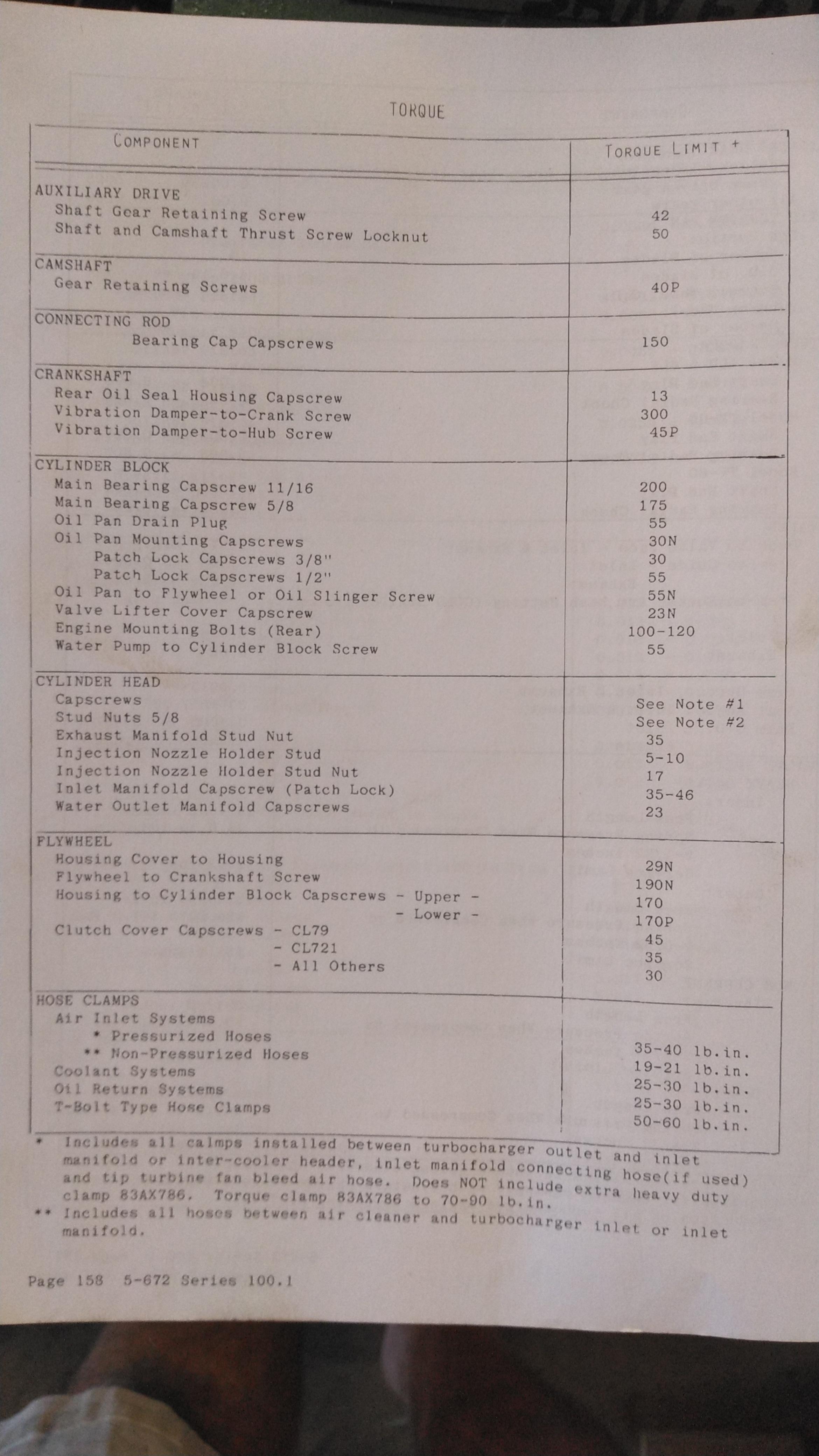

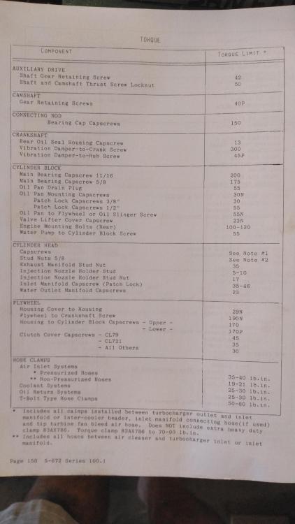

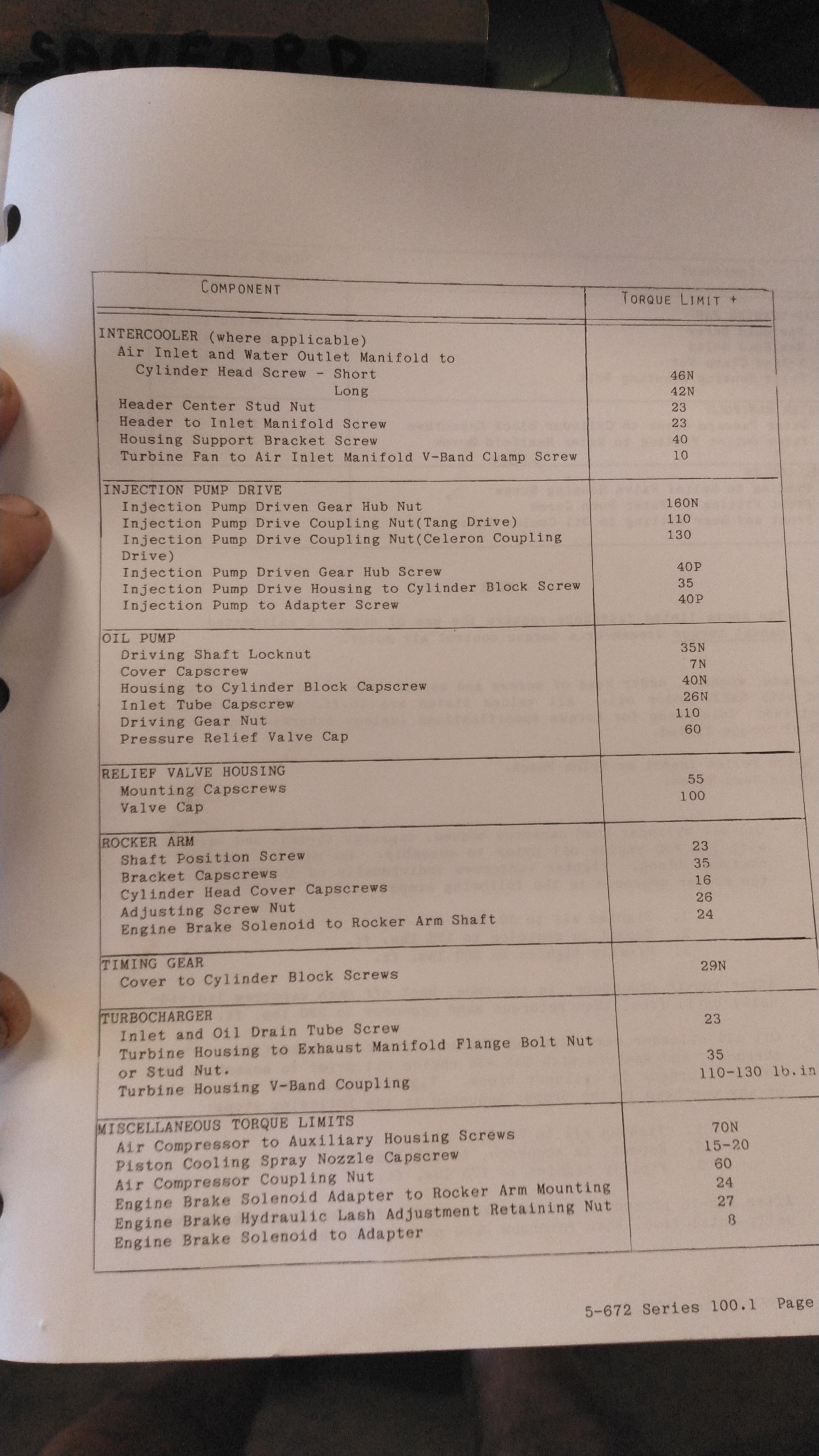

Have gotten my bottom end parts in so I get to start putting that back together.  My shop manual that came with the truck only shows torques for head bolts (175), exhaust studs (35), intake manifold (33-37) & injector nozzle stud nut (16-18).  Can't seem to find the connecting rod, pan bolts, water manifoild, rocker cover bolts & turbo mounting bolt torques.  Any info in this area is greatly appreciated

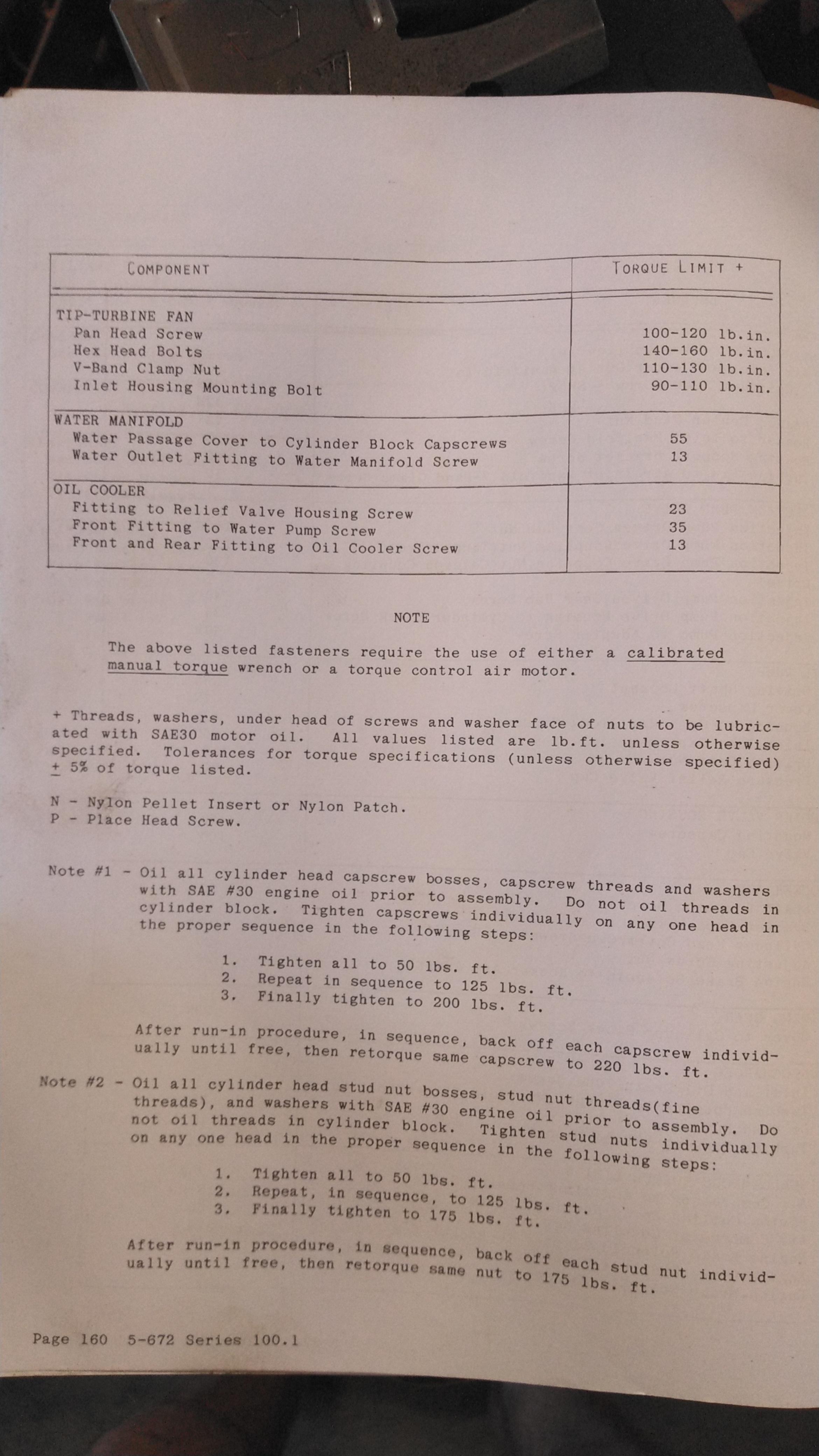

As far as torque specs.. I have an E-6 book.  I will see what it says and post pictures.. It will be after 4 pm, est.   Jojo
I would very much appreciate that.  Also any words of wisdom you can share as far as anything I should do or be on the look out for as I reassemble this engine.  I will definitely be chasing all threads and bolt holes so I get accurate torque readings

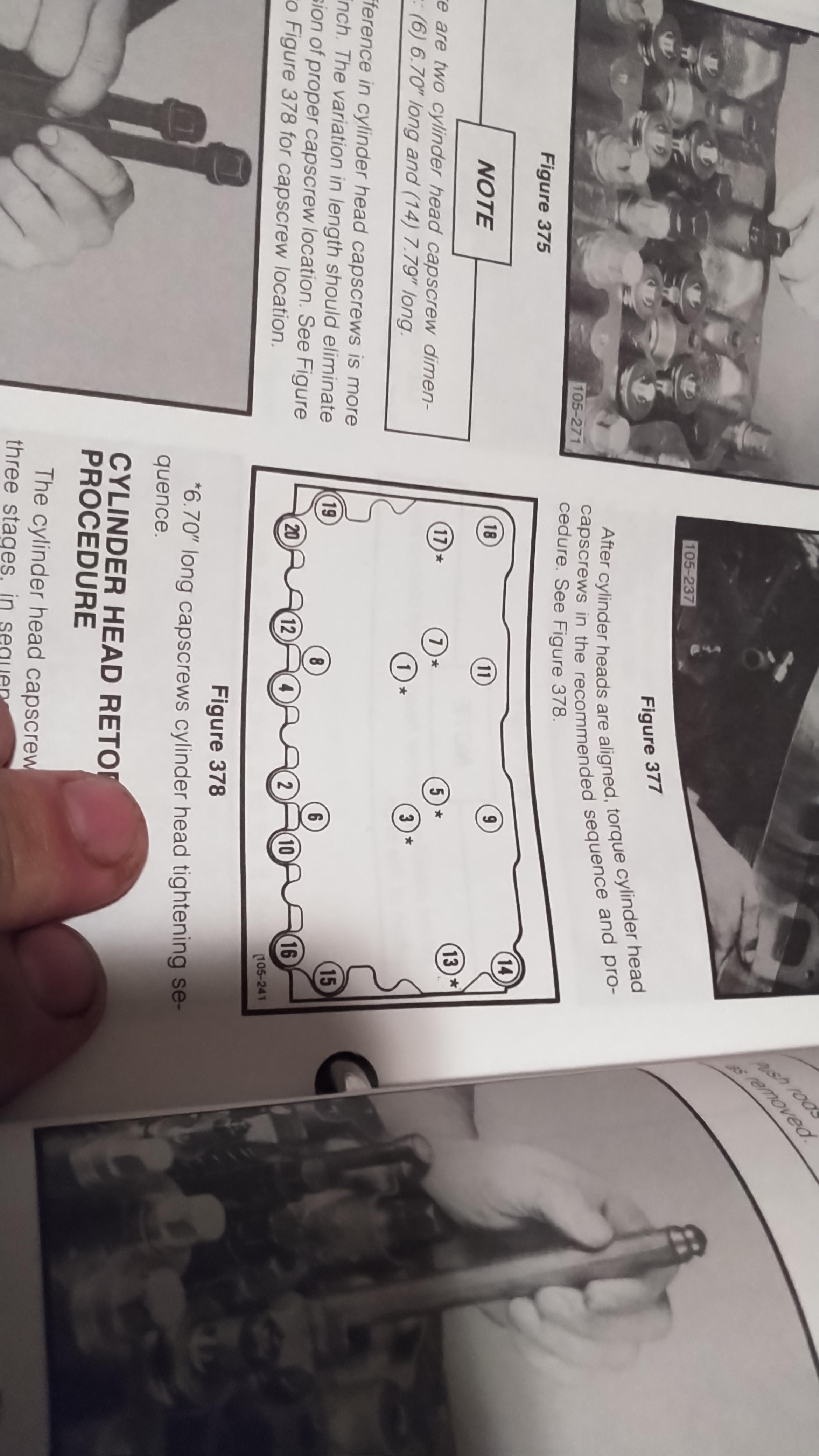

yes... for the head??  it is a cross pattern starting in the middle and working outward..   3 rounds of torque settings
