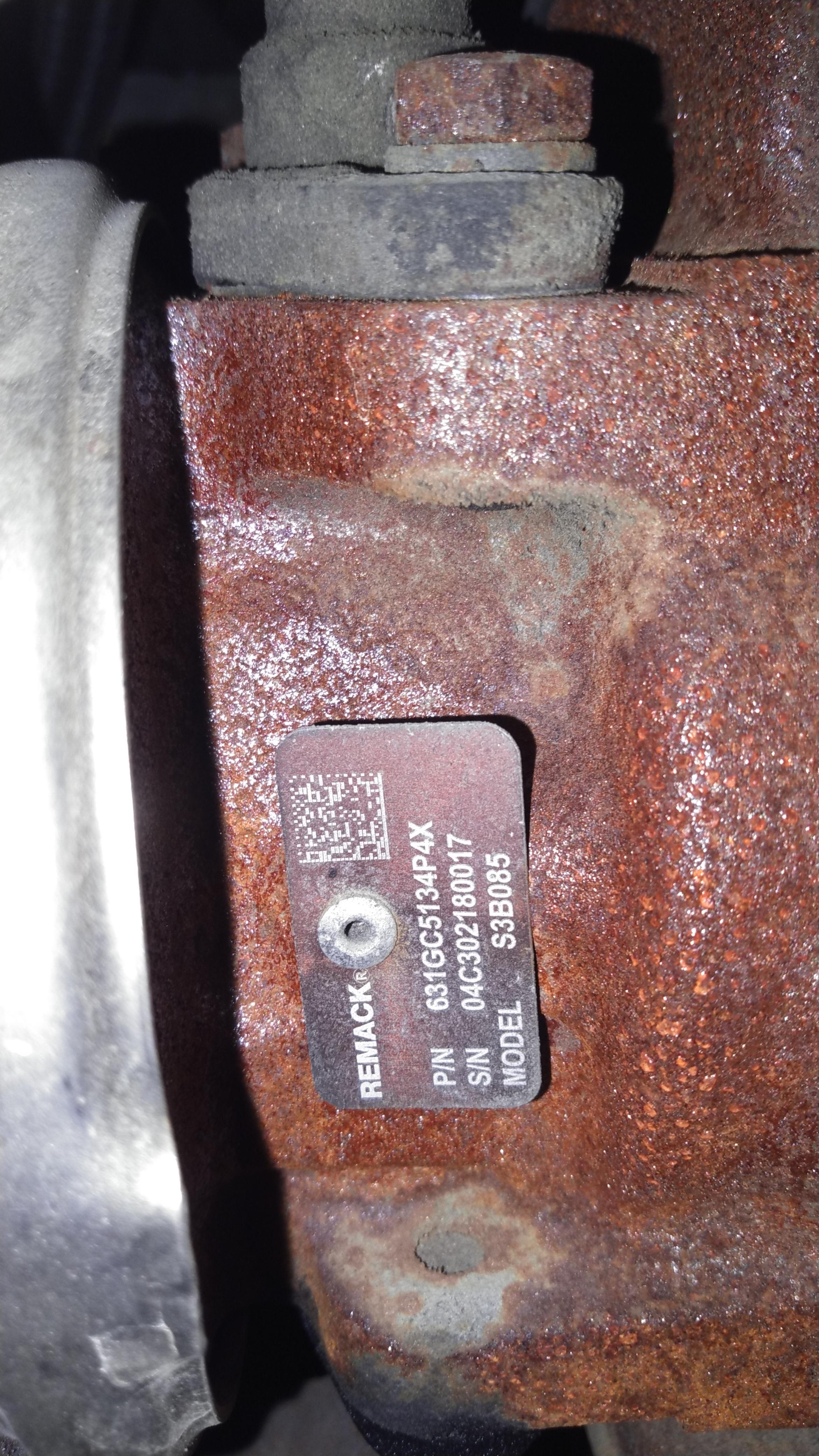

I did get my truck running, but locating a rebuilt turbo is getting impossible.  Does any of you guys hjave a source to try or a source for a seal kit for this 4LE-303 turbo.  This one leaks oil out the exhaust side
Can anybody tell me what the difference is between the 4LE-303 and the 4LE-292 or 4LE-556.  The pictures I am seeing they look similar
Edited by RS Disposal
additional question added
Sorry to confuse you with yet another turbo model added to the possibilities. Just rechecked, you're running an ENDTB 675 which will be the 237hp variant! Sorry this turbo is for the 283hp variant!
I do have a 237 endt-675 sitting outside my garage, I'll see if it has a tag on it tomorrow!
