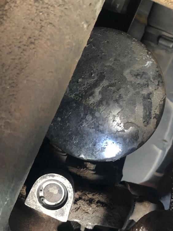

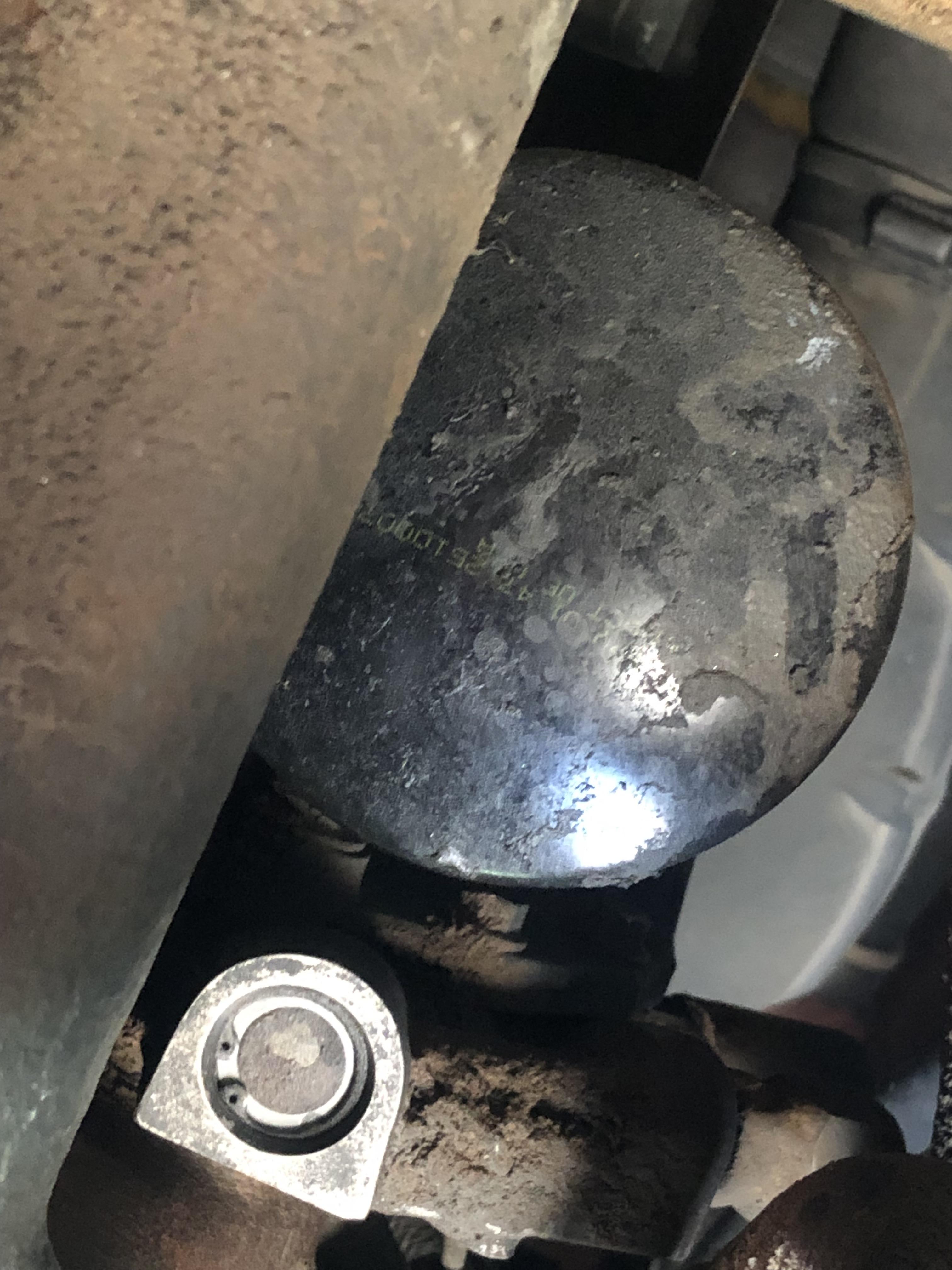

Thanks, will post pic’s shortly. I saw the Dorman pump , but concerned about reliability of the product ? My drip is at the bottom of pump / appears to be a round puck held in by internal snap ring . Hopefully has an o-ring that can be replaced ?
That originally had a filter bowl attached and was deleted due to the awkward nature of its placement! You could try replacing the oring!

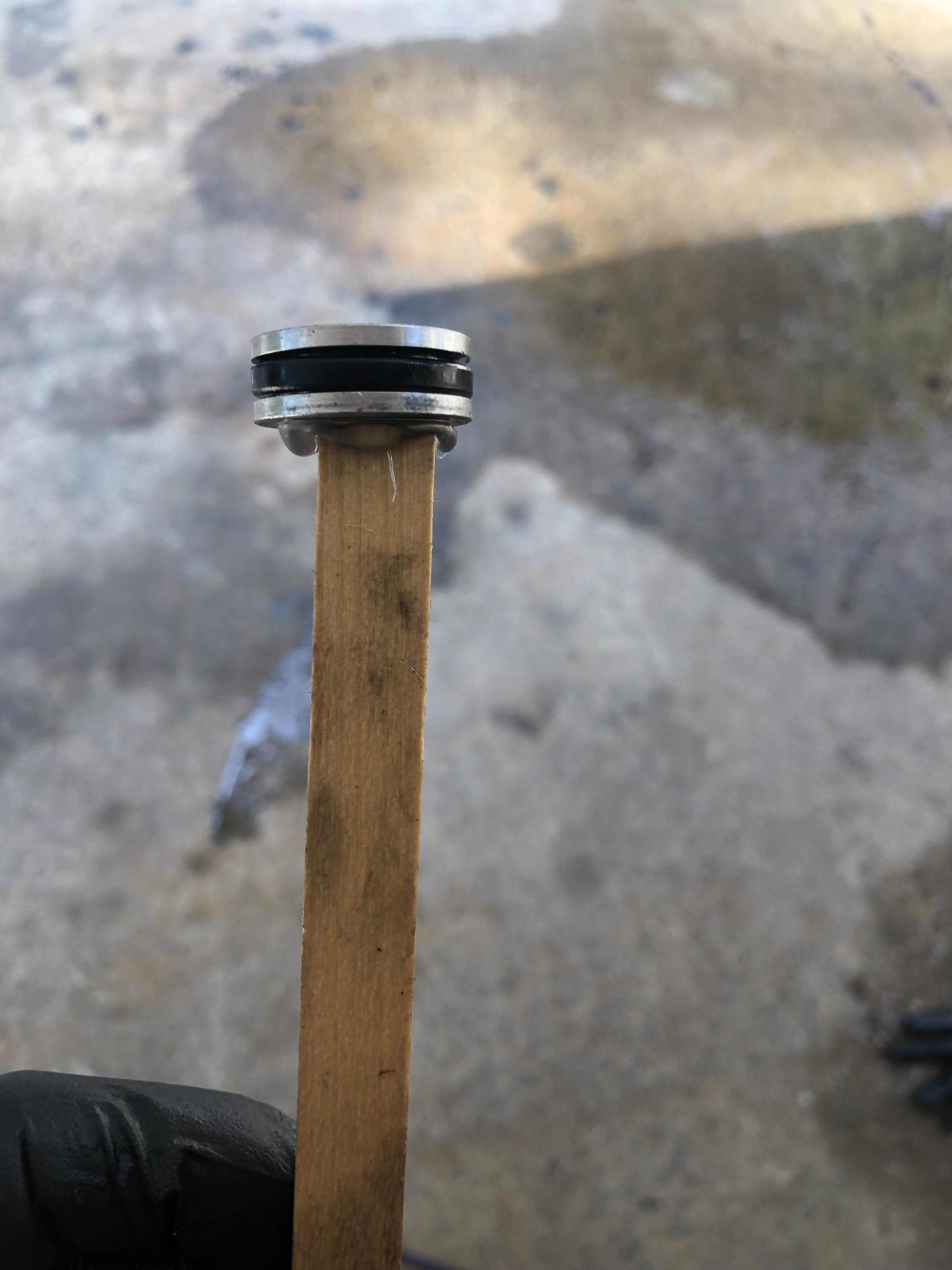

Thanks for everyone’s help ! Not knowing if removing the snap ring would allow parts ( springs or check balls ) to fly out  ? After some hot glue on a stick I was able to remove  the plug and replace O ring  . No more leaking ! THANKS !
