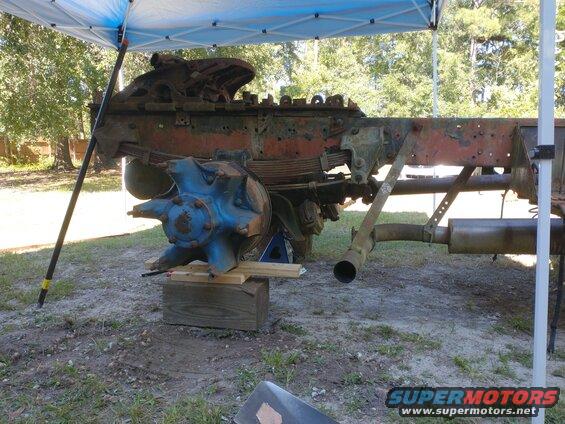

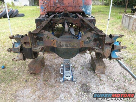

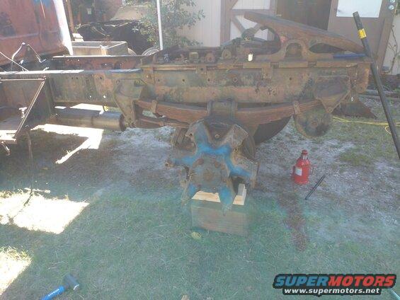

Little bit of progress from today, rain rolled in around noon and really slowed everything down.
Started off removing the air tank which I think was holding more water and sludge than air.  Probably going to write off the old one and order a new air tank.
From that pic is is fairly easy to see just how bent that rear crossmember is, so tomorrow I will be hitting up a metal yard to find a piece of C channel to replace it.
Starting busting the U-bolts loose and that is not a fun process.  Had a 10ft piece of pipe on my breaker bar and some were still putting up a fight.  Didn't get through all of them today but I should finish up tomorrow.
Put the girlfriend to work pulling the air lines and first thing she did was snap a fitting off in the quick release valve.  Rather than fighting that thing I'll add a new one to the parts list.
