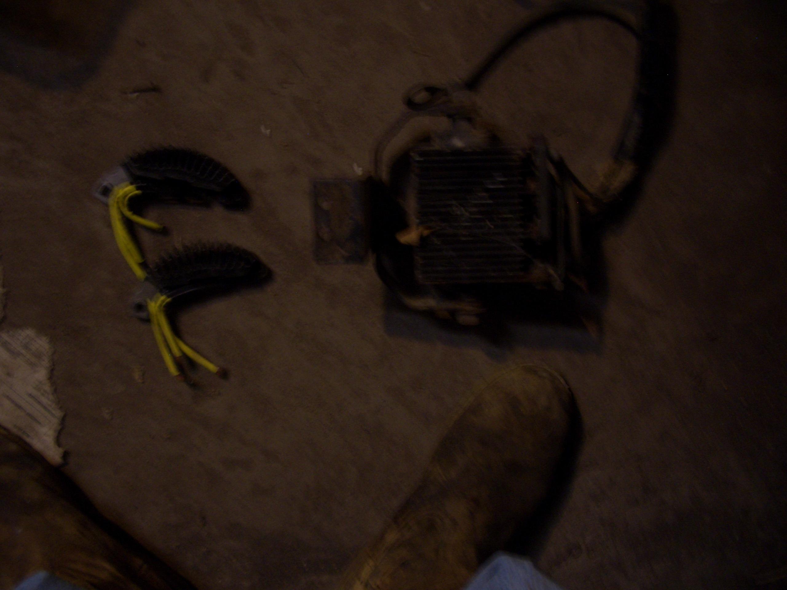

I'd just grab some diode blocks out of a Leece Neville JB2600 or JB 2800 and then the hard part, you need to assure airflow over them and they must be isolated from any other metal, and protected from wrenches etc.
 None of the silicon diodes used in modern alternators have anywhere near the surface area on the heat sink that the one you are replacing. Granted they can take the heat a little better.

Paul while I agree with you about lock ring wheel (I still use them, both on my antiques and up until I retired, on my linehaul stuff). I think the selenium rectifiers have plenty of drawback besides the toxic failure mode. They have a short lifespan compared to modern stuff, and for the most part any you find today are going to be at least 60 years old. At 12 volts you are running close to the limit for what one plate can safely handle in terms of PIV.
 As i mentioned before diode blocks out of a JB 2600 or JB 2800 would be fine. The spec's have already been taken care of for you as has the heat sink.  The Leece Neville JB series  today starts out at around 100 amps and goes well over 200. Initially they were made as low as 60 amps, but I haven't seen on of those in decades.
 I've included a photo of the Selenium rectifier and the JB blocks so you can get an idea of size. They would fit the bill, are nowhere near their limits (same blocks used on 24 volt and higher alternators) The black "kidney" shaped objects are the diode blocks.

this set is used in 130 amp Leece Neville alternators.  Because of how the mount in the case in the alternator they were designed for, there is very little heat transfer to the case, so that makes them more ideal for a retro-fit where they will not be bolted to an aluminum case and have a lot of cooling are drawn over them.
