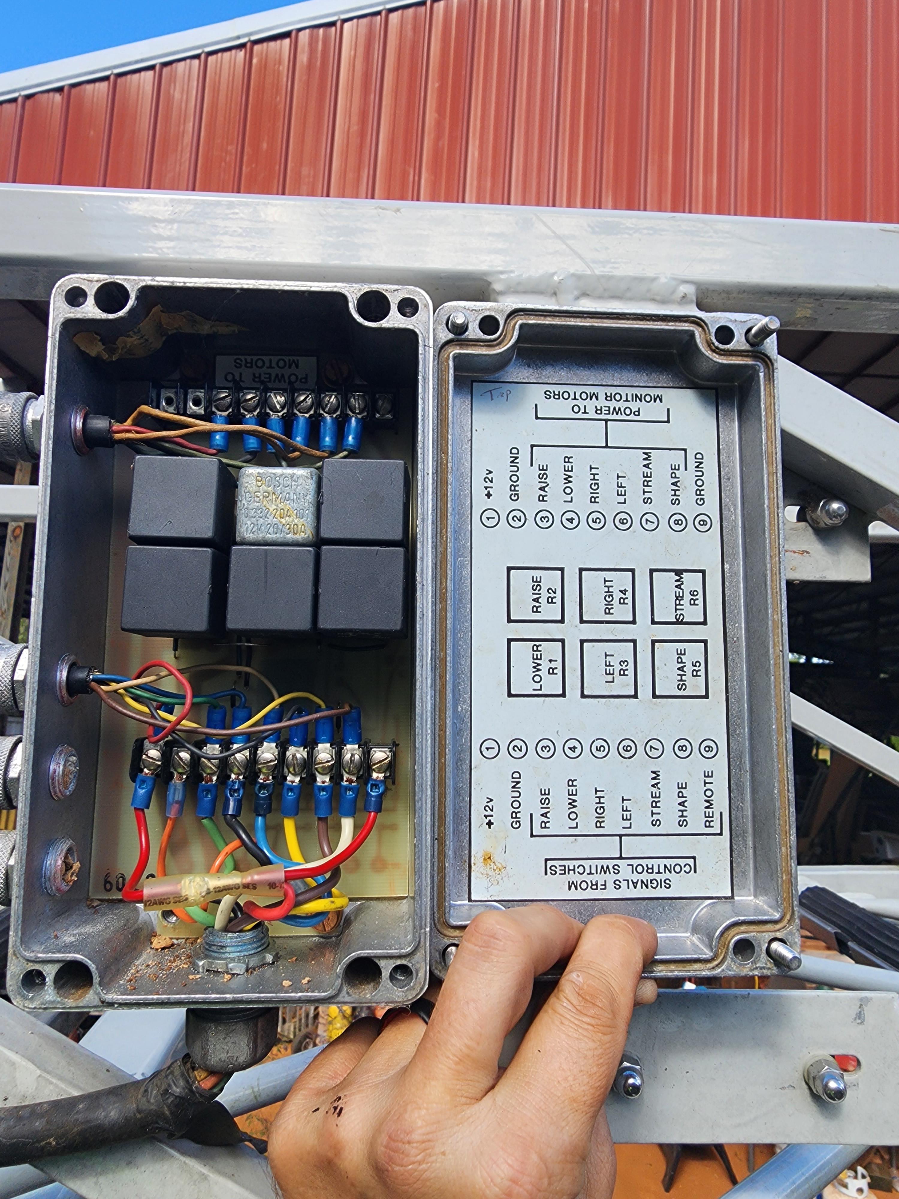

it looks like its missing something on the front of the ladder next to the monitor, and there is a cut cable near the base that goes to the front of the ladder..
Edit:  I'm fairly certain the cut cable is for the monitor controls from the base to the ladder top.

We did some more testing and work today on the truck and was able to verify that the monitor gun motors, relays and controls work from the end of the ladder by putting 12 volt at the top control box.  They do not work from the control point at the Base of the ladder..
The cable going down the ladder was cut off, so no power at all.
Some pics for the next person who searches for it.
