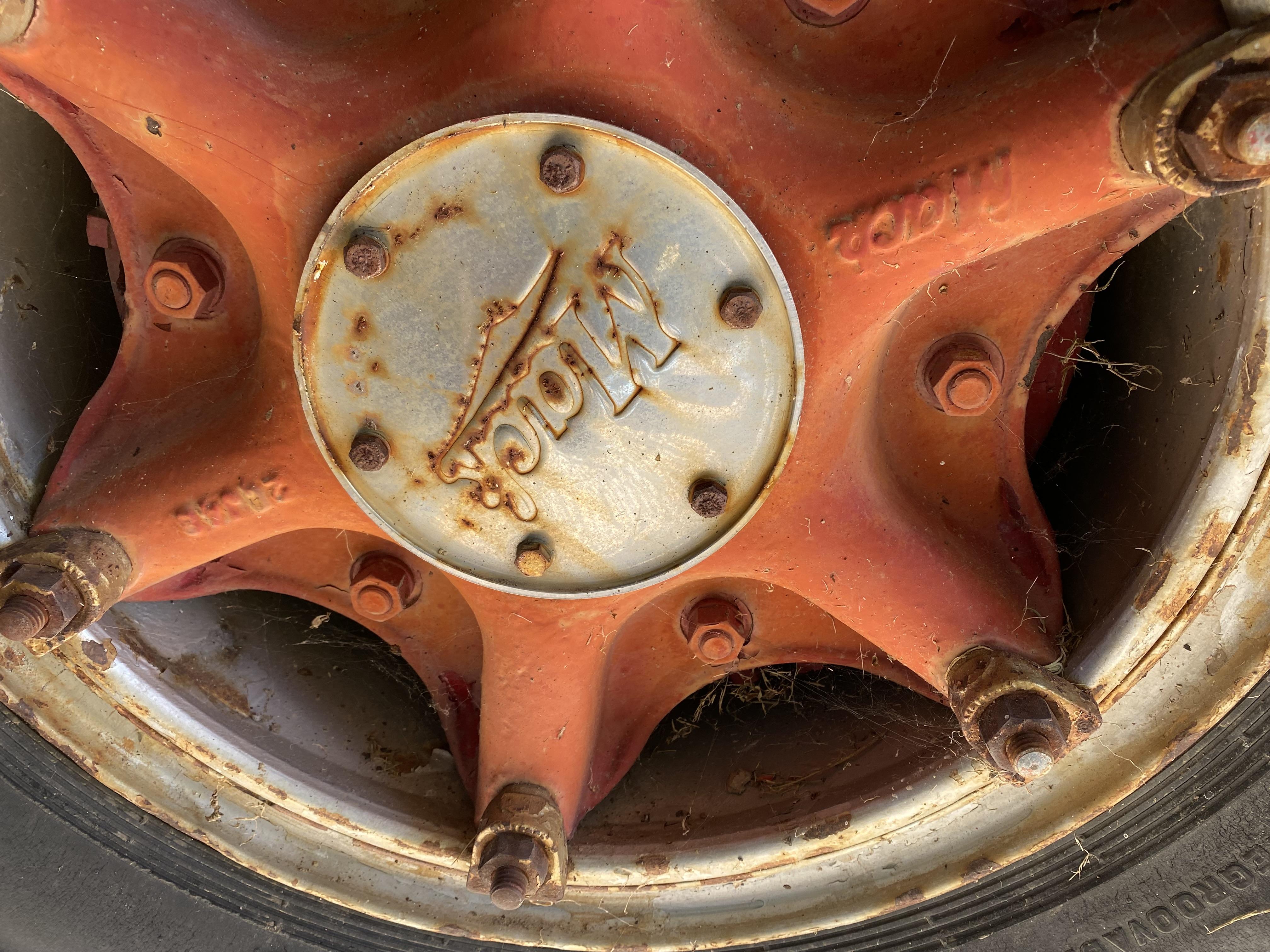

After looking at forum, obviously some things are difficult to locate. Such as picture below of a bearing hub cover - the twin to this one is missing. Are clutch parts still available? I have not deciphered Mack numbering, so other than a 5 speed bolted to the 707 engine I have little to go on. Thanks, Byron Long
https://www.bigmacktrucks.com/topic/73399-questions-on-parts-66-c95f/
The clutch is most likely a 16" twin disc Spicer. Yes parts are available, you just have to hunt a little. Any reputable clutch shop should be able to rebuild it. As for the hub, you have to keep your eyes out at the truck flea markets.
Thanks for the info. I do now have access to a similar CF that will be parted out due to its poor condition. Hopefully, between your input and the parts truck, I can get this rig moving under it’s own power.
