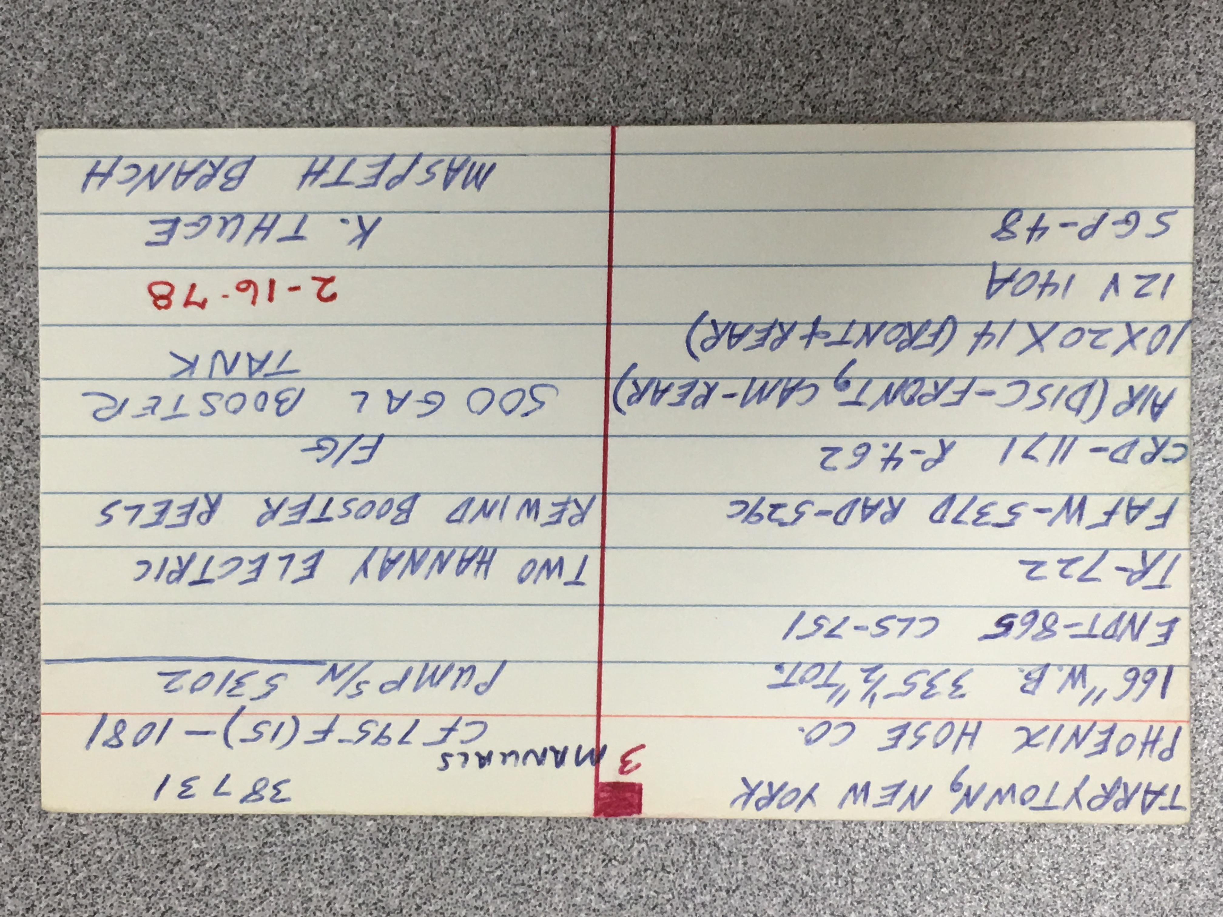

Mack was able to supply me with some information.
It was purchased new by Tarrytown NY as Engine 76(Phenix Hose Company 2) where it ran until sometime in the Late 90’s. It then was refurbished and sold to Shawnee Valley Fire Department in Schellsburg PA. It remained there until around 2010. At some point around 2010 it wound up at North Coffee Fire Department in Manchester Tennessee. It was first due until 2022. I purchased it directly from them while it was in service.
The paperwork from Mack states it was built as a manual trans truck. Sometime it was swapped to an Allison 5 speed and it all looks factory.

Thank you sir. She was advertised with a 1000 gallon poly tank, but the Mack build sheet shows a 500. Not sure where they would have hidden the extra 500 gallons without  major body changes. It is definitely poly and it does have a foam system poly tank.

with a Mack with a 1000gal .tank it would have a double compartment doors on the body & single doors (like yours) for a 500 gal tank ,hope that makes sense.
That's not the original tank, which would have been steel. Poly tanks were relatively unheard of back then and certainly not installed OEM by Mack.

Hmm, guess the only way to know for sure is to fill it up and time how long it takes to drain. In theory, one 1.75 inch line would last close to 10 min flowing if 1000 gallons. Half that if 500 to know for sure.

I was thinking along those lines.  Water is supposed to weigh about 8.33 pounds per gallon (at room temperature of 70° F).  If you have access to a scale, weigh it empty and full and see what the difference is.
Even allowing for minor differences in the weight of the water (based on actual temperature) and errors in weighing it, it should be pretty easy to tell if it's 500 gallons or 1,000 gallons.

Well, I got off Shift this morning and came home went out to look at the truck. I’m guessing they raised the hose bed. It’s only about 6” deep. The Poly Tank looks brand new.

I can tell you from looking at the pic as originally delivered compared to now, that the tank is not the original 500 gallon tank and is now larger. And I bet that the truck has no rust because when they modified the body to accommodate the larger tank, they probably did some cancer surgery at the same time.

On 10/18/2023 at 9:13 PM, GA_Dave said:
Look under the lid of the tank fill tower, they sometimes engrave the tank capacity there.
Good advice. I remember seeing on top of the tank a make and serial number. But didn’t look inside the lid.
