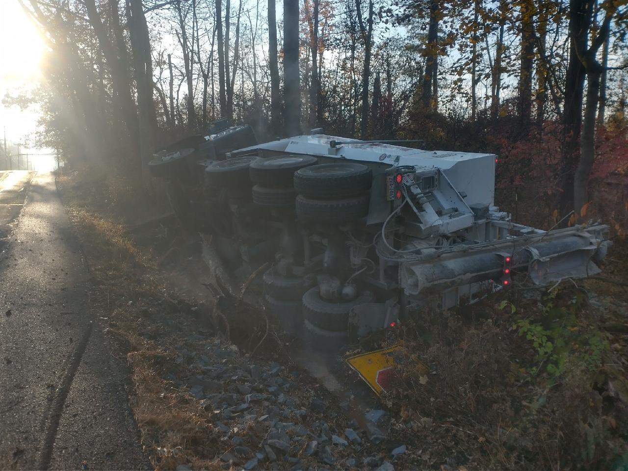

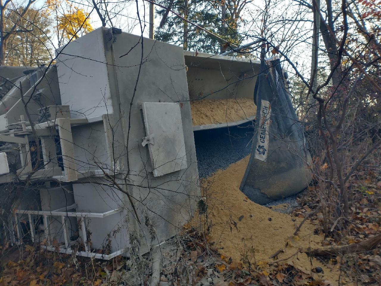

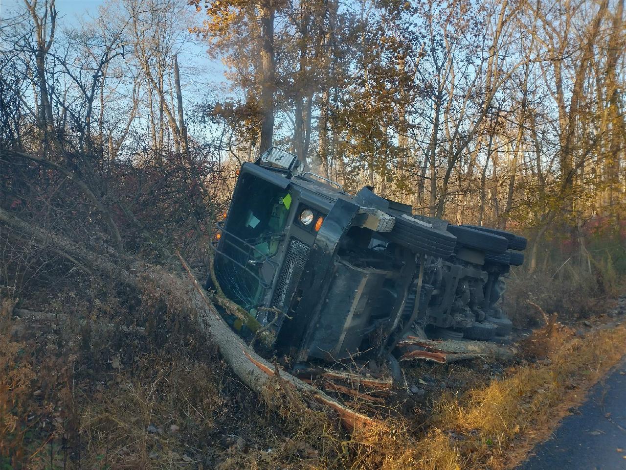

 So my driver did this about a week ago.
78148.thumb.jpeg.af612ffb0b22e73dc33ab2d510b22aba.jpeg78150.thumb.jpeg.0ee838af927059f54ed816a2e8a3acbe.jpeg
Fortunately no injuries.
Moving on.
Mixer body is in surprisingly good shape, shouldn't be much trouble getting that part back up to snuff.

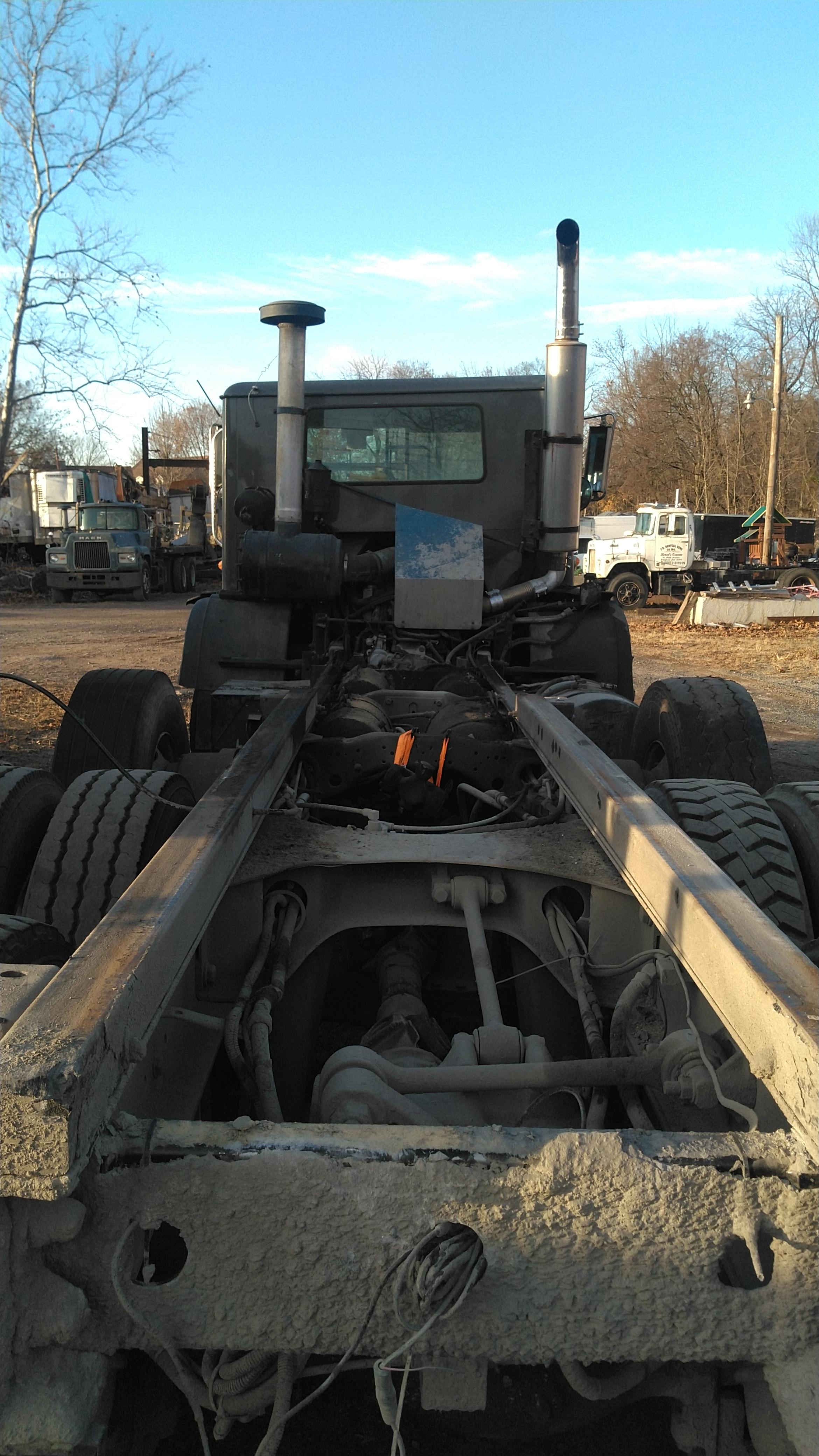

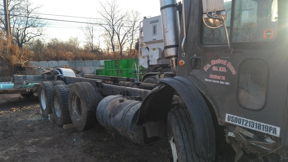

Cab took a beating. Insurance guy thinks the cab shoving back into the exhaust stand pipe tweaked the frame, he's claiming to see a couple "bumps" in the top flanges where the frame changes profile depth. I think the frame is fine, looks just how it did when we pulled the frame and sandblasted and painted it 2 years ago. Won't know for sure til we get a professional to look at it though.  Pretty sure insurance is going to separate the mixer and chassis and total the chassis. Which given that it's a 2003 with 27,000 hours and 435,000 miles, I get it.  But it did cost us a pretty penny to get this truck prepped for this mixer, far more than I suspect insurance will pay out.
Looking at a 2000 MR688 as either parts truck or replacement chassis.  The 2000 has a bad cam (I'm assuming rotated roller ate a lobe). 2000 is right side eecu, ETECH engine.
2003 is left side redesign eecu, ai350 engine.
What cross fit issues am I going to run into? Is there any difference in the chassis wiring harnesses that would hinder my ability to put the 2000 cab on the 2003?  This will be an ongoing thread for a while as we sort out this mess.  MR688S chassis on both of them I believe. Haven't seen the 2000 in person yet.

Havent dived into it yet.  No obvious damage to any wiring yet, and the engine did fire up momentarily so the tow truck could turn the steering wheel, but it starved for fuel and didn't run for more than a few seconds.
Driver side wiring appears ok, so does the passenger side. But the wiring runs up along the radiator grill and jumps into the cab right along the top of the charge air cooler.  I'm concerned the cab "bruised" the wiring harness at the top of the CAC from the passenger side hinge breaking and the cab shoving back against things.

@Joey Mack got the mixer body off on Black Friday, had my cousin Pete "The Crane Man" bring one of his cranes over to lift it off.
Insurance guy came to look at truck more than a week ago and he tried telling me the frame got tweaked. BS. There's not a thing wrong with this frame. He sounded like he was ready to total the chassis, but I told him we're not totalling anything til I get the mixer body off and get a truck collision guy over to look this thing over. I think I'm gonna get away very lucky, only needing a cab and miscellaneous hoses and brackets, tie rod & ends, maybe kingpins and drag link ends too, just to be safe. Axle shifted about 1/4 inch on the passenger side, so it could be into springs as well.
Just need to lock in on a decent parts truck and we can get this truck back together.
  • 0
On the frame he thought a couple of the places where the frame changes depth and also splays out around the engine/trans were kinks from the accident. He also thought the frame would be twisted,  which yea on a dump truck I'd expect that. But this mixer bolts rigid at the back, and mid and front mounts are spring-hold bolt mounts, which only allow about 2" of twist deviation from the mixer body, which has its own frame that adds rigidity to the truck.
